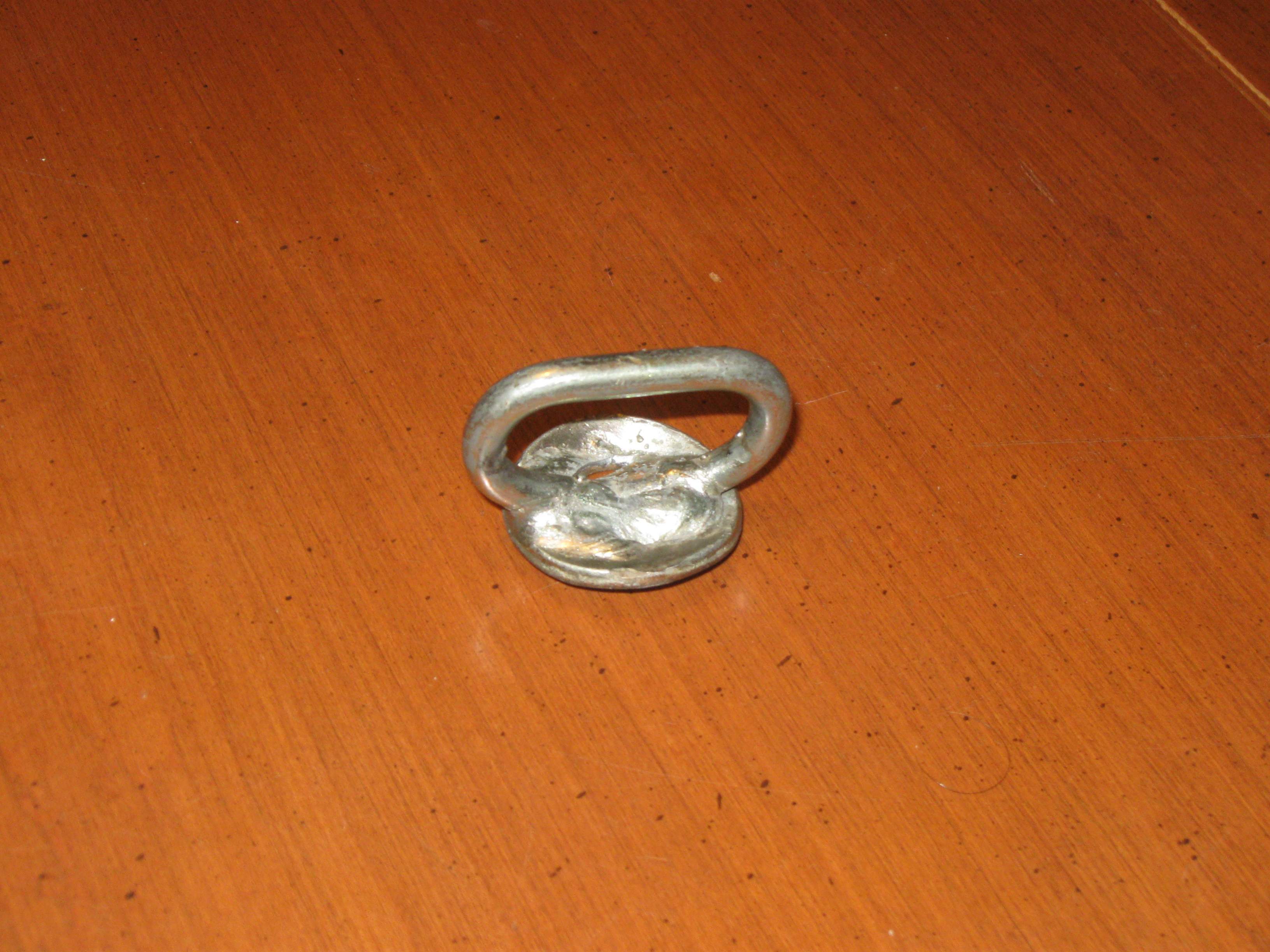

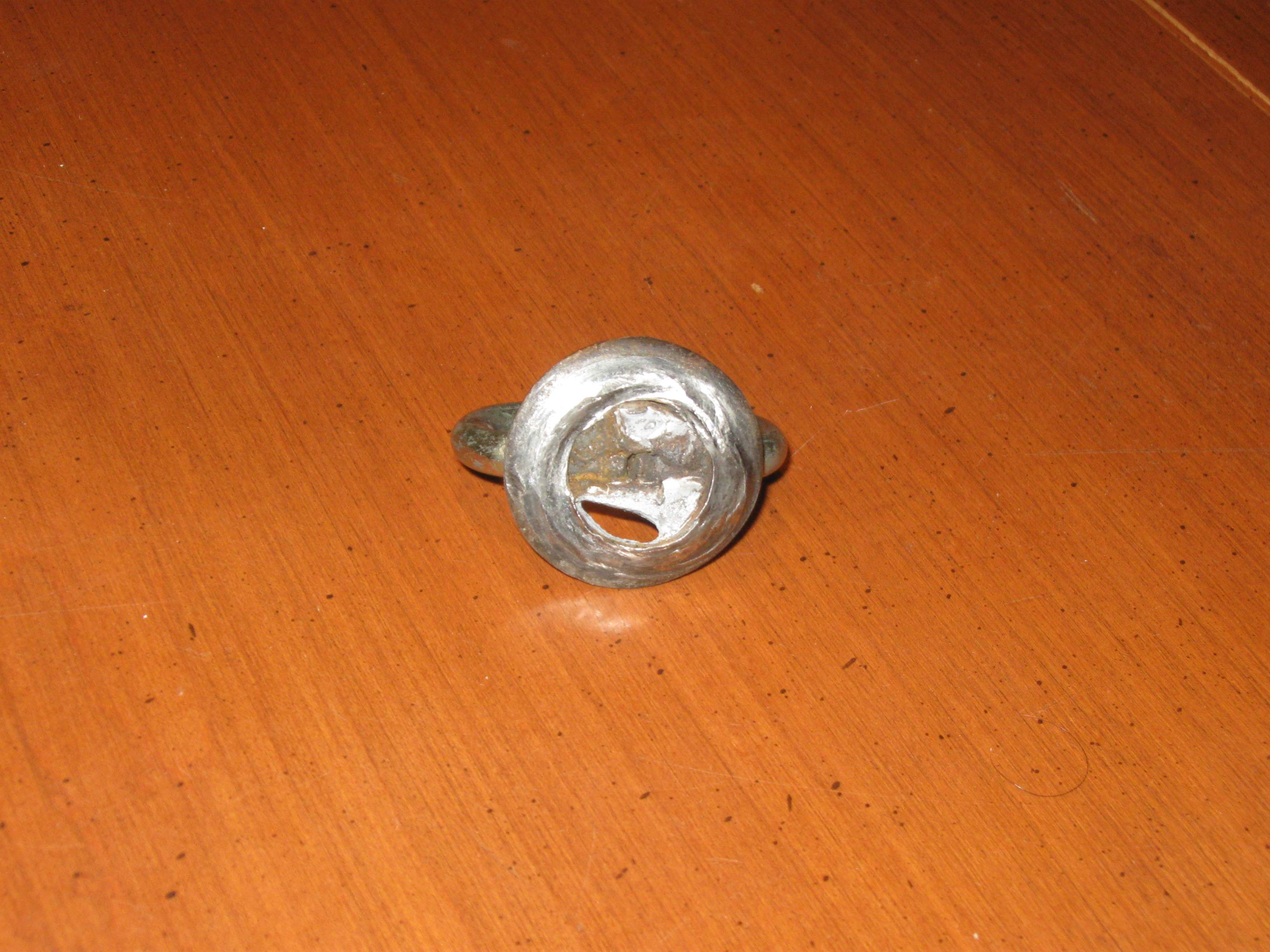

Put a good load on what you're towing, roll over a few hills and gullies (putting vertical pressure on the top of the hitch pin), and VOILA! One pin, one top, and, oh yeah, where did my trailed mower go???

Made in India I'm sure. Not doubt the guy was using both feet and all his toes to hold this together while he was welding it. The welders on this forum will be able to tell you why it failed.

Can't remember where I got it or where it was made. I just know that most decent hitch pins don't have a washer and a link of chain crappily welded to the top of the pin. Been there, done that, won't do it again.

The pins were welded the Orange County Choppers way, close your eyes & weld away. Probably done by without a good welder, quality rod/wire, eye protection, or any training what so ever by someone earning 50 cents per thousand. MikeD74T

Yeah, you can clearly see a corroded section in that second photo that had been cracked or cracking for quite a while prior to the failure - as you said, lousy weld job.

They've been making pins that way for 35-40 years that I know of. I was pulling a 12' disc with my grandfather' 60 John Deere down a 2 lane highway in road gear and the pin broke like that just as I got to a bridge. The hydraulic hoses kept it straight enough I didn't hit the bridge bannisters but it was certainly exciting. Got off and found the hitch pin and got hooked back up with the pin upside down hanging from the hairpin and made it the rest of the way to the other farm. Glad there wasn't any traffic! We tossed a few other pins like that after that experience.
