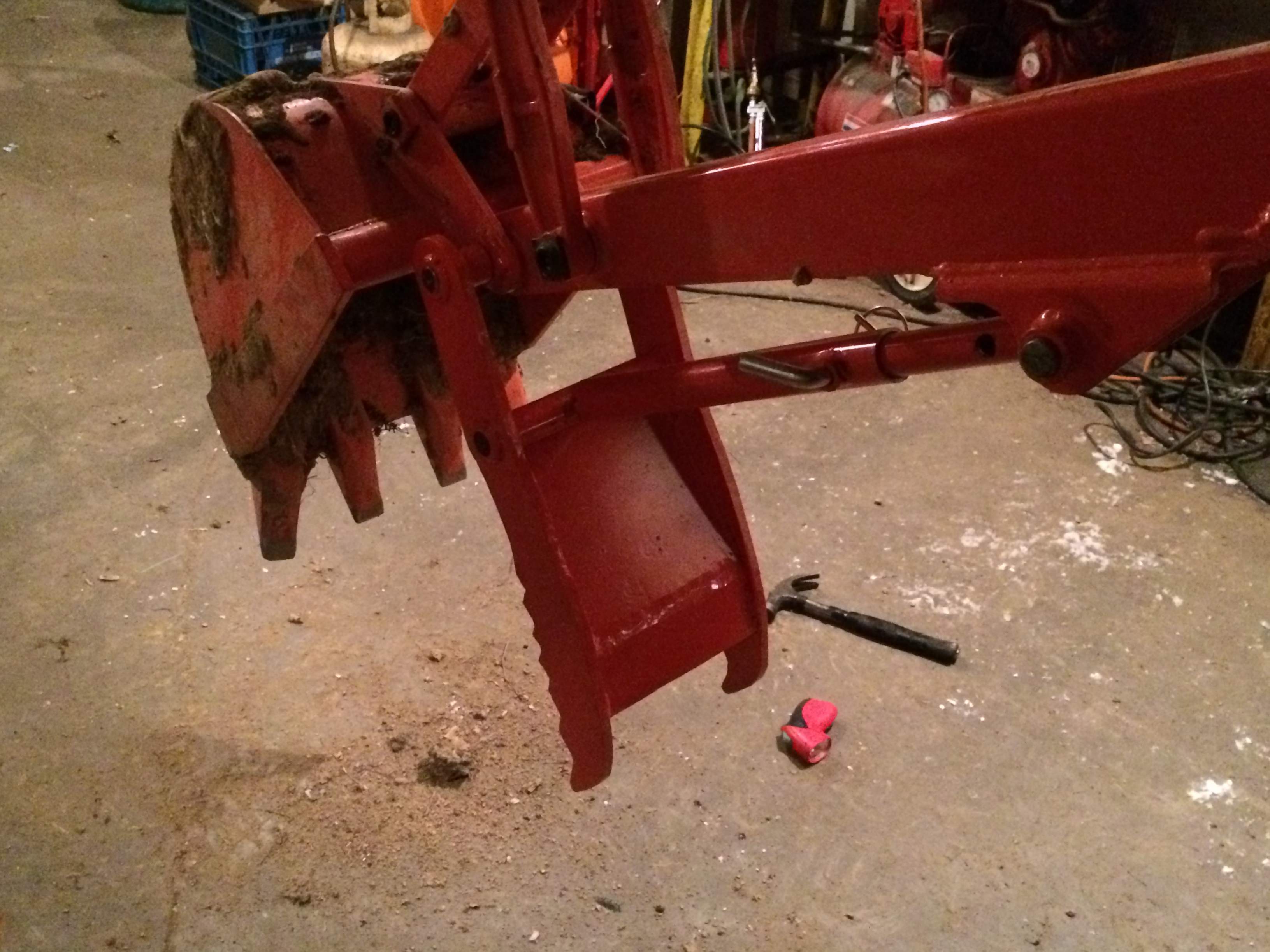

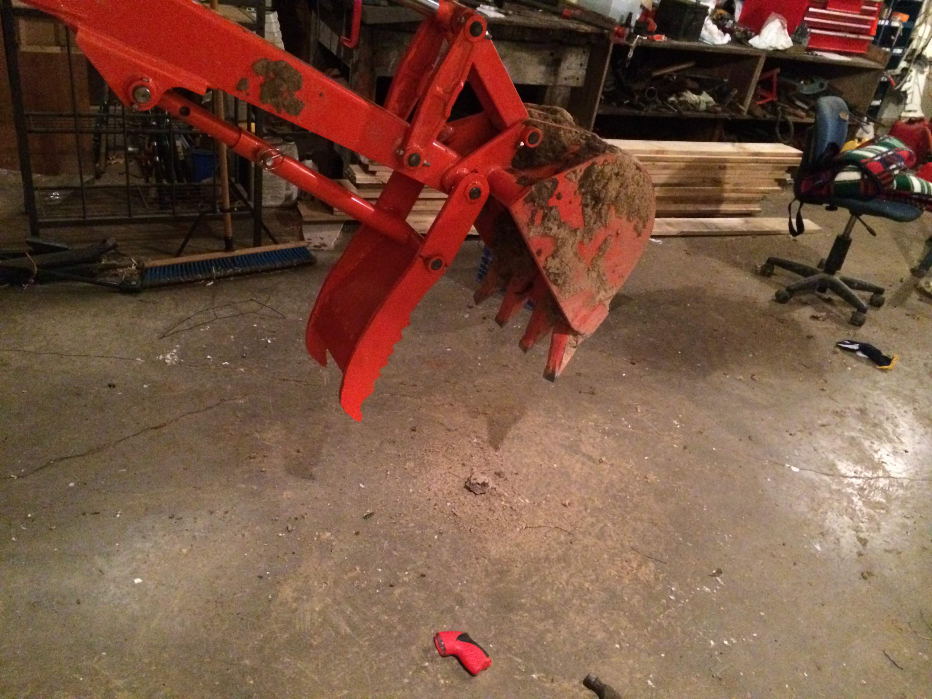

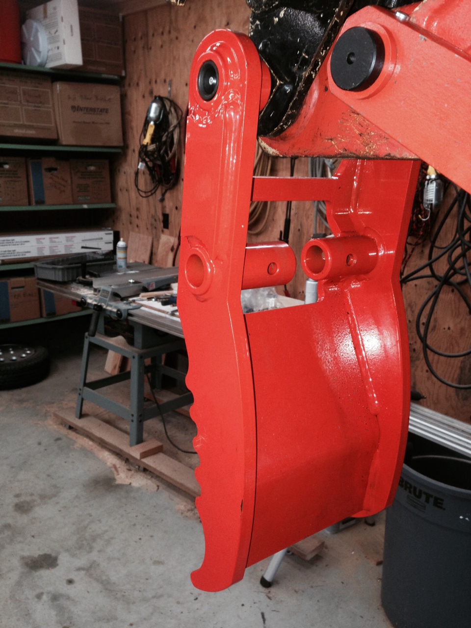

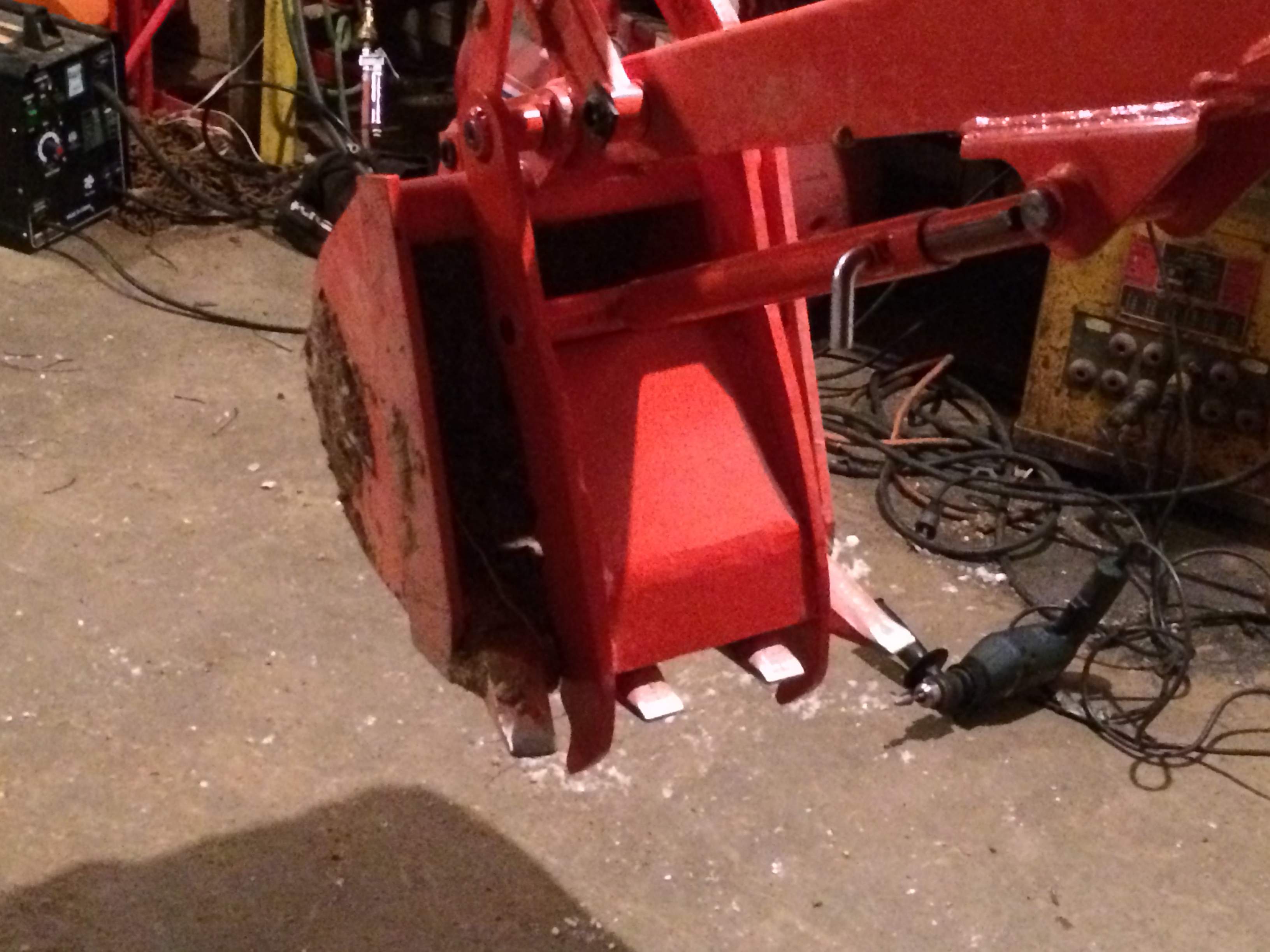

yes i didnt sorry i didnt post pictures, here is the finished project image3.jpg image4.jpg photo2.jpg
