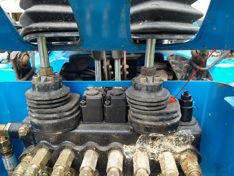

Pulling a few stumps this morning and one of the main joysticks started to loosen up. It still works, just wobbles. I opened the one cover and loosened the top plate and this is what I see. The red arrow points to the wobbley spot. There is a rubber boot covering whatever's under there and it's held by a tywrap.
Is there anything under there I can do anything with? A nut to be tightened? I don't want to open it and find something broken.

Yes there are rod ends hiding under the boot. It's common for the bolts or nuts to loosen over time. Some people will actually put a dab of blue Loctite on those. You may be able to do it by just cutting that zip tie and lift the boot up, to have access to the linkage.

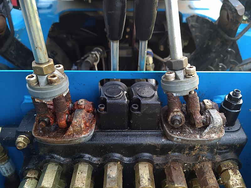

OK, you made me look. As I feared, it won't be that simple. Water has been getting inside that boot and all of the surfaces are rusted/corroded. The center swivel points of those eyes seem to be gone. Guess I need to find a source and do whatever.

If the issue is just the nuts or bolts loosen up over time, then blue Loctite fixes that. If the issue is the rust, just spray something like Fluid Film or similar and probably put a tarp over the backhoe or at least the control valve area if it sits outside.

Odd, because the rustier one on the left is OK (for now). The right one is where the trouble was. Got it working temporarily until I can find the rod end ball joint.
I'm not sure how water got in there since both boots were sealed at the rings marked with the arrows.
Cleaned it out with Gunk, then carb cleaner and air, then gobbed it all with marine grease. Will leave it open for a while until I get parts, maybe longer.

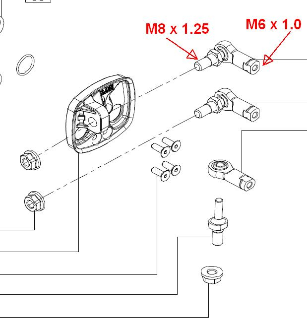

This is apparently a Walvoil 5/6 control valve, but so far I can't find the rod ends separately. What is complicating things is that the rod end is 8MM and the other end is 6MM. So far, I can't find that combination.
I thought I might be able to use one with 8MM at both ends and enlarge the hole in the top plate, but that isn't going to work. I might try one with 6MM at both ends and use a bushing over the threaded end if I can't find anything else.

Found them, and they show an item with M8s at both ends and one with an M6 stud and M8 housing (opposite of what I need). Sent an inquiry and they replied they don't have the one I need.
But then I found this site, also in Bushnell, IL and showing exactly the same pictures.
That site indeed shows the one (I think) I need and for a much better price in a quantity of 4 that I would take:
They also show this that should work for the third one in each side:
I have an inquiry in to them to confirm a couple of questions, but it looks like I might be able to get all six items for under $25 shipped.
