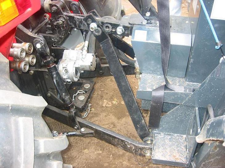

There are different opinions on this, some prefer the backhoe to run off the tractor hydraulics. I prefer the separate PTO pump for the reasons stated by Mad, above. I also like the fact that the tractor only need turn the pump via the PTO. Most have 2 speed PTO's and mine has approx 50hp PTO. I can use the higher speed at lower rpms and generate enough speed and power for the backhoe and burn less fuel.
Here's mine attached.

   / BH with separate hydraulic pump #6
Mad,
Yes, they are the rear remotes that came with the tractor. 2 sets....
One thing about Chinese tractors, mine came with Chinese female QD's. I had to call my dealer and he sent me the males that click into them. (I got several sets) I had the males attached to the hydraulic lines for the TnT. They are quite a bit larger than US standard QD's and did not fit up.
I also read that some dealers set the rear remotes up with American QD's before selling to the public.
