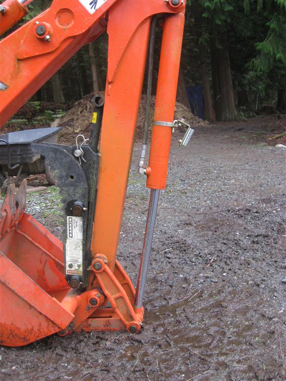

the dipper rod on my bh75 was damaged (bent) and i am wondering if i need to have some special tools to replace it? has anyone done this or is it best to take it to a shop to have them swap the rod out? could the bent rod cause damage to any of the internal parts on the piston, cylinder, or seals?
you get bonus points if you can guess correctly how it was damaged. the hoe was not digging when this happend, in fact the tractor was not even running.

technically, you don't need special tools. it depends on the shape on inside. If you are not sure, I'd remove it from your BH with standard wrenches and take whole thing to hydrualic shop and ask for opinion. As long you didn't try to retract it, I would just leave as it till its looked at. some cylinders need spanner groove wrench or pin type wrenches or its welded shut.
Chances are a shop will prefer to replace rod, they could try to put it in a press and straighten, but they will tell you it can leak and no gaurantees.
Why not post a picture of it before taking it off? make sure you post pics of ends too.

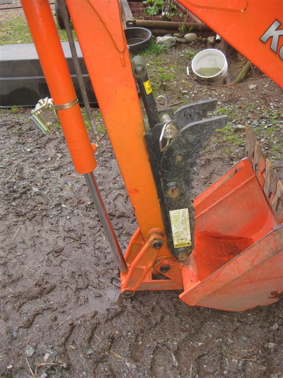

here are some pics it does not look as bad as i think it is..

This would be a good case for straightening.......if you decide to do it, a shop press with thick alum sheet metal chunks will protect the chrome from damage and a dial indicator helps to see when you get it close to straight
A seal kit and you're off on your way.....
   / bh75 dipper rod bent #8
So do we have a winner yet on how it got bent? Curious to know so I don't make the same mistake. And I hope you can have a hydraulic or machine shop straighten it out for you. Looks to me that it can be bent back into position.

it's about $450 for the rod and seal kit + 30 minutes of shop time. if i decide to buy a complete new cylinder it's around $600. i think i'll try to have the local shop put in in a press and see if they can straighten it. it is not leaking currently and the outer ring looks OK.
wdchyd was correct on how it got bent, someone (not me) backed into it and let me tell you if anyone actually tried to do this would not be successful. i know how it happened but still don't beleive it. the receiver hitch on the truck entered right between the dipper arm and the rod and the ball wedged between the two. they tried to pull the truck out but it would move the entire tractor. anyway a call was placed and i rushed home to assess. i had to start up the tractor and fanagle the hoe around for it to let loose as it was in such a perfect angle it did not want to let go of the ball.
