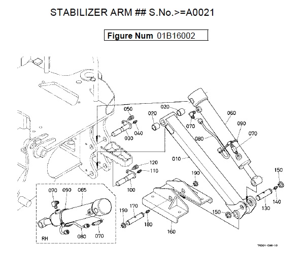

Just for the heck of it check the metal shoes on your rig and see if they are pre-drilled with 4 holes per shoe. If so then they are made for adding the rubber pads. See the parts manual pic attached, shown drilled with 4 holes from factory.
Glad you found them on eBay
Hey Chris,
Yes I checked them before I bought the rubber pads on e-bay, the pre-drilled holes on my metal pads are 8" on centers. The rubber pads measure 4"X12" That's the info that the e-bay seller posted. But as I said the two dealers that I contacted stated, that Kubota only allows them to sell metal pads along with rubber inserts together, at a cost of $129.00 each. Now maybe when I ordered my new TLB I could have had them as an option for a few $$ more, but It would be hard for me to believe It would be less then the $19.95 I payed for the pair. Chris, Nice talking to you. Enjoy your B3200, I just think mine is a real great sized tractor.
DevilDog
