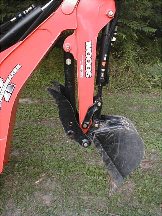

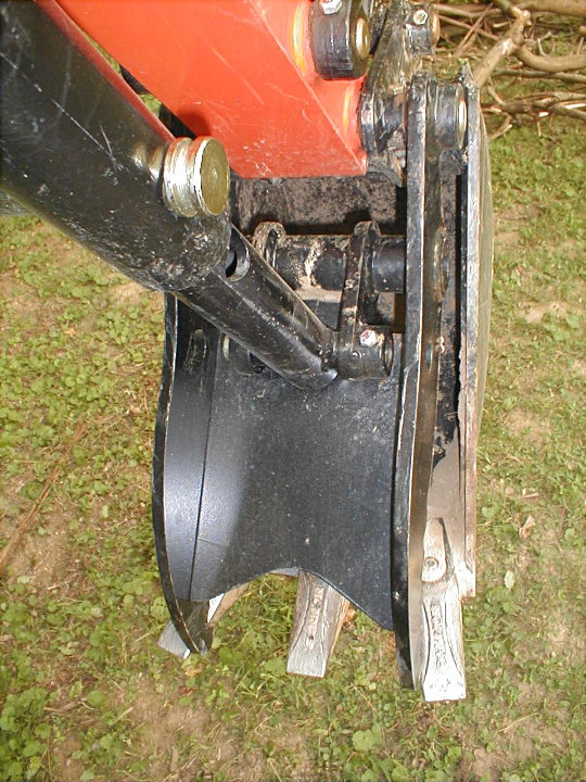

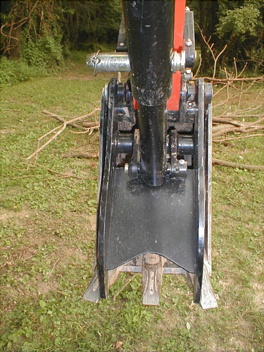

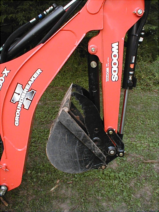

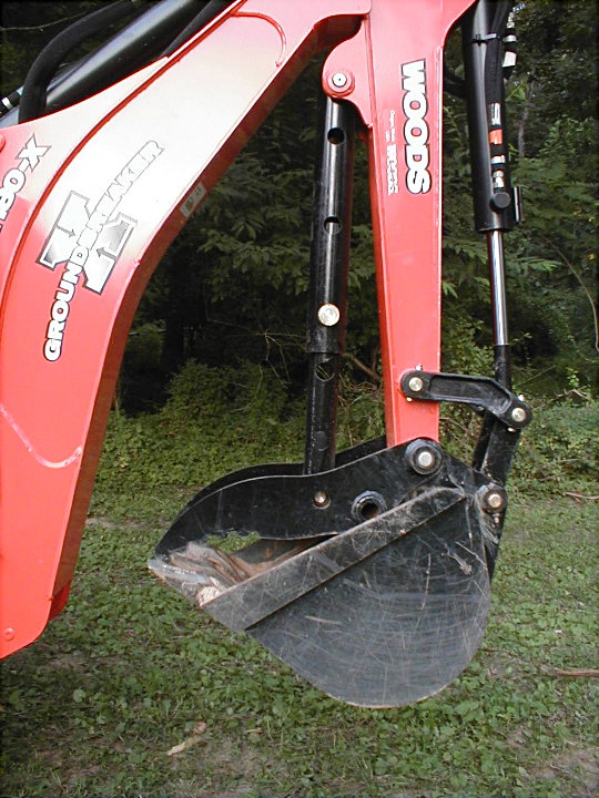

The statement in blue is indeed true as the 12" bucket and thumb do not mesh completely. It does not have the more serious problem Haz describes, where the thumb interferes with the curling the 9" bucket. Just something to be aware of when making bucket selections.
When the thumb is stowed, a fully curled bucket barely touches it, therefore it doesn't interfere with anything. The thumb does fit inside any bucket 12" & up. When the thumb is down, the 12" bucket leaves a small gap behind the teeth. I claim it works fine because anything smaller than this gap, I wouldn't really need the BH & thumb to pick up in the first place. The thumb and 24" bucket do mesh completely, as I suspect any bucket wider than 12" would.

This next one, the first and last limbs are about 2" dia. The second one is about 3" dia. Keep in mind, this also works great for ripping & crushing tree roots, as I've done many times. You can see from the earlier Mesh pics how the 12" bucket provides a nice scissor action against the thumb.

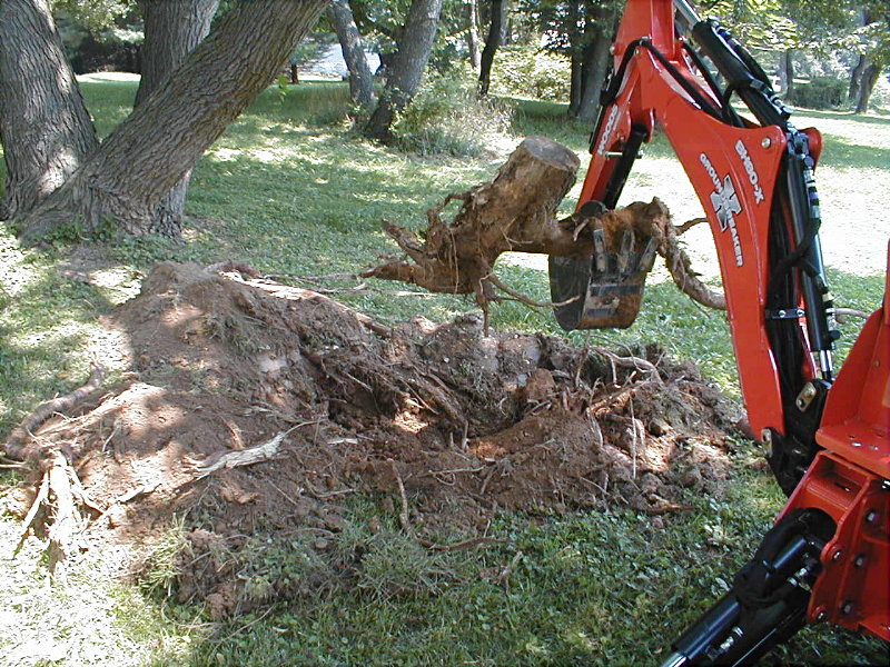

I found this pic from right after I got the tractor (when it had barely a scratch on it :(), was my first stump (OK it isn't going to break any records). All that "debris" you see lying on the ground around the hole is pieces of root that I ripped out courtesy of the thumb (crush & rip), and I didn't even have it lowered. IIRC, the entire affair took about 15 minutes. I've picked up stumps about twice this size. If you push them onto their side, then you can just grab them with the thumb and drive off.
