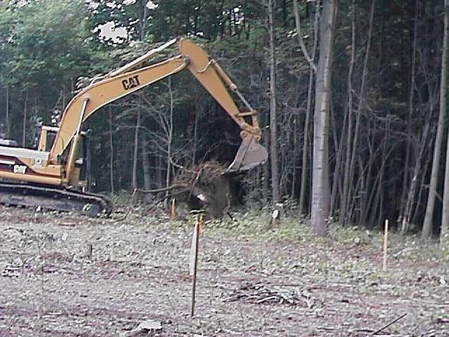

Yes you could do it with a backhoe and lots of time but a good sized excavator could do the same job in just a fraction of the time. When we were putting a pond on our property we cut all the trees ourselves and left the stumps. When the excavator rolled in he popped the stumps out of the ground like a dentist pulls a tooth. He had it done in a matter of hours not days.
The picture shows how easy it is.

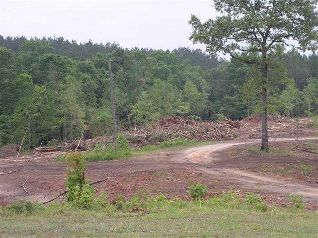

Heres a photo of the piled up limbs to give you an idea of the size of this project.

In the photo in the post above, for reference, note the power pole and the big oak tree. There is another sizable pile of limbs that you cannot see to the left.

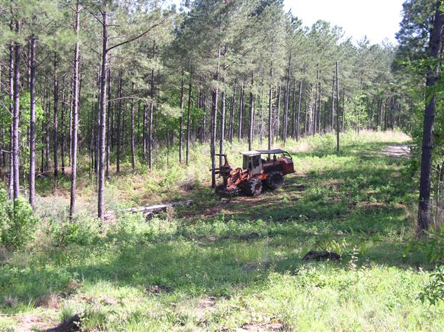

This photo is of the same area as above before all the trees were cut to give you an idea of the root density.
