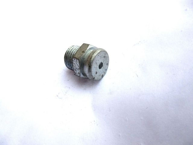

I couldn't find the answer to this in other zerk threads, so I apologise if I am rehashing old ground. That, and this is probably a dumb question, but one that I can't see to find an answer to.
Some of my equipment has zerk fittings here and there that are way to big for any of my grease guns to fit. They look like about 1/4" od, and I'm guessing the "normal" zerks are about 1/8" od. Literally, for years, I have perused grease gun fittings at various stores and have never run across a zerk coupler that looked like it would fit these big zerks. What do I need to be able to use these things?

They are definitely zerks on grease points, for example, the boom king-pin on the backhoe.

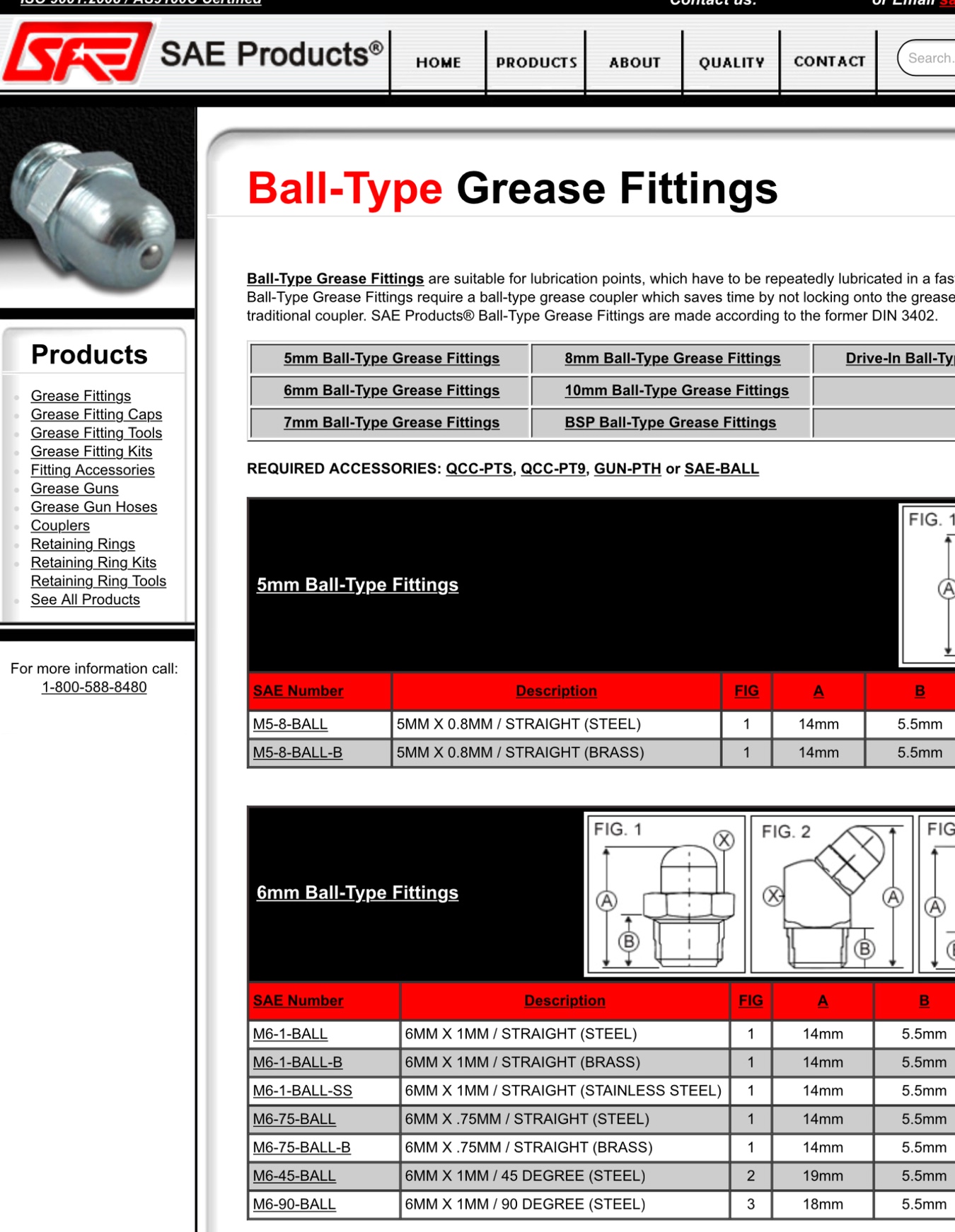

Are they button head grease fittings?
