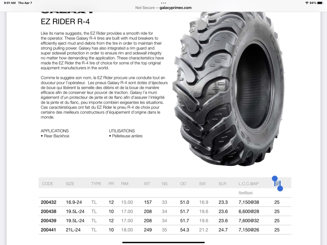

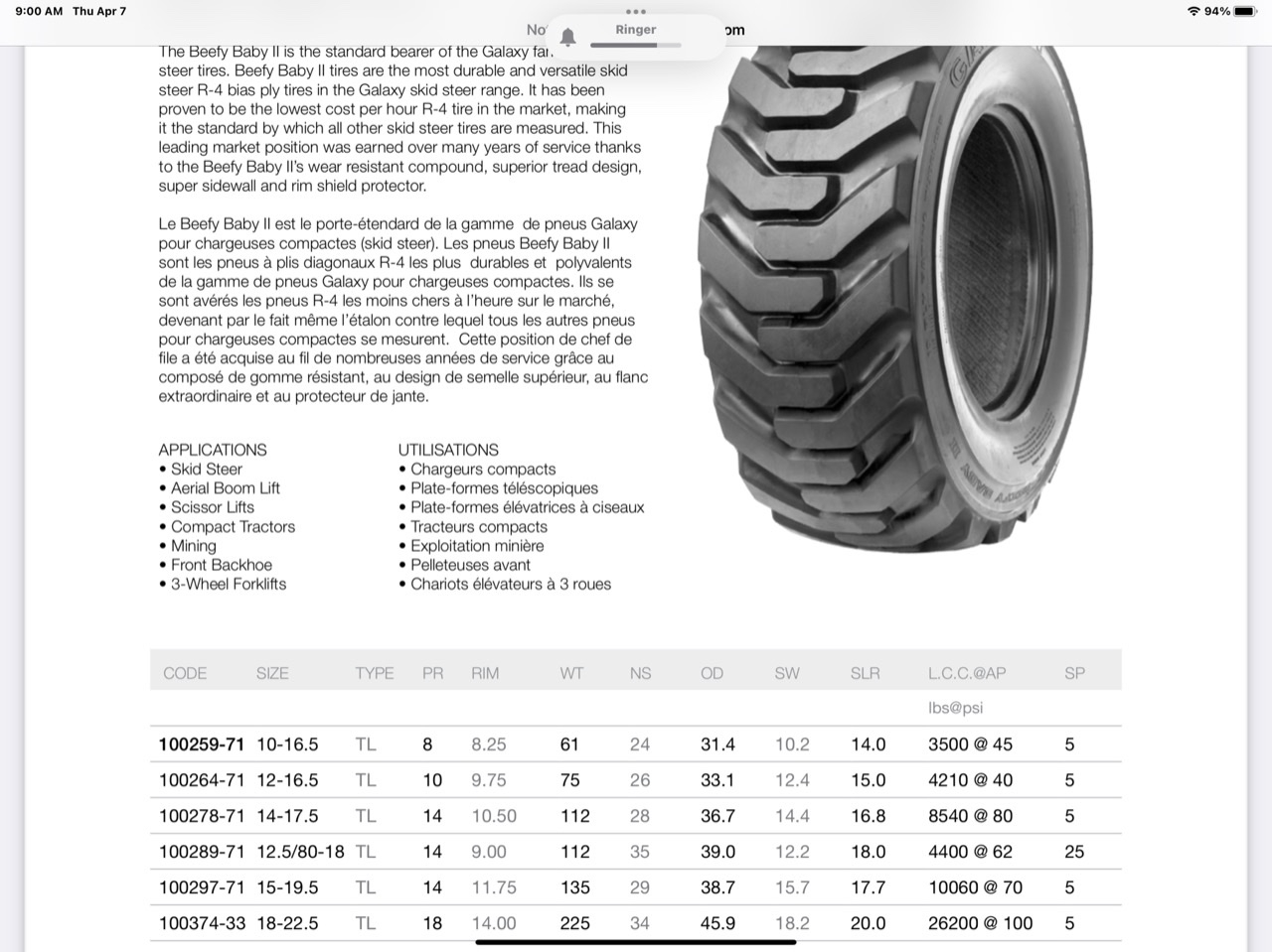

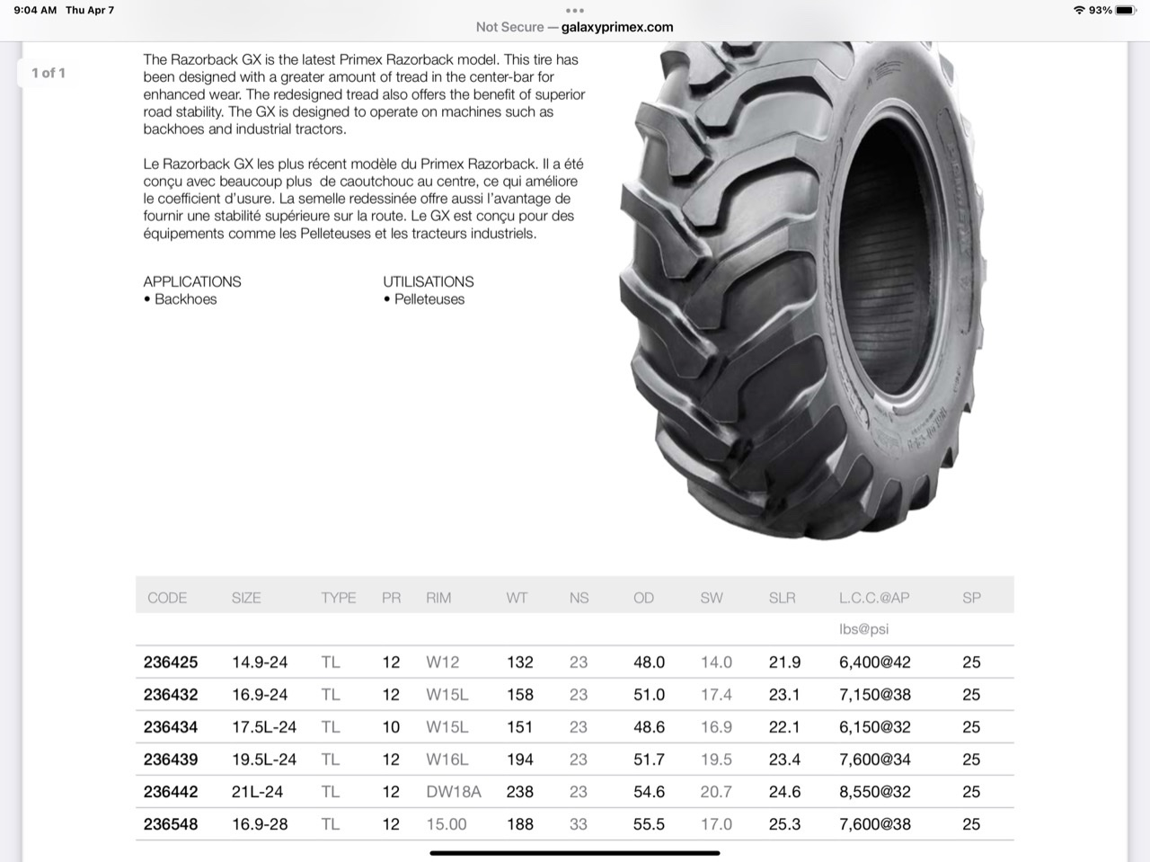

I spoke with the tire shop and after they consulted a group of mechanics/Techs, they said it should be no problem. I’ll take some actual loaded and unloaded measurements, but the ones that are on there are completely mismatched (R4front worn flat, turf rear with maybe 3/8-1/2” left) so I don’t think that‘ll help In the evaluation so I went off the new dimensions listed in the attachments/pictures above. Since the Galaxy EZ rider doesn’t appear to have a 17.5L-24 on their product sheet, but somehow I can get one, makes me wonder if there was a typo. Regardless, I included the primex sister tire dimensions (appears to be).

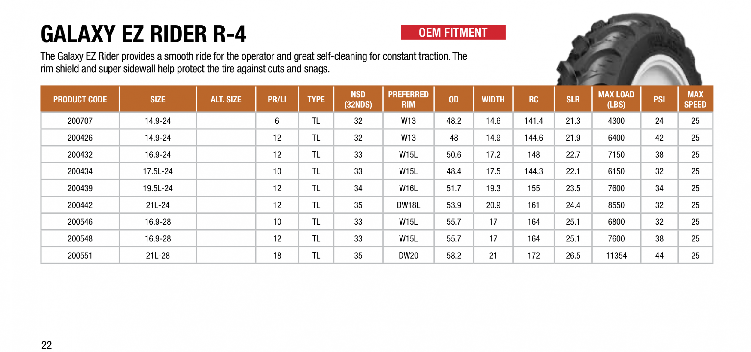

I don't think you will find your answers at the tire shop mechanics and techs. What you are wanting to do is a bit above the tech level of what they do.
First of all you are in the wrong info sheet with those advertising sheets you posted. They don't show rolling circumferenceThe specs you want are in the tire technical specs, not the advertising specs.
Yokohama makes your Galaxy tires. They are good tires. So go to the Yokohama tech spec catalogue and look them up:
You will find a general guide to rolling circumference index on page 5, and each tire will have Rolling Circumference listed under the term: "RC". You can see it below. If you would rather start with wheel size, that is on page 78.
Below is an an example of the tech specs from the Yokohama tech catalogue pg 22 for your EZ Rider R-4:
Just to check the importance of RC, take the first tire shown which is a 14.9x24. it's RC is 141.4. If you divide RC by pi, you get RC is 155". Divide that by Pi, and you get 45.03 - which when compared with the Outside Diameter (OD) of 48.2means simply that you have to use RC, not OD. Considering the tire to be round leads to an error of over 6%...... which is enough to snap an axle in 4wd.
You can do this, it just takes some calculations and the last one I did required I buy some oddball front wheels to get the ratio where I wanted. But front tractor wheels are surprisingly inexpensive. About $70 each as I recall. I was going from R1 Ags to R3 Balloon Turfs on an odd application. R4 tires are easier.
