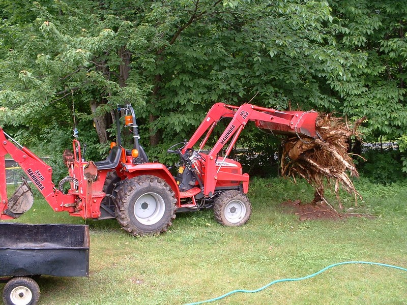

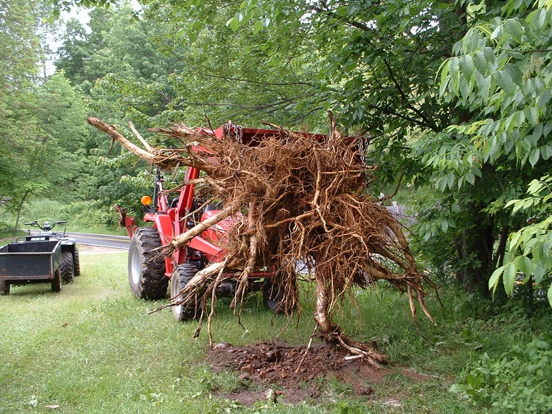

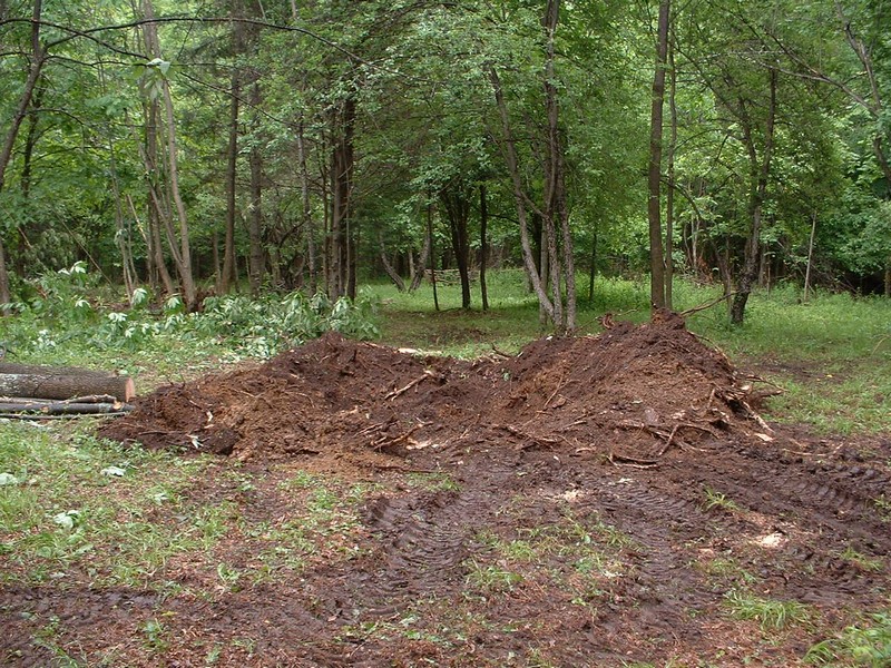

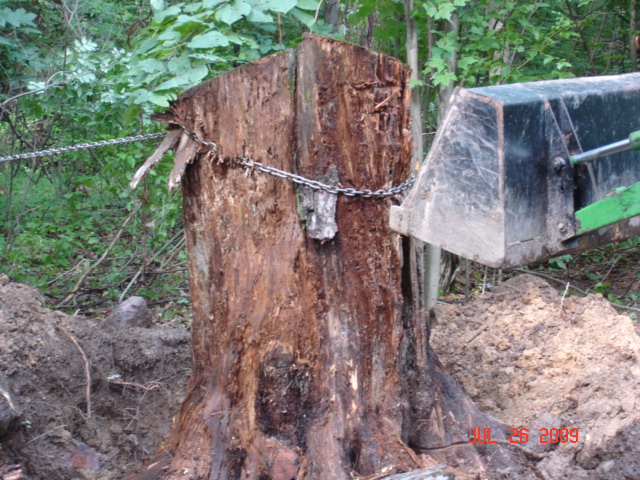

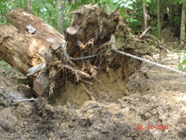

I've removed plenty of stumps, but most are about 4 or 5 inches across. This was 23 and took a couple hours. Had to wash it off just to be able to pick it up off the ground. I'm very happy with what the machine can do. Seems like you should be able to get "bucket" for a hoe that is only a single serrated tooth so that you can cut the roots closer to the stump (with depth) and make much shorter work of these things. Anyway, one down, who knows how many more to go. . .
Hope the pics show up.. know how you guys love 'em.

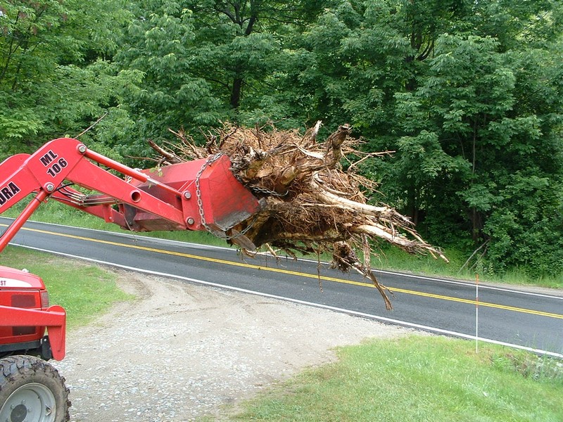

Yep, big stumps take some digging. You know you have a big one when you have to dig a ramp into the hole to skid the stump out. Be careful carrying a stump in your loader bucket as high as you show in the last photo. Hit the wrong dip with your center of gravity that high and you will take a ride you don't want to.

that's a big one, nice work. i dug out 22 alder stumps today biggest one was about 16" across and took about 40 minutes.. some smaller ones came out in 10 minutes. now i have a nice big pile of stumps i'm using as a backstop on my 100yard shooting lane. i'll let them bake in the sun over the summer and as soon as the burnban lifts, they're getting torched. what else could i do with them? i'm told landscpapers like cedar stumps to use as yard deco but not sure about these alders.. i don't want to pay a grinder to come get them.
i used to try to dig them out without repositioning but now i dig on either side ripping the roots by coming under and across them, then reposition and go after the remaing two sides, i end up with a big moat around the stump and can always tell when i got the last holding root as the stumps breaks loose. then i flip it over on the hole and pull the dirt off of the bottom with the bucket teeth.

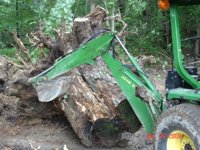

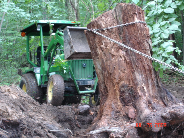

This one was my largest to date
