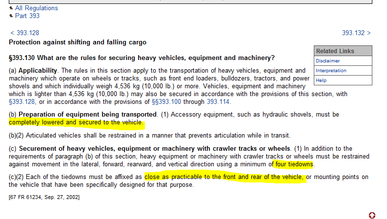

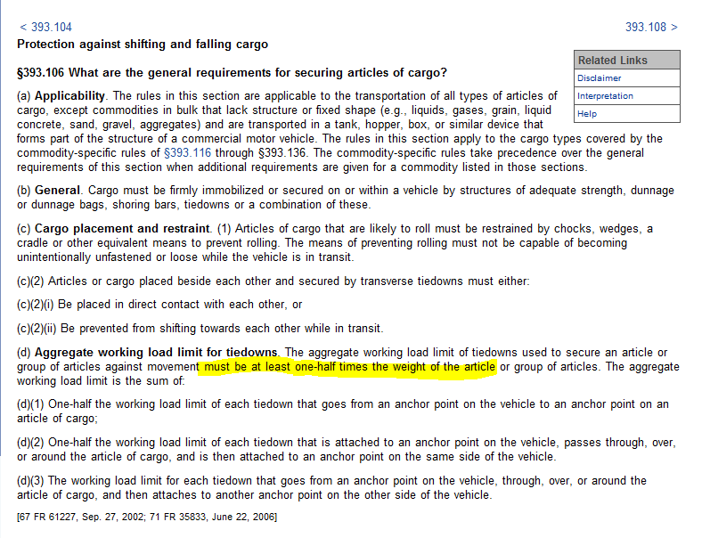

DOT regulations require you to secure the load by 1/2 its weight. So if your tractor weights 14,000lbs the total working load of your fasteners need to be rated at least 7,000lbs.
The rating DOT allows per chain also depends on how you use them to fasten the load. If you are using the chain to go from one side of the trailer back to the same side, you get half the rated working load of the chain. If you use the chain to go from one side of your trailer through your tractor to the other side of your tractor, you get the full working load of the chain.
If you have a fel you must also secure that in some way. Chain/strap or pin it down. I know there have been comments on here on how stupid this is, but that is the federal regulations. It is more of a problem with backhoes that do work their way up and hit bridges.
Don't forget the binders, they also have to be rated for have the load.
To answer your question two 5/16" grade seven chains (2X4700= 9400lbs) would meet DOT requirements if used correctly.
Edit: you will need at least four tie downs since your tractor is over 10,000 lbs.

Here it is from the federal regs. Click on thumbnail to make readable.
