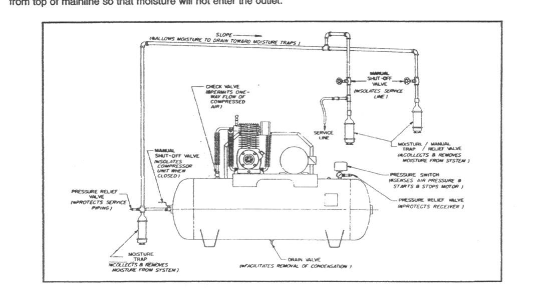

It is my "intent" (key word) to plumb my pole barn for air on my next trip home. I've read a number of posts here, and know that PVC is not the way to go, so metal pipe is definitely what I'll be using. My question is, should I be using black pipe or galvanized for the lines? I won't be running an oil system, as I'll be occasionally painting, and I won't be using tools enough that manually oiling them would be a problem.
I'll be installing a water filter and drops with ball valves throughout the barn. Is the small amount of water in the lines enough of an issue that it even matters as far as potential rust is concerned? I know a lot of this is opinion based, but I've gotten a lot of good information from this site, and am definitely willing to listen to what anyone has to say.

I suggest that PEX might work better than PVC (oxygen barrier-type), but you'd want to use 3/4" vs 1/2" to minimize flow restriction, esp if you were to use poly vs brass fittings. Galvanized is not code for NG in our area even at the low pressure compared to water. Don't know if that's because plating may flake off & cause issues or the possibility of chemical interaction between zinc & gas or the mercaptan odorant.
Condensation will likely concentrate in the tank vs lines. Of course, installing drip Ts at each drop is wise, but having installed valves on them vs caps I've yet to release a significant amount of moisture from those used most frequently. Moisture traps must be monitored and filters changed on a somewhat regular basis, esp on the drop you paint from.
Refrigerated air dryers are a luxury few can justify unless using copious amounts of air such as with a blast cabinet. FLRs are cheap and perhaps best placed at drops where power tools demand the lube. No sense oiling a whole branch. Doubling drop outlets can have advantages too, say one with FLR for tools & one w/o at higher pressure for that blast you'd use to clean something off. This may make more sense if your system is charged by a 2-stage vs SS pump and at higher pressure (>100 PSI, etc). btw: most power tools are intended to be operated at 90 PSI so they work ok between pumping cycles.
Not much to gain by sizing trunks much bigger than 3/4". Total system volume will supplement tank capacity and moderate pressure spikes, if that were perceived as a problem. Re-purposing components may not be worth the bucks saved. Brass valves have nearly doubled in price in 5 years, and tho' gates are nice, ball-cocks are the way to go. Make sure all are 'full open' type.Separate components (FLR, etc) that have service intervals. Plumbers use unions to ease maintenance/upgrades later but can be temporary trouble spots if doing them in a rush.
A main shut at the tank is the first place to put one for obvious reasons. Adding a gauge beyond it allows you to recognize downstream leaks. Buy or mix 'bubble stuff' to spot them during installation and later. I would use black iron period, but that's just me. :)
