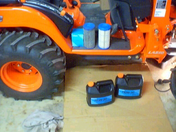

The WSM spells out how to service the airfilter element and I'll post a brief description.
Every 100 hrs inspect the element and clean the element if:
-When dry dust adheres to the element, useing compressed air blow from the inside out turning the element. Air must be under 30psi.
-When carbon or oil adheres to the element, soak the element in detergent for 15 minutes then wash it several times in water, then rinse it out in clean water. Let it dry naturally.
-Replace the element once a year or after every 6 washings, which ever comes 1st.
I blew mine out at 50 hrs and replaced it at 100. There was a very visable difference between the new and used when I sat them side by side. The attached pic shows a 100hr old element that had been blown out with compressed air at 50 hrs....
All that said, I recall a post by a Kubota tech that indicated that they were told not to even break the airfilter seal until the 100hr service or until the engine starts puffing black smoke because the element may not seal correctly if R&R'ed just for inspections. Apparently they are very concerned that the air filter elemnt may not have a good tight seal in the housing after repeated R&R'ing of it.
FYI & FWIW.
