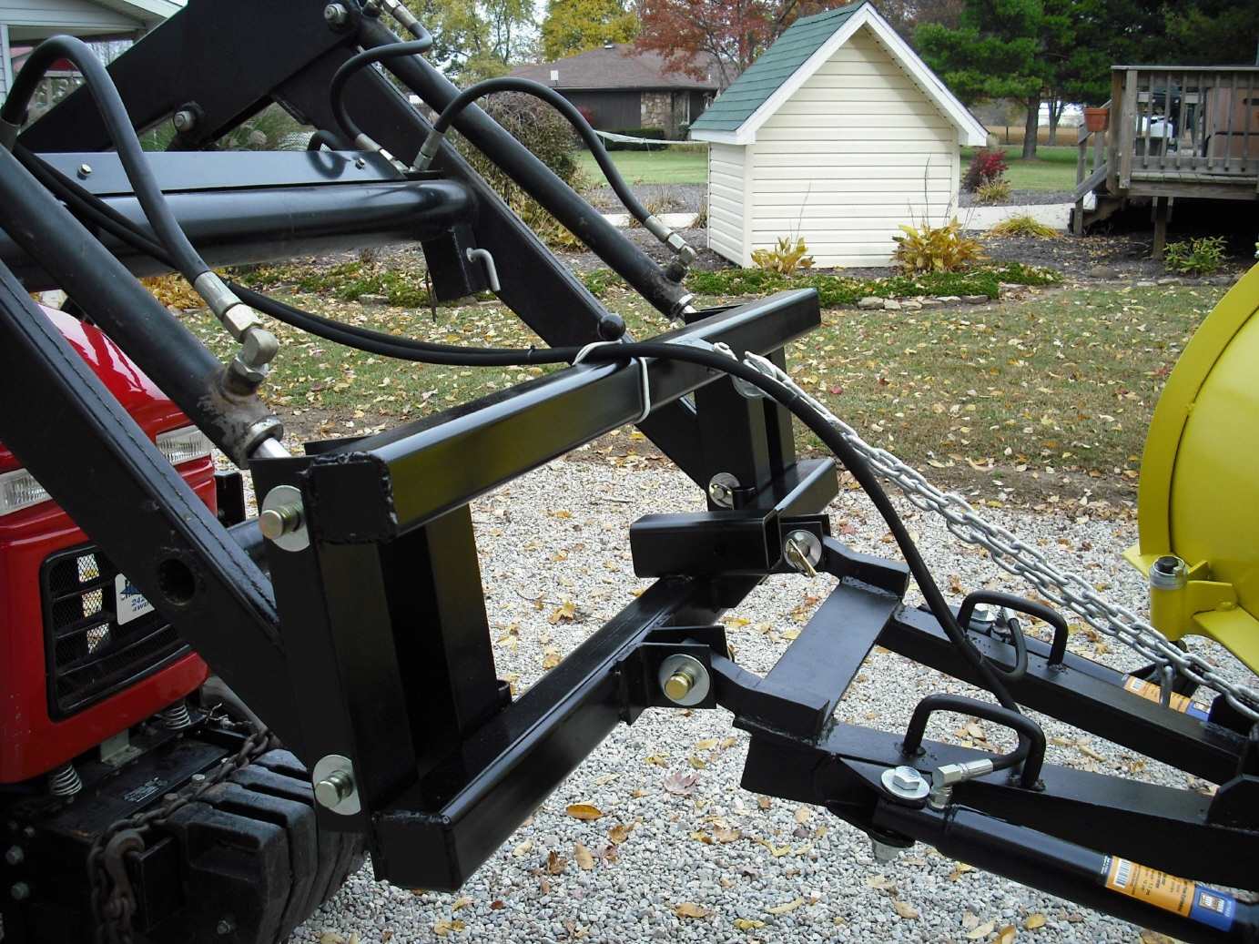

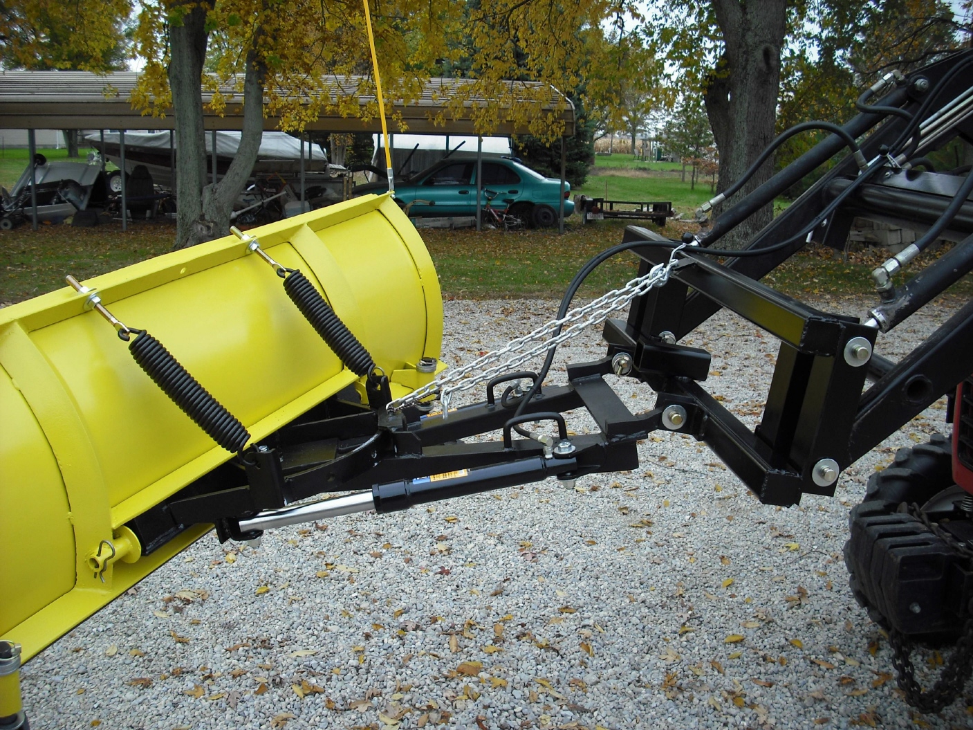

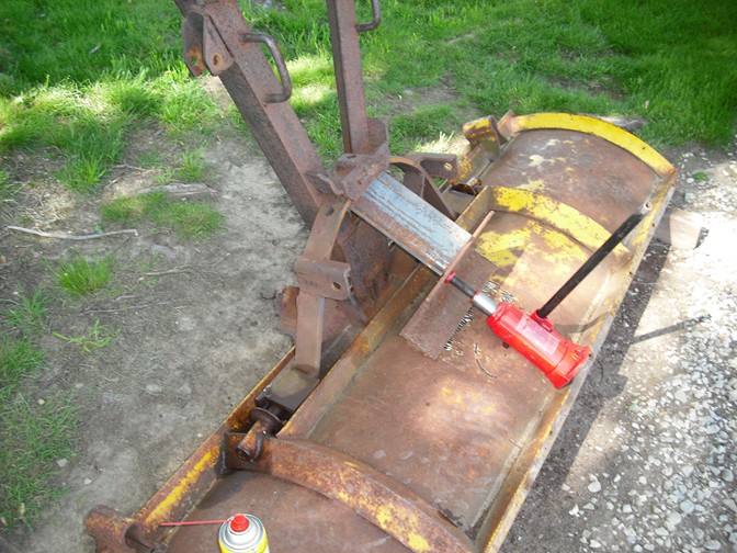

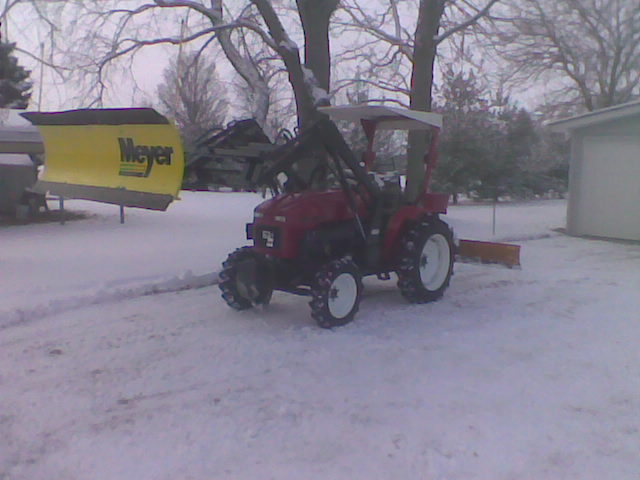

Most do as I have done and picked up a old truck plow for about $100 then spend $400 having it sandblasted, repainted, new hoses and cylinders, and adapting it to your tractor.
Chris
