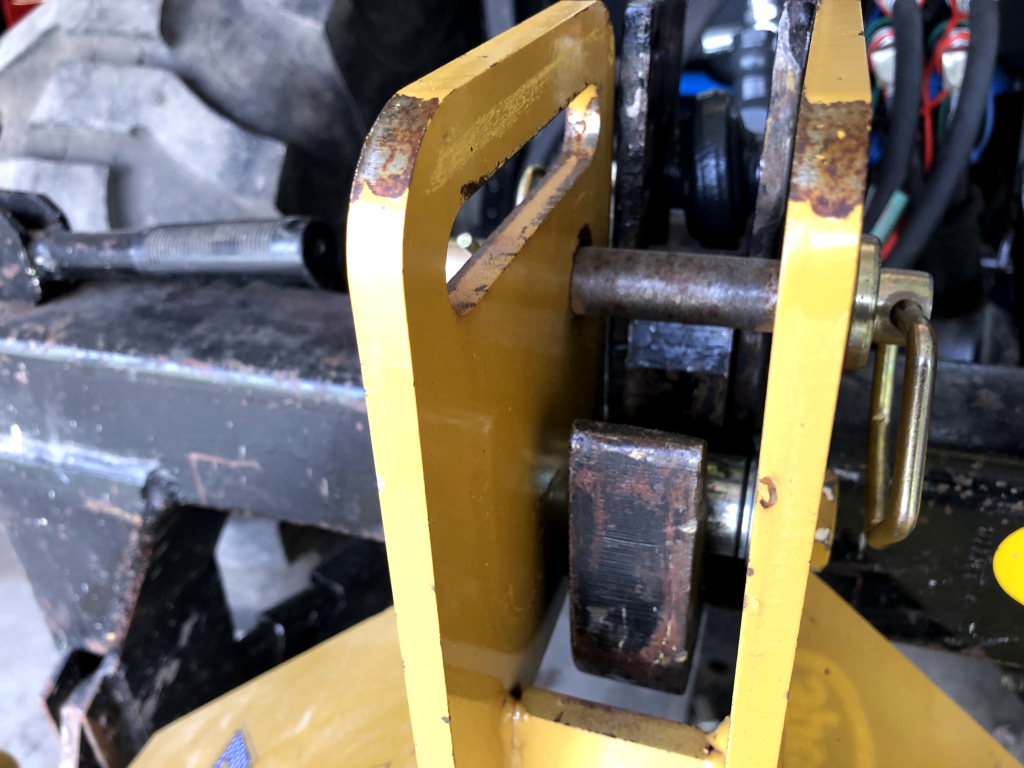

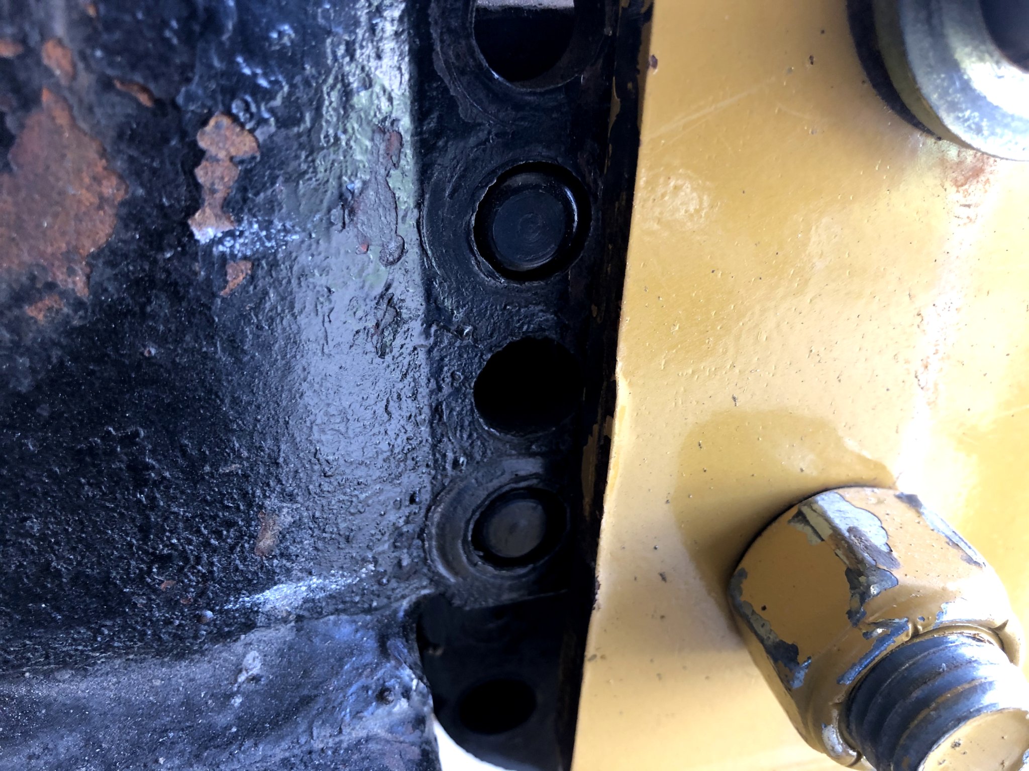

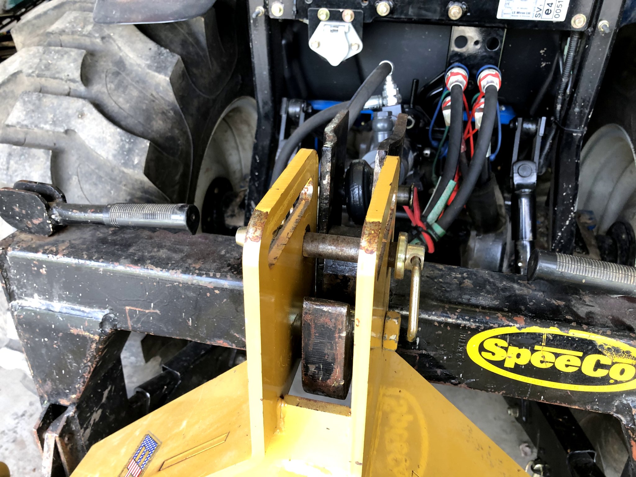

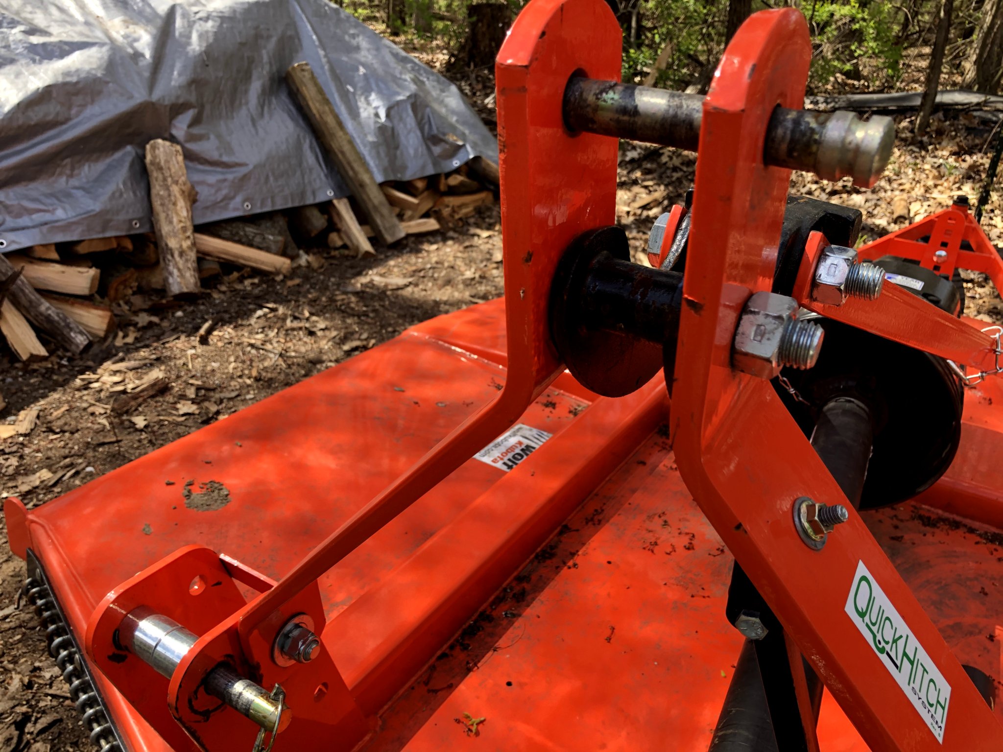

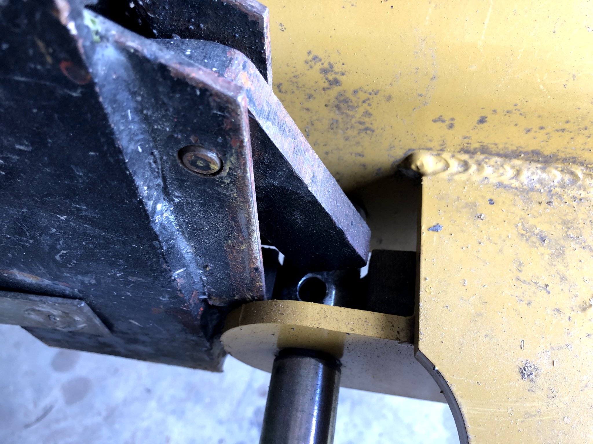

I have a Land Pride rotary cutter and a Land Pride rear blade and a Everything Attachments Landscape Rake and they all fit my Speeco Quick hitch . The implement should have a upper spot for a top link pin and below that should be bushing for use with the quick hitch. The main problem with most QH is the bolts that attach the top hook hit the imp!ement, so either buy an extended top hook or do what I did and tack weld 2 pins in place (all 3 of my implements fit the same so no need of adjustments)
I put Cat 1-2 and Cat 2-3 bushings on all my implements so they fit nicely in the QH hooks.
