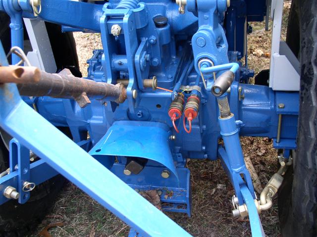

I have a rear 6' blade I use mainly for moving snow 60+" so far this season here in Colorado. I mainly push or pull snow with the blade reversed so it doesn't dig up my recycled asphalt driveway. But, the blade doesn't seem to have enough weight or down pressure, it just rides on top of the snow and doesn't take much of a bite. I built a plywood box that sits on top of the blade hitch that I store chains, tools, etc. I am considering putting some concrete in the box for extra weight. I thought about gravel or sand but think I'll just lose it over time from bouncing and operating the blade. What do you guys think?

Is the cutting edge in good shape? If it is, then you might try changing the forward angle by lengthening the top link. Are you sure the draft control on the 3PH is not lifting the blade?

I did reverse the cutting edge just recently. It is an older blade and the previous cutting edge had quite a crown to it. The reversed side is nice and straight. When I am pushing or pulling snow I just lower the blade to the ground so on my tractor I believe it is just gravity holding it down (no hyd down pressure) hence the thought of adding more weight.

Draft control senses the compression force on the top link caused by a drag load at the implement and automatically raises the implement using the 3PH hydraulics. Most CUT's don't have any down force on the hitch so I recommend checking draft control setting first. Your tractor may not have a draft control but check your manual. I can't imagine a JD that doesn't. Here is a picture of the hitch and the control spring (at the very top)that may need adj if the normal draft lockout lever is not working.
