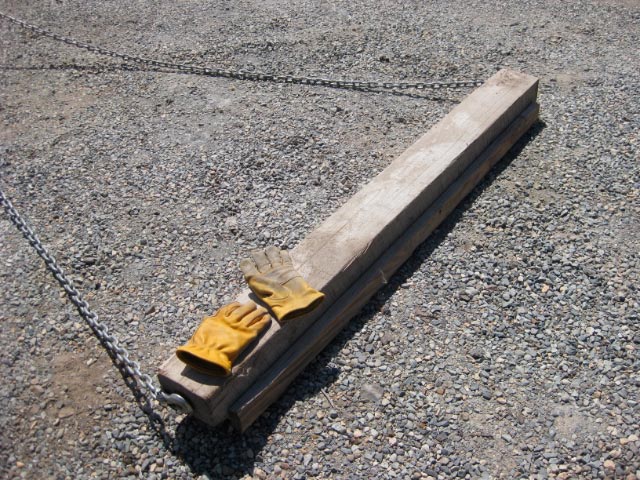

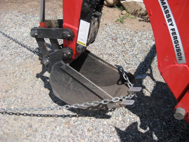

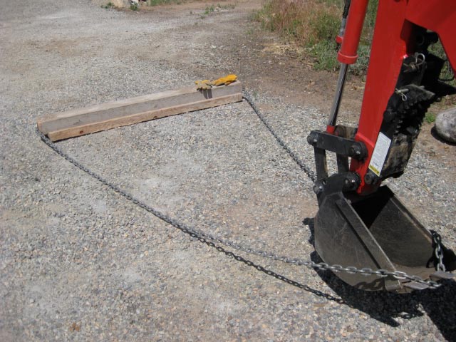

Here's what I ended up doing for the light leveling I needed. I did use found materials--in my case, it was simply a piece of 5'-long I-beam scrap left over from our house construction, with a 4"x6" piece nailed to it for added weight. I added some lag screws to the ends, and hooked my chain to them, and looped the chain thru my BH bucket teeth. I was able to move material sideways a little bit by shortening the chain on one side so that the beam was angled, but the main work was done with the beam set perpendicular to travel. Very light but rigid "implement" and easy to pick up and move around myself. The wood edge did take a beating on the gravel, but when it's totally worn out I can flip the I-beam over, and I have another piece in the wings too. I'll need to use it only once or twice per year. I think this will be all the finishing tool I need after doing the heavy cutting and filling with the box scraper right after the snow melts in the spring. :)

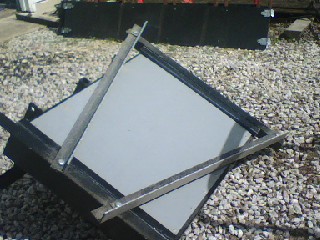

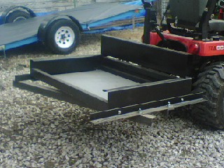

What I use to groom my alley and drive. Plus I can load it as heavy as I want.
