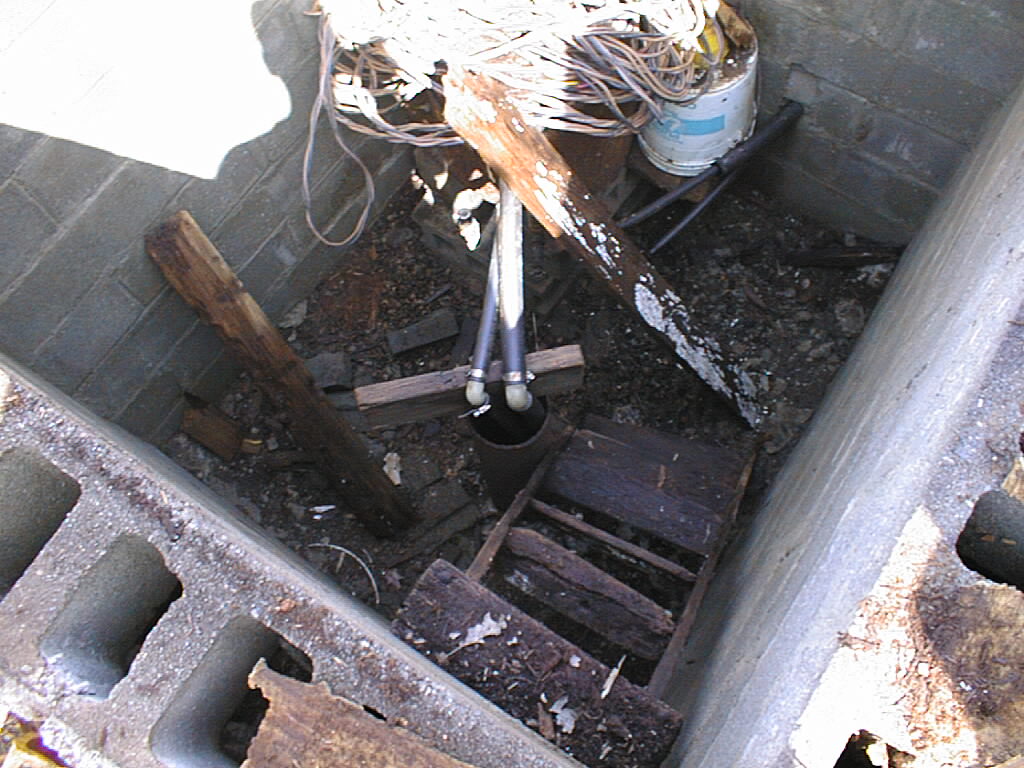

Has anyone ever heard of dumping a bottle of bleach into your well?
We have a well that was closed up, but not capped off, around 15 years ago. See picture. We are hoping to be able to put it back into service again for the new house without having to drill a new one $$$$. We have talked to the well guy who says he can bring it up to code etc. as long as the water and flow test OK. Since it was never capped, someone from work suggested pouring a bottle of Clorox bleach in to kill any cooties before having the water tested. Any pros and cons to this idea? I can't see any harm in it....

I moved seven times in eighteen years with my previous employer (petroleum pipeline on easct coast). The company I worked for purchased my home fot eh majority of these moves. One condition of sale was a water quality test. The professionals who tested these wells all suggested pouring a gallon or two of bleach in the well whenever it failed, or on a yearly basisi to keep bacteria in check. One told me that even one dead cricket that has fallen into the well can conataminate the water and send the levels high.
I routinely pour a gallon of bleach in the well yearly. I then rum all the faucets in the house UNTIL I can smell bleach. Then I let it set in the pipes all day. (the pipes will colect bacteria also). I then turn all the faucets in the house on and let the water flow until I no longer smell bleach. We cook and drink bottled water for a few days until the taste is back to normal.

What your asking about is called shocking the well. Our driller had us do it for a new deep well here at camp. This is what I was instructed to do and the info I got:
Dump 1- 2 gallons of bleach down the well for only a few hrs, never more than overnite then flush it out. . Cleans off impurities and loosens deposits. I drained the water outside using the garden hose.
In a cased well the water will turn black as coal tar /w3tcompact/icons/shocked.gif from iron/maganese reacting with the bleach. There will also be a bleach smell in the water. Keep flushing till it runs clean and the bleach smell is gone.
In this situation I ran the submersible pump only about a 1/2 hr at a time letting the well recharge in between. This well isn't very deep. Less than 200'.

Same basic idea as "shocking" a pool. You put a high enough concentration (> 10 PPM chlorine to water) to kill any bacteria that may be down there. You should probably get it checked first to see if it's even needed though. Once the water is pumped out (with the chlorine in it), the water returns to normal.

Michele, I used to work in potable water analysis, and have advised people on this and have done it on my own well, too. Make sure the bleach stays in the well for about 24 hours. When you pour it in, try to pour it so it comes in contact with the whole well casing. Move it around. After 24 hours, make sure that you run every faucet and hose bib that your well is contected to. You want that heavily chlorinated water to come in contact with every pipe in the system to make sure that you kill any bacteria throughout the system. If you miss even one faucet or hose bib, any bacteria in it can recontaminate the whole system. Let all the faucets and hose bibs run until you no longer smell bleach.
You may have to repeat this procedure several times, before you get clean lab results, but it usually works.
