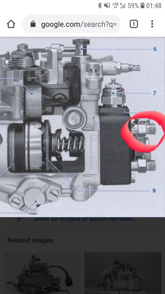

I'm not sure about the Perkins injection pump, but the Bosch has check valves installed on the pump side of the fuel line. This keeps the line and injector presurized and might keep it from pumping air backwards.
Those check valves are meant to hold pressure in the lines to save time for the next injection.

Since your problem moved over to the next cylinder, yes it sure was. I don't know if pressure in the line helps to keep the injector closed.
I've marked one of those check valves in the picture below. I think the Perkins has something similar attached to the ports. IIRC.20200225_014942.jpeg

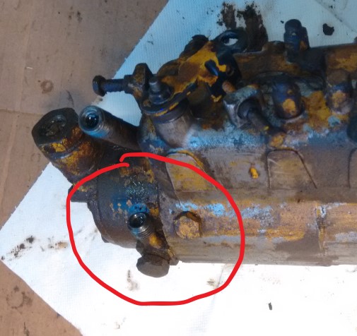

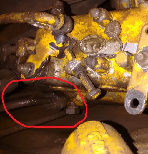

Hi Bavarian; Nope. There was certainly nothing like that on mine when it arrived here - and it looked like it had never been touched. The outlet of one of the ports is here. I worked in Switzerland with a German team for 10 years - and there is no doubt the German engineering (Bosch) is often boots-and-braces : nothing at all wrong with that!!
