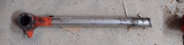

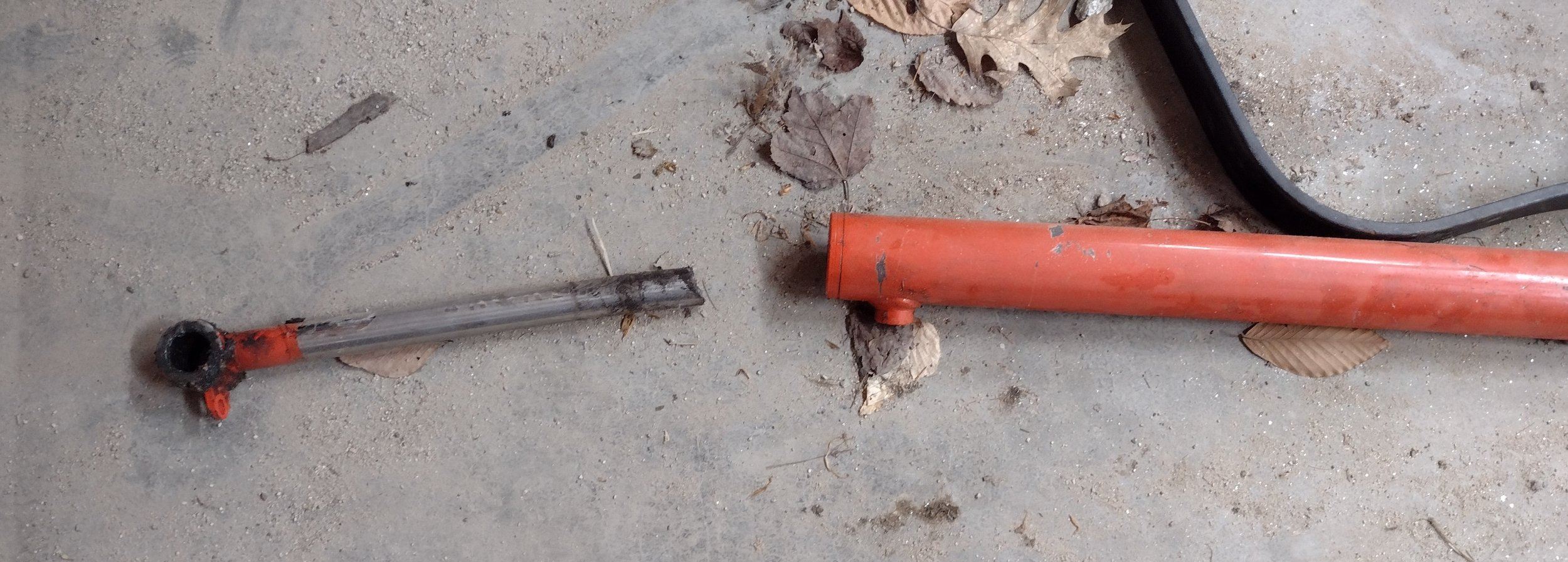

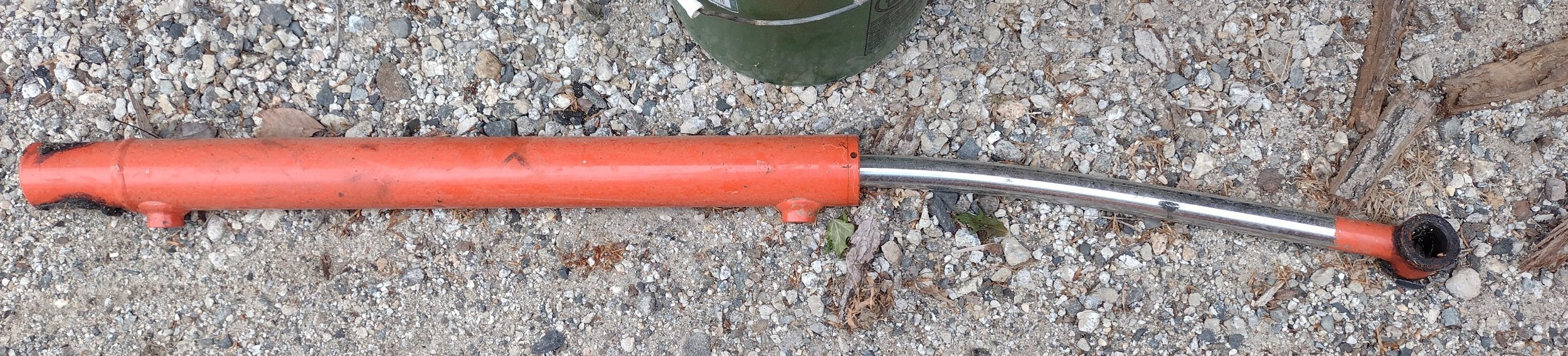

Don't backdrag with bucket perpendicular. I was rushing, distracted and knew better but had grapple wedged down among boulders and hit reverse. $1500 later I had 2 new cylinders! Won't be my last bonehead move I'm sure.
