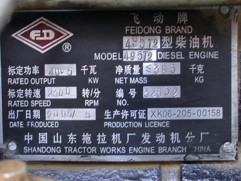

After reading about the compression release I can't remember seeing one on my KAMA 354C.
I think my engine manual also says something about activating an electrical device temporarily before starting. I think they mean Glow Plugs. I can't remember seeing any switches (or wiring) for Glow Plugs either.
I'm learning to adjust to life without hearing, but darn I hope I'm not going blind also!

Tim, My 2004 ts354c does not have compression release or glow plugs. It is pre EPA. I think your have a Y485 engine. It is direct injection. I think the manual information about the glow plugs is for the Y385 engine in the TS254C.
My tractor starts great but I did add a lower radiator heater for those below freezing days here in NY. With you being in Fla. I wouldn't bother. If your battery is good and fuel clean you will be fine.

Tim, if your tractor is a "pre epa" engine it has no compression release and no glow plugs. your key will be sort of a t shape. this is a direct injection engine and is very good starting overall. the new EPA approved engine has compression release and glow plugs and appears to be a 4 cylinder version of the Y385 engine, which is not direct injection but swirl chamber head. this engine is a little harder to start when cold and needs these features. Your tractor probably only has two pull knobs down below the dash, one for the hood and one to kill the tractor. the new ones have 3 knobs, the third being compresion releif.

Thanks Chip for the the detailed information on my model. It must be a Pre EPE as there is only 2 knobs on dash. Previous examination with my "suspect" vision could not find a mechanism to activate valves or wiring for glow plugs.
It was built in Oct 05 (according to plate on tractor, not engine) and I was always wondering if it was the EPA version or not. Reading previous post from last august I thought I found something saying the Y485 engine is now approved for EPA. But my memory is as suspicious as my eyes!
Due to simplicity and ease of starting I'm content with the non EPA version. But for envirnmental reasons I would prefer the EPA version if it's cleaner running.
Tim

I attaching a couple of pictures for you identify what engine my KM554 has. I hope these engine labels will tell you.
Specifically:
1) Is it direct injection?
2) Is is "swirl chamber head"?
3) Does it have glow plugs?
4) Does it have compression release?
I would appreciate your response addressing these 4 questions.
I'll post another picture of the dash panel to show only 2 knobs, not 3.
