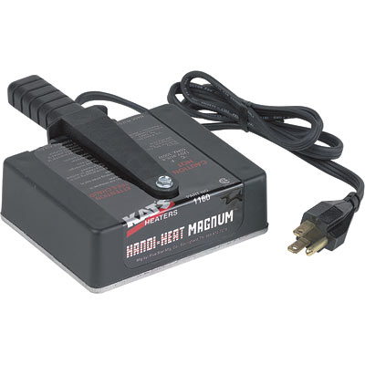

In my opinion, blowing out the filter o-ring is going to be the least of your worries if you build the rig you described. The heater below should work perfectly to keep the engine and transmission oil warm (get one for each). Just get the ruggedized HST filter if blow-out ever becomes a problem.
From Northern Tool at $55.
   / Block and HST Hyd oil preheaters, found and invented, $48 #5
If you want to preheat the filter, try a heating mat such as Kat's 24150 150 Watt 4"x 5" Universal Hot Pad Heater : Amazon.com : Automotive on the filter. That should keep it toasty warm without risking dumping your hydraulic fluid all over the ground and a hose breaks.
If you also get a pair of magnetic heaters such as Jinman posted (or one like Kat's 1153 Handi-Heat 200 Watt Magnetic Heater : Amazon.com : Automotive) you could have your oil, hydraulic fluid and hydraulic filter all preheated.

Thanks for the input. I still don't see how half an hour of a mag heat is going to do anything for the 18" or so of frozen oil in the feed line to the HST filter.
Frozen? You are in the 1000 islands region right? Across Lake Ontario from me? If so, your oil wont get cold enough to freeze solid. Chilled/sluggish? Yes. Frozen solid/slushy? No.
Throwing a 200-300 watt magnetic heater on a timer so that it runs for 2-4 hours before you need the tractor and putting up a windblock to keep the worst of the wind off the tractor (or perhaps a blanket then a tarp) should get the lower transmission warm to the touch with much less risk of breaking something or having a oil spill like could happen with the external coil.

TY, NH sells an oil with even better winter specs than Multi-G 134D. It's called F200. The problem with some filters is thick, sluggish oil that raises the pressure inside the filter and can blow the seal. I can count on one hand the number of people I know who have reported that problem on TBN. Have you actually experienced the problem? I'm in the sunny south, so I don't see really cold weather.
The problem I have with your method is that you are mixing a drill pump with a coil inside a paint can and a coffee pot heater. None of those items are UL approved for flammable oil and there is definitely the possibility of runaway heating or leaks. Even if it works perfectly, it'll be a hassle and a big mess. I just think a couple of 400 watt heaters and a blanket or windbreak as Aaron suggested will be more convenient and pose less hazards. Heck, the F200 oil might do the job all by itself.:)
