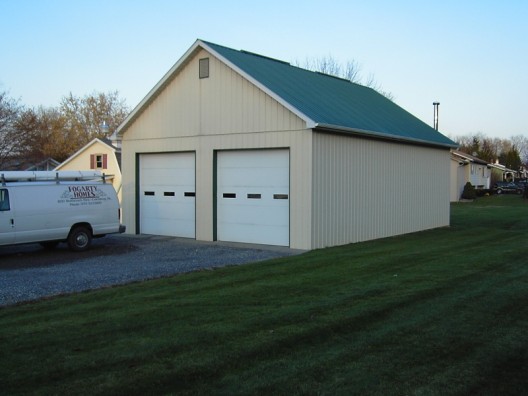

Dan,
Here's what I use for a block heater ;) . Although it did cost more that $120 :eek: .
Bill
