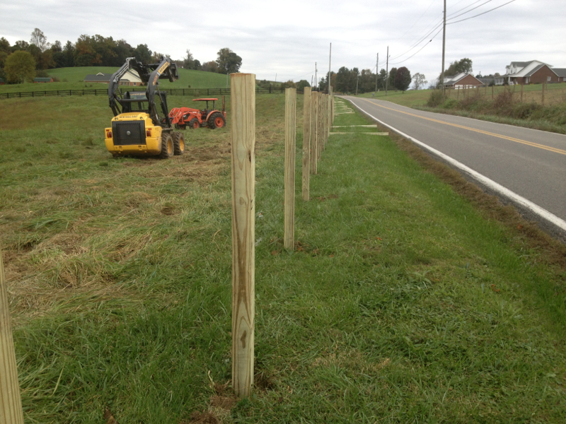

I've got the posts in the ground and ready for the boards in the morning on the first of three sections. I have one question for you all. How would you guys angle the tops of the posts in one pass (not half way from one side and the the remaining from the other) once they are in the ground? A reciprocating saw or chain saw will be too messy and my little 18v Dewalt circular saw isn't big enough. Will a full sized circular saw do the trick?
Here is a picture of what I need to duplicate.

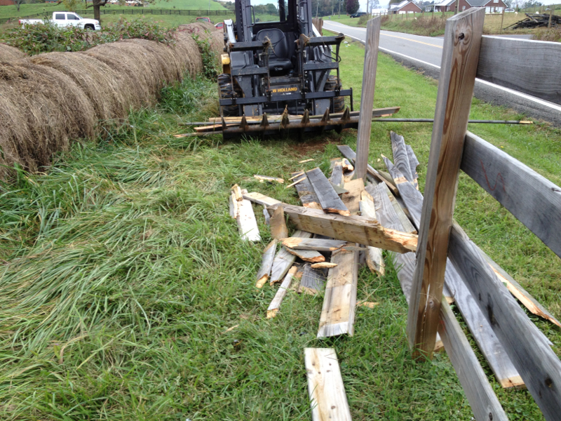

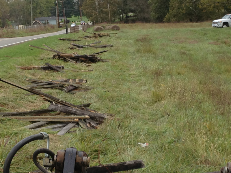

Out with the old.
The morning after we signed the agreement a woman ran through part of the old fence that was to be left alone.

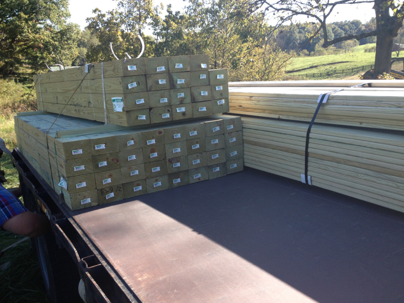

The first delivery of lumber.

Eight footers driven to just below my chin.​
