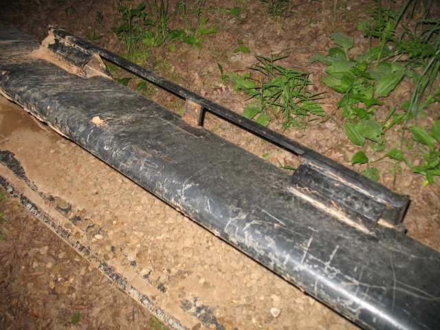

I switched 7TL over to Bobtach. I ground the pin plates off the old bucket and welded on a pre-made mounting frame. Only thing to be aware of if yours is Rhino built loader and bucket, the top of the mounting frame sets up about 6" higher than the vertical back of the bucket. I welded a couple pieces of angle from the top of the mounting frame to the bucket to give it a little extra support and makes nice spot for hooking a chain. (photo attached) The Bobcat built bucket has a taller back so the mounting frame will fit better. If not sure what bucket you have look at the holes in the cutting edge, if there a 2 rows of holes along the front lip of the bucket it is a Bobcat bucket and only 1 row it is Rhino bucket. The same Bobtach fits both the Rhino & Bobcat built loader.
You may want to contact Rick Wallace on here. Someone else asked this same question a couple months ago and Rick quoted him what I thought was a very good price on the Bobtach and new bucket.

thanks doxie, did you get the conversion kit from Bobcat? Do you remember what it costs? The top of your bucket looks pretty familiar.
   / Bob tach 7TL vs. pin on #9
I bought mine from the dealer last year. List price is over $700, probably closer to $800 now but I got a lower price since I wasn't in big hurry and they ordered it on stock order so no freight charges. I also bought the mounting frame from them at same time. I don't know what, if anything, is available in and aftermarket that fits this loader. I like the Bobcat one, it comes with new pivot pins and width between the cylinder holes is spaced to allow the bucket level indicater fit.
