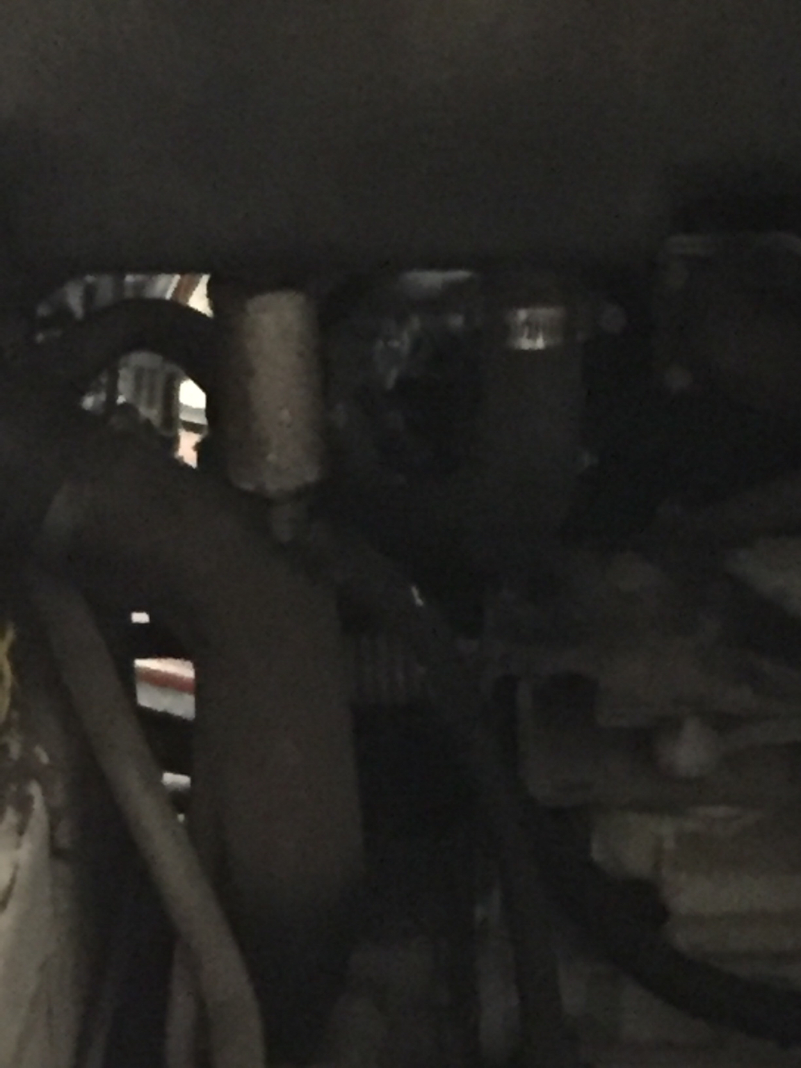

Where is the case drain filter located? I would assume the previous owner did not due much maintenance. I am going to change out and clean everything to start fresh. Just trying to figure out the hydraulics before I put new fluid in it.
   / Bobcat 753c overfull chain case #4
Case drain filter is a small metal canister in-line with the hose. Follow the smaller of 3 hoses going to the drive motor is the case drain, follow that hose back from each motor until you find it. One of these maybe fastened directly to bottom of the reservoir.

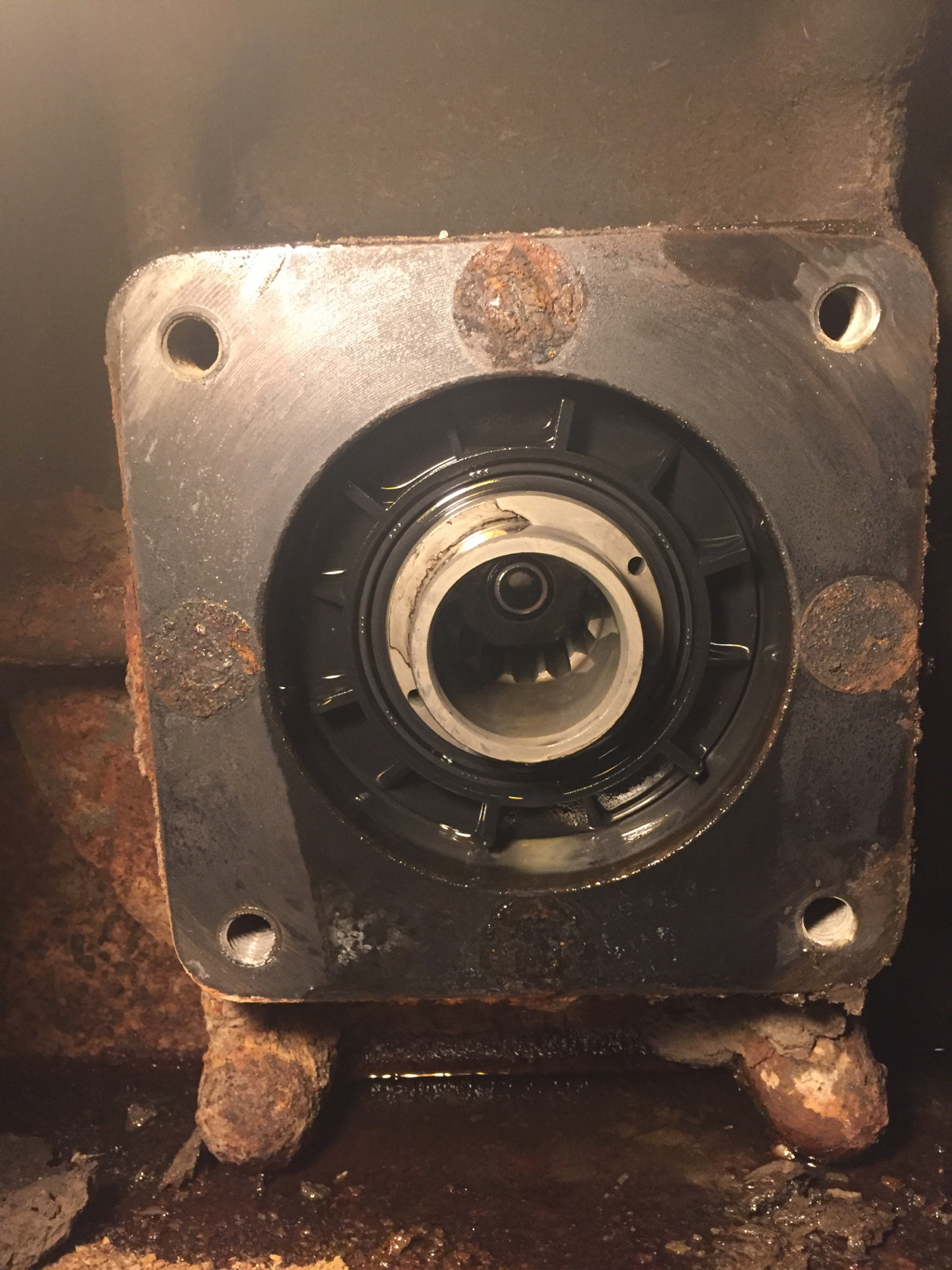

Update.
I put in a new case drain filter and filled the hydraulics. It worked great until it overheated. Stuck thermostat.
After screwing with that figured I'd check hydro oil. None in the tank. So it is leaking into the chain case with the machine off. I am going to drain the chain case and pull a top cover and try to see what side is leaking. I'll add oil and look for the leak with the chain case empty.
Found the problem. Bad seal
