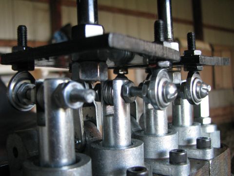

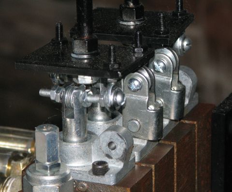

i have a older backhoe that has six control valves, two for downriggers and four to control the hoe, i would like to switch it over to the two wobble sticks for controling the backhoe, anyone have a sugestions on the way to get it done? can a guy buy the wobble stick controls and adapt to what i have?
   / bobcat backhoe #2
You can order the kits from certain manufactures. Someone one on TBN made his own joystick levers/setup. Here they are. There is a link to the build on this setup, perhaps someone can post it.
