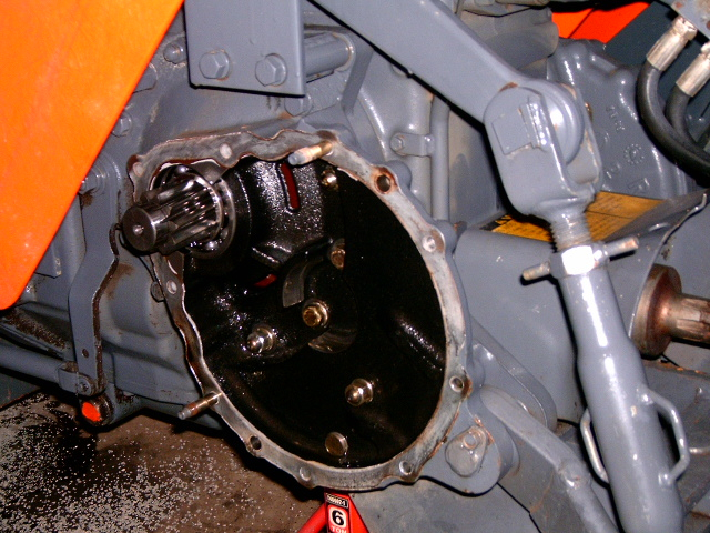

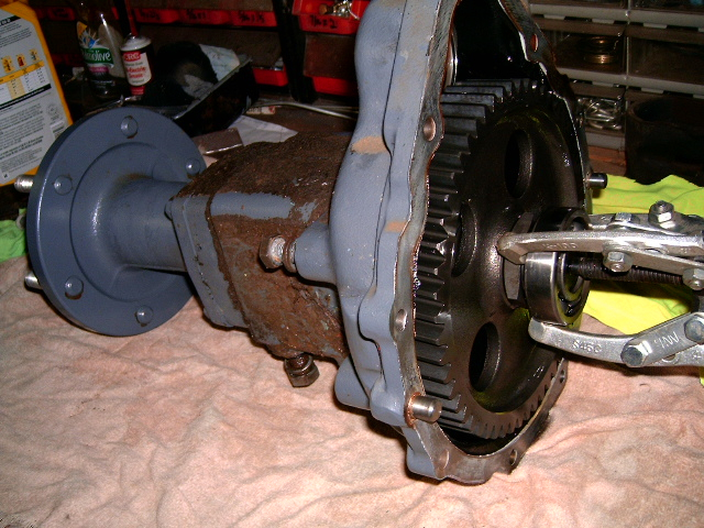

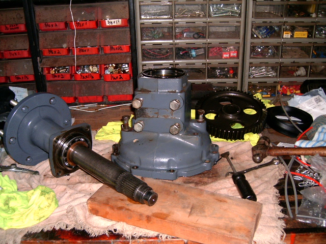

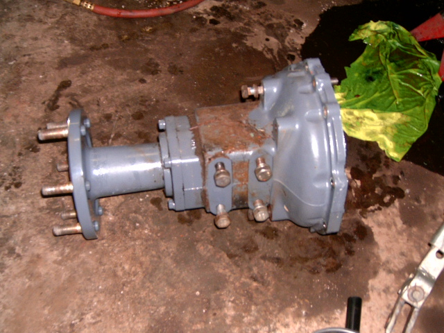

So— I’m assuming that there is hyd fluid in the case (hense the leak). Impressive that the case does leak w/out a gasket.
I replaced my left rear axle seal back in 2018.
No leaks on my axle case using the Permatex grey. (I did follow the directions on the gasket maker tube)
   / Bobcat CT 235 rear wheel hub seal leak #12
Lots of my mating surfaces on my Kubota's are gasketless too. I use a thin smear of 3 Bond anaerobic sealant and call it good.
#13
M
My axle case had no gasket.
I used Permatex Ultra Grey (maximum torque) gasket maker
I ordered my Oring and axle seal from Michigan Iron.
