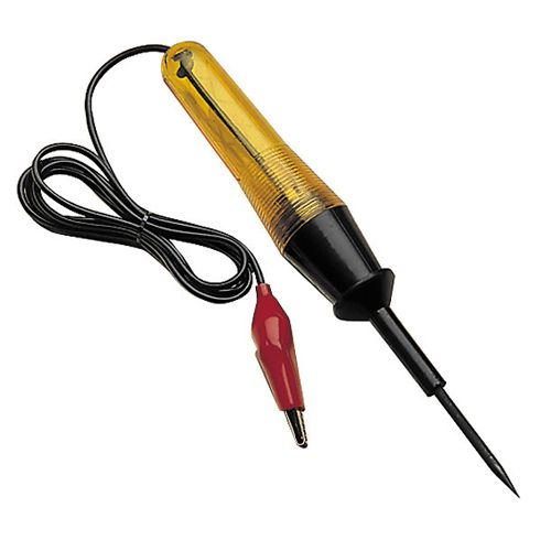

I have a BobCat CT1025 sub compact tractor with around 170 hrs on the clock. It is fairly well maintained however it has been just sitting around for about 3 months while I was in hospital. Just the other day I climbed back on board, got it up and going then went to use the 'clam shell' operation of the FEL and nothing .... And nothing ever since still no matter what I do ....
I have been over most everything I can think of from an electrical perspective. I also would have thought there would be a 'fuse' as part of a circuit somewhere but cannot find any reference to that anywhere either ...
Does anyone have any further advice / references for trouble shooting this.
TIA
Greg S
   / Bobcat CT1025 FEL 'clam shell' function will not open / operate ... #2
I suggest using a test light to check power at the valve. I also would look closely at the ground for the valve.
