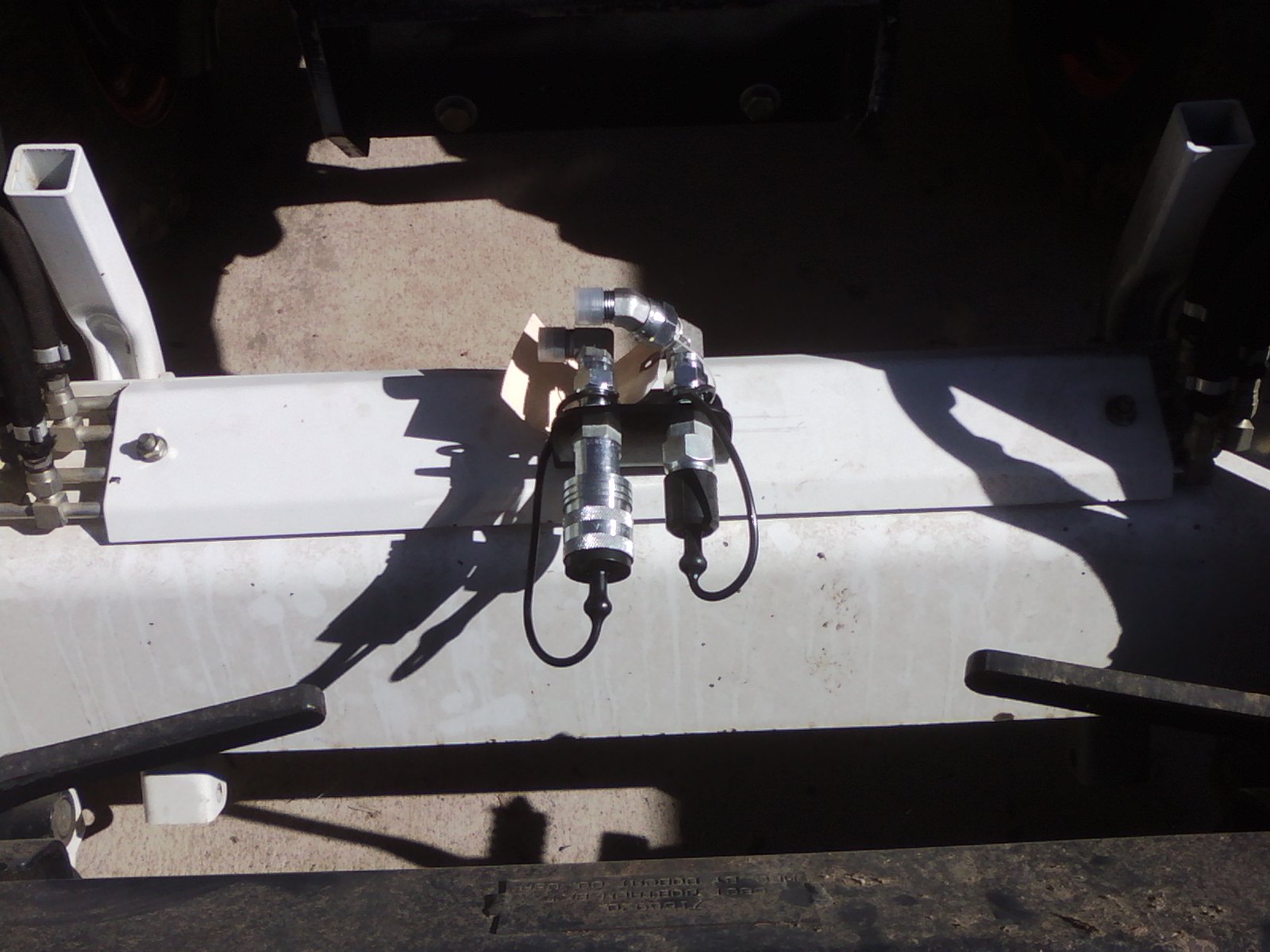

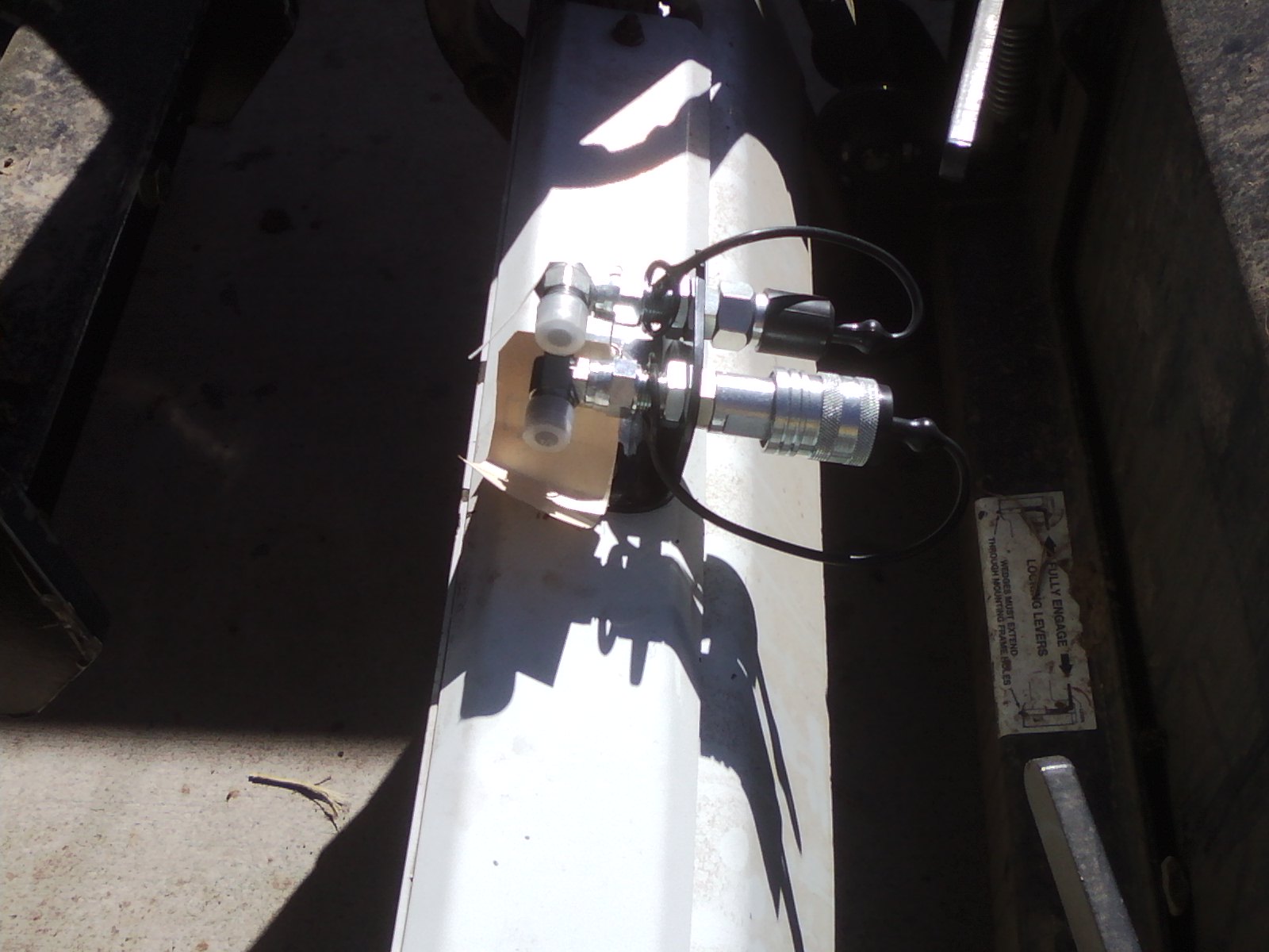

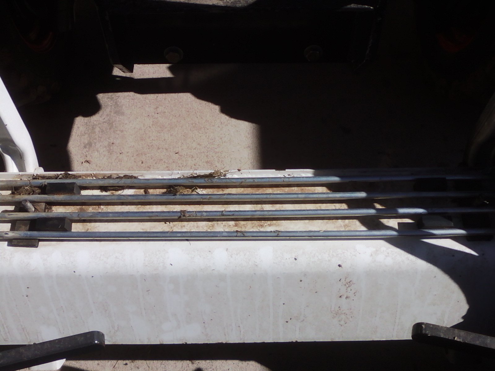

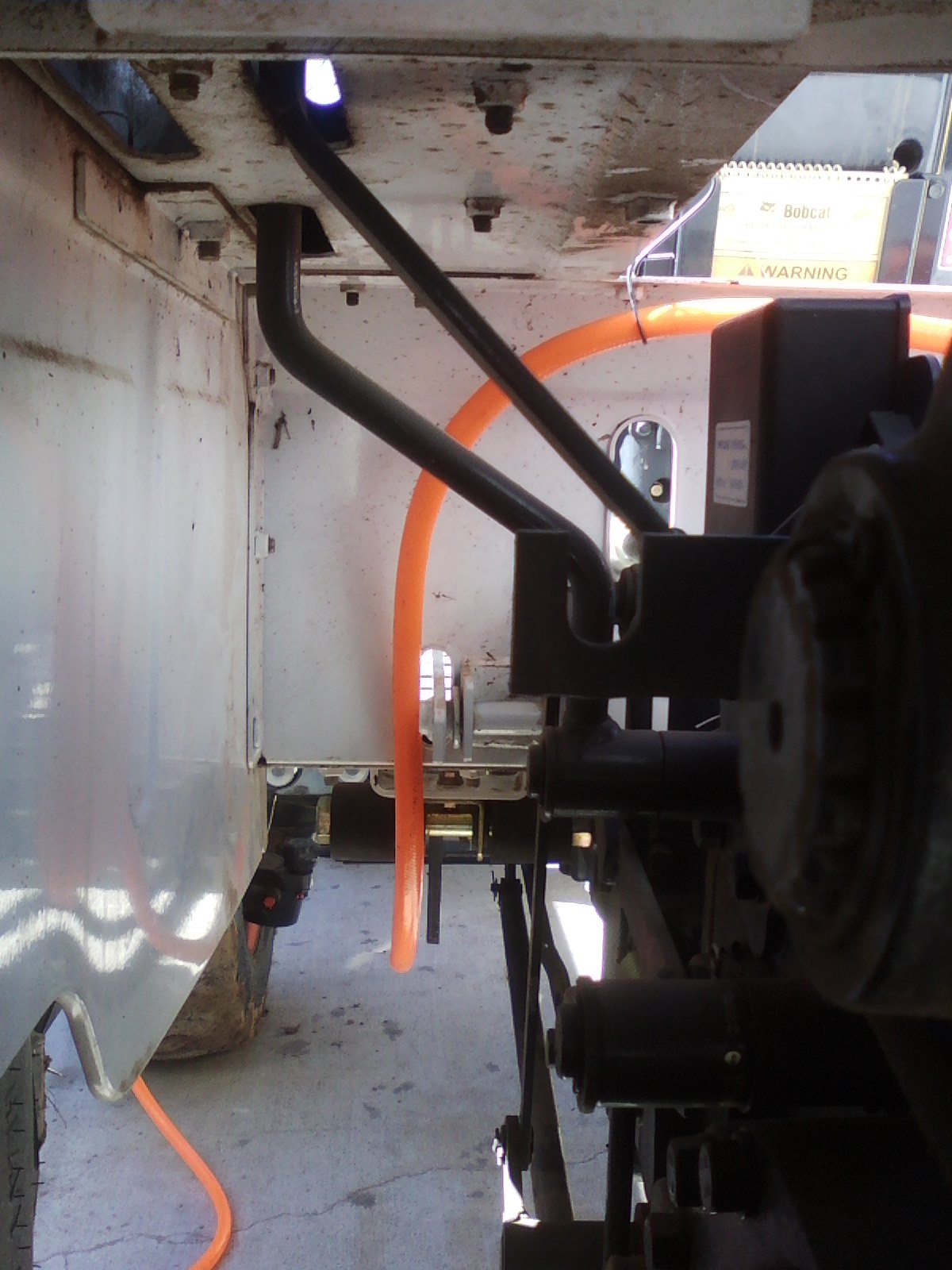

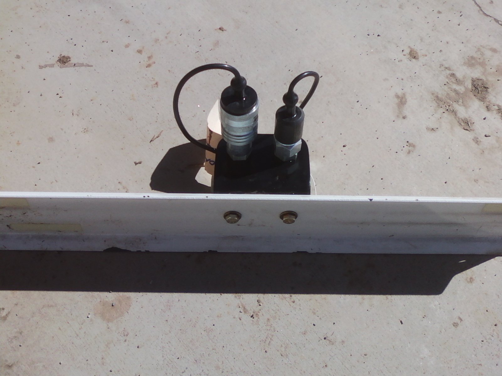

Well I finally got around to a bit of work today after the rain/snow the past few weeks. I am adding front hydraulics for the rear of my CT 235 to run a hay grapple. Some will say why did you not go with a 3rd function set up on the loader handle, but pricing made that a bit of a stretch for me.
First a lot of folks helped here answering questions and getting me pointed in the correct direction. J_J, SSDoxie and MtnViewRanch (aka Brian with Fit Rite Hydraulics) along with several venders were a great help.

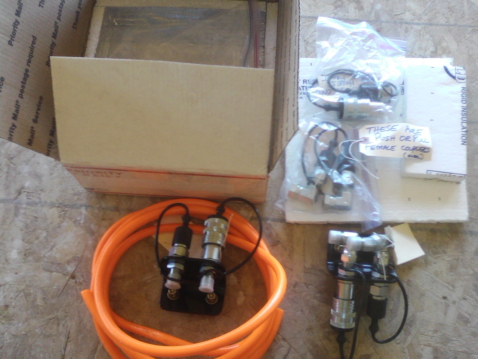

Brian set me up with a kit. I think it was a first for him on my model tractor and he has been great to work with. He first sent out the connection hardware and a section or orange plastic hose to get the hose lengths figured out.

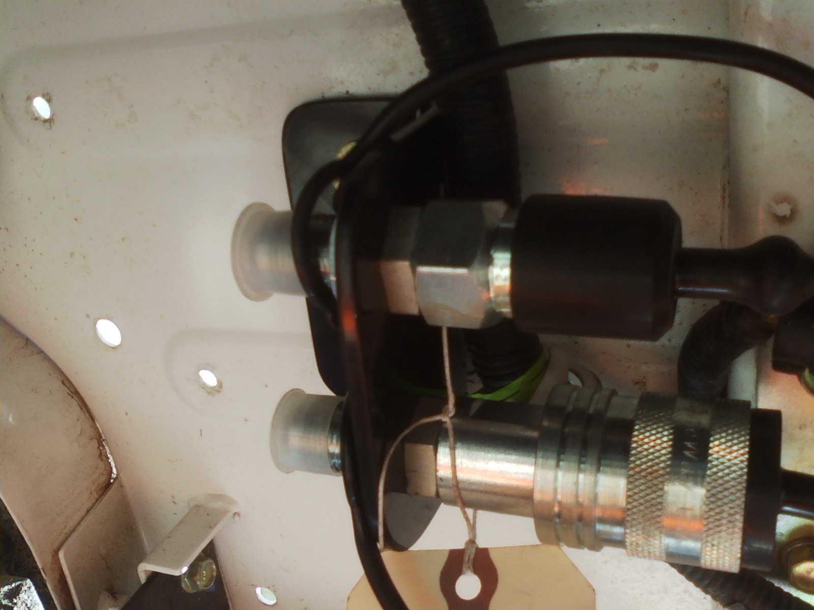

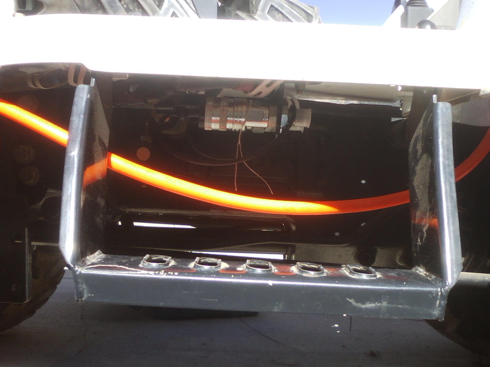

I then went about finding a place to mount the mid point dis-connect and settled on the left side under the floor board.

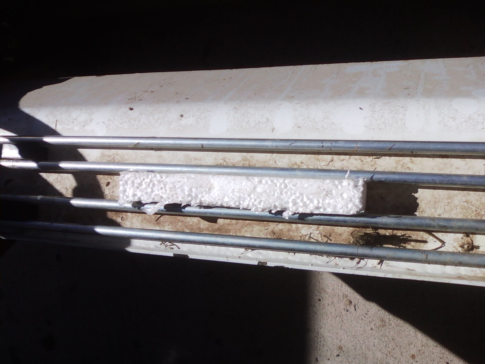

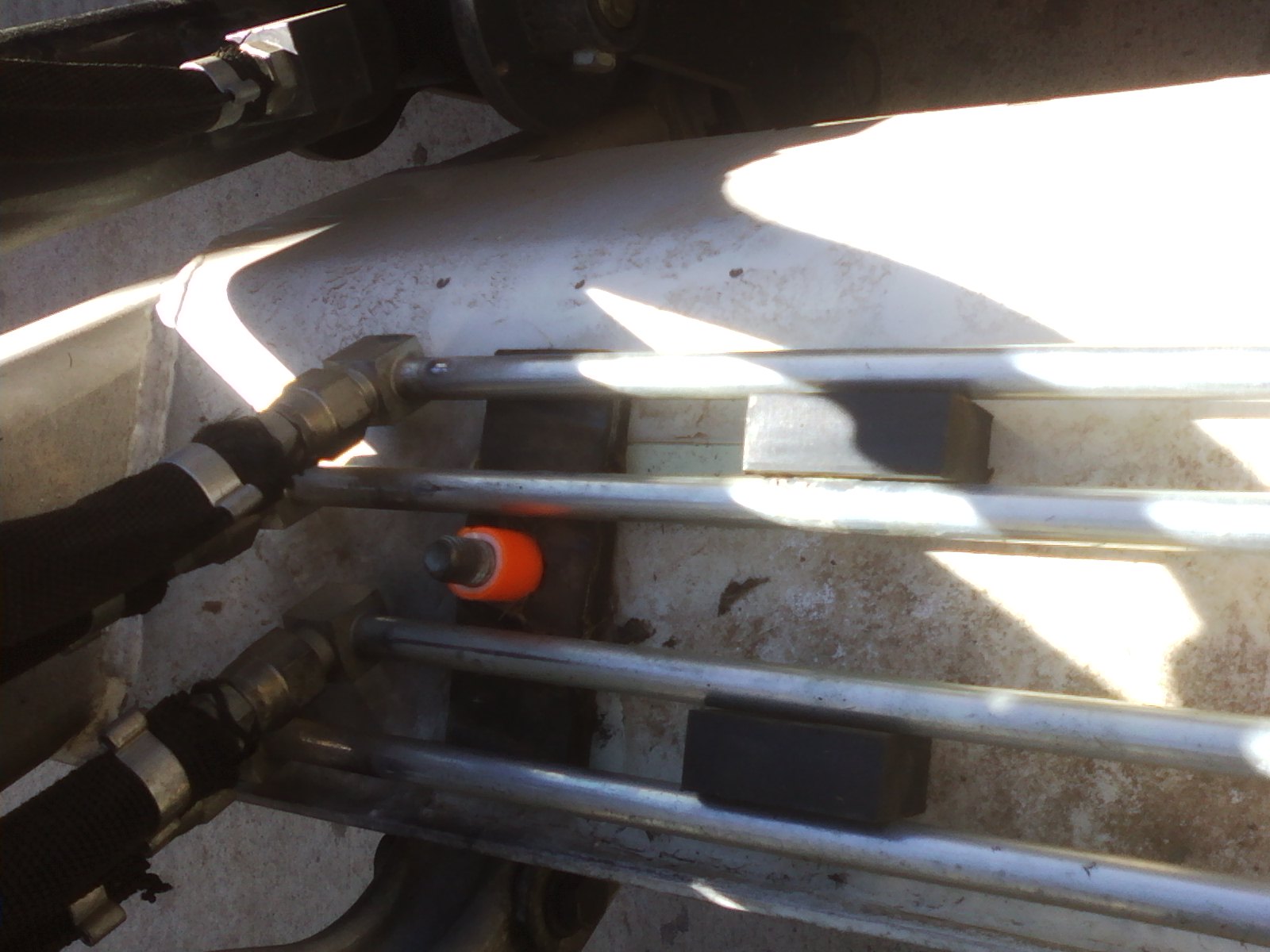

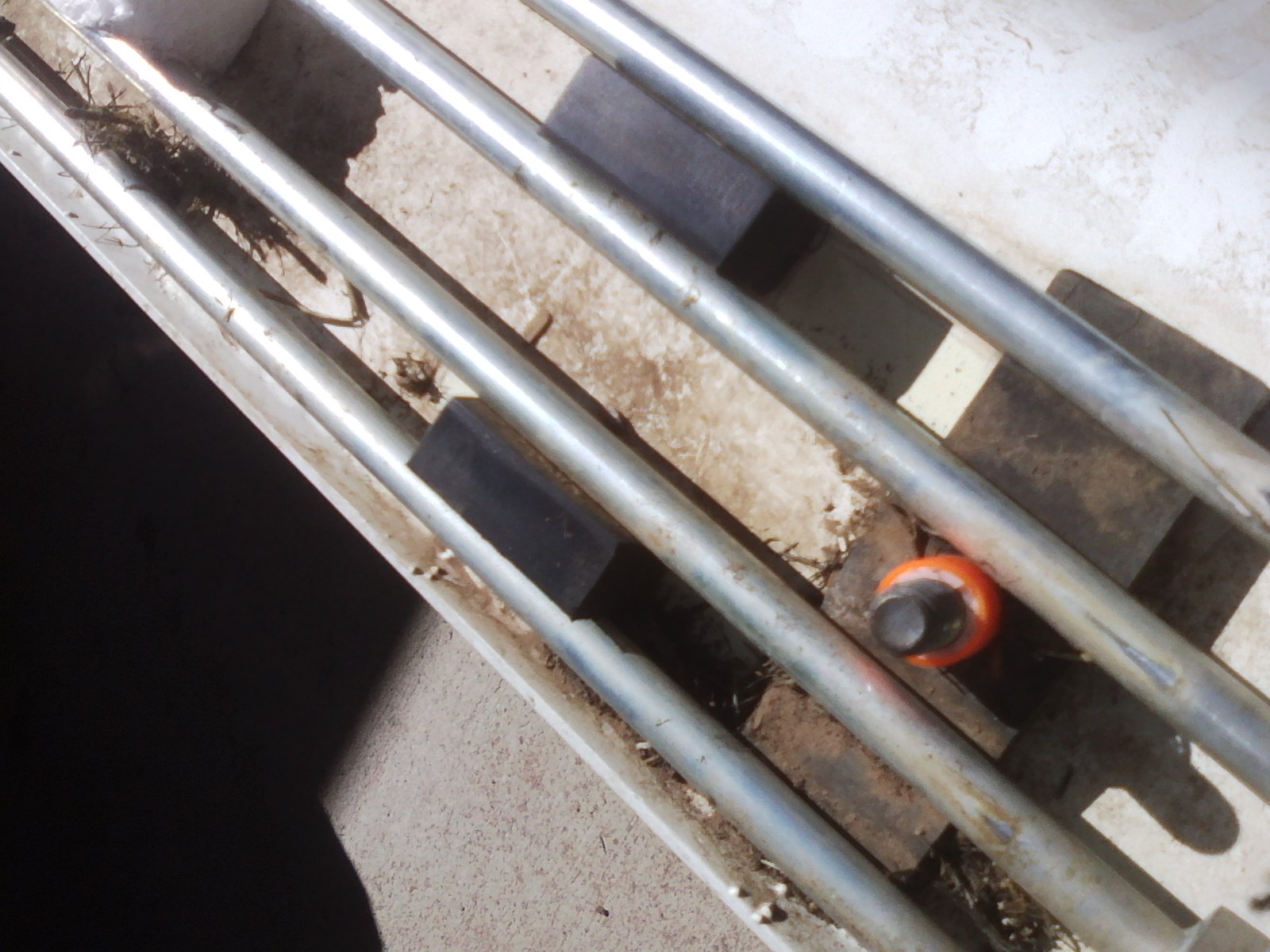

Once that was in I install the front mount on the loader cover plate, making sure the bolt heads would not contact the hard lines by using some foam as a spacer. I also cut some of the orange rubber hose and protected the lines from the cover mounting bolts.
Next on how I ran my hoses

Sorry about the extra photos on the first post. I am still learning the ins and outs of attachments.

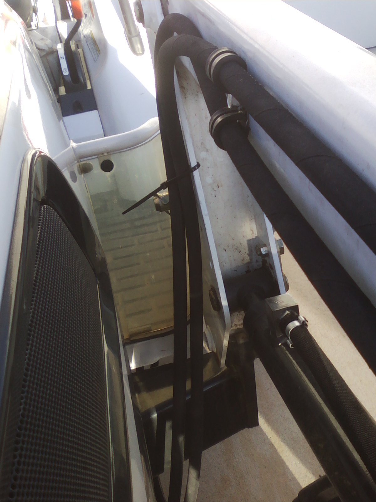

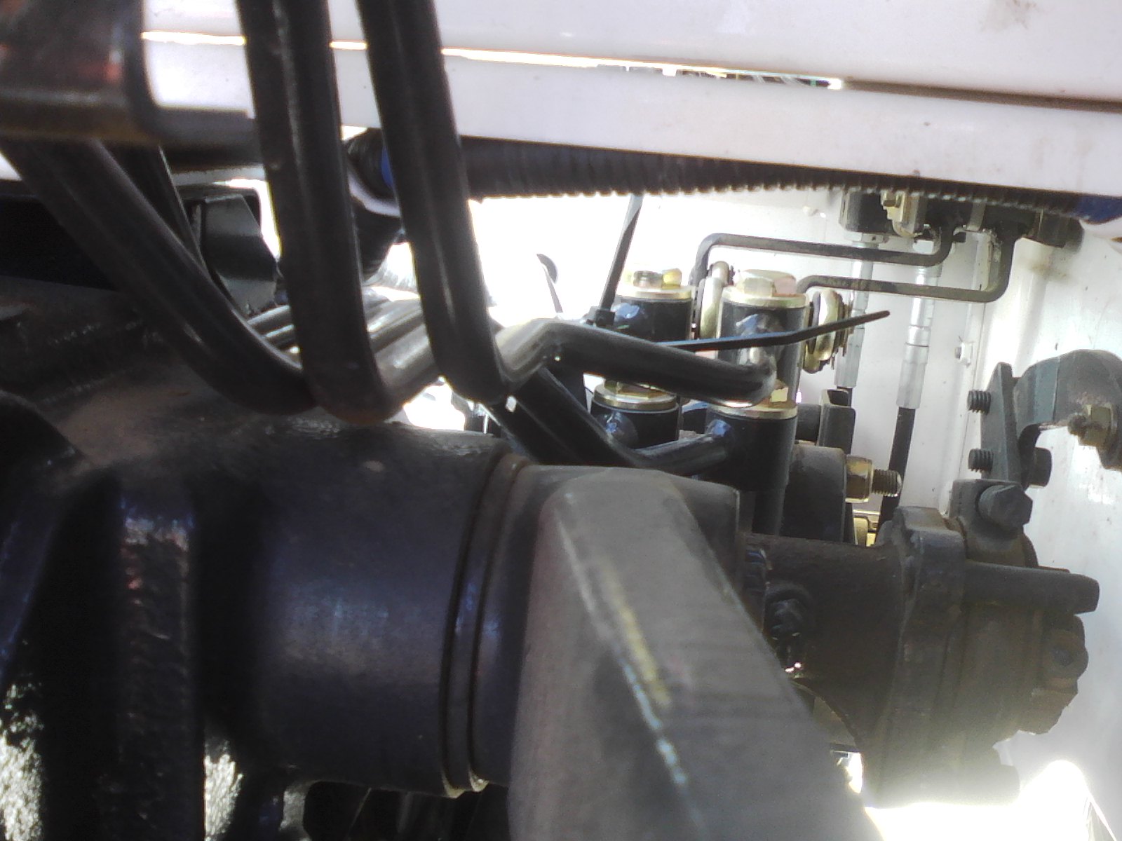

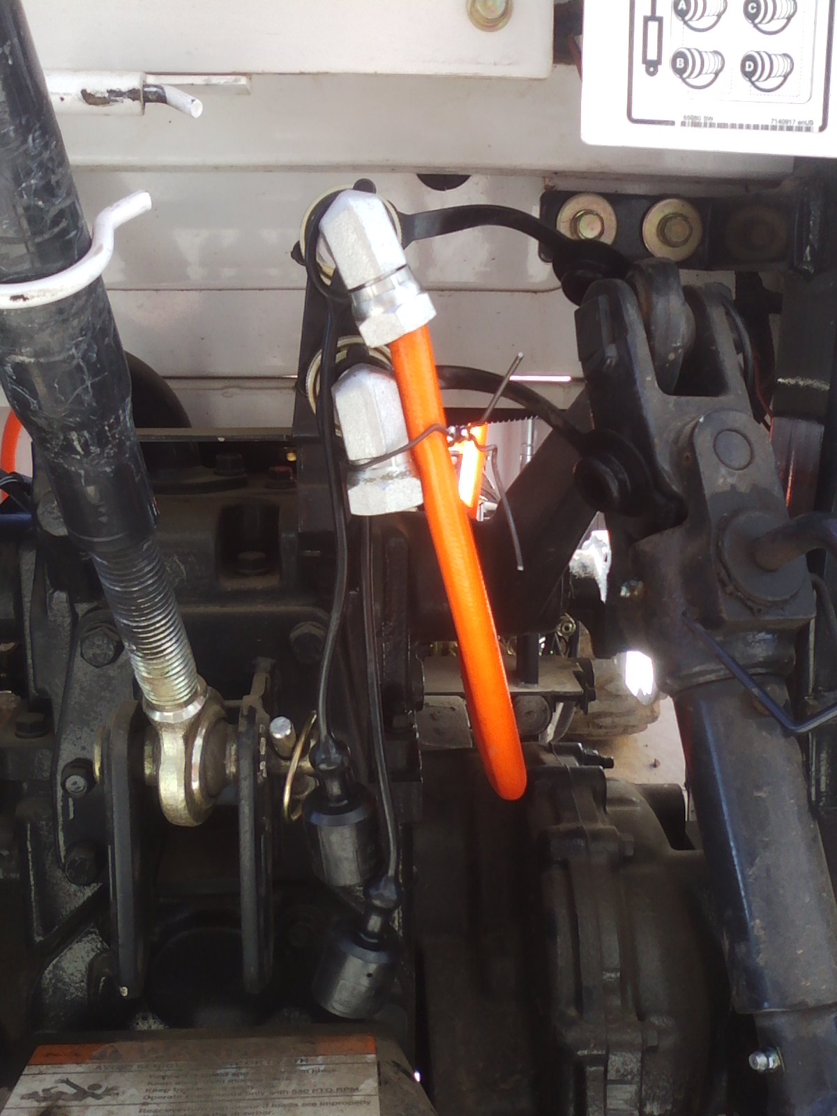

Knowing I wanted to go up the left side I first tried using 90 degree fittings and going sideways behind the top link, but not enough room.
Brian gave me a hint, and I determined I could run down and forward, looping under the 3pt lever housing, then coming up and over the trans and down to the left side connection. Using the orange hose supplied I made the run and determined the hose lengths.
I also figured out I could use a lot of the existing panel bolts if I just used longer ones and a second nut below the original welded capture nut.
Once I had all the hose lengths determined Brian sent them out. only took him a few days and they are very well made. Everything I needed was included.

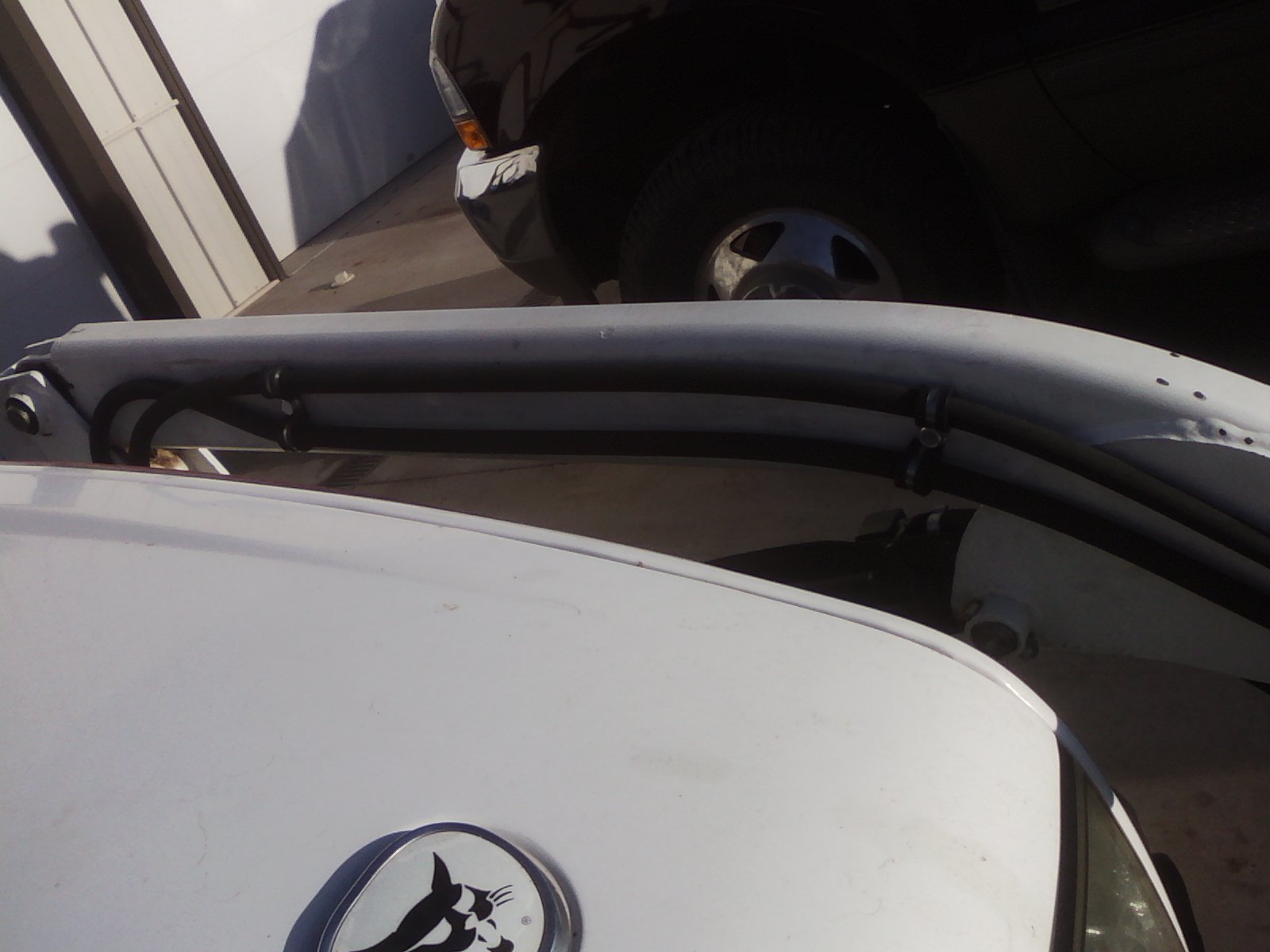

I installed the front hoses today, and drilled and tapped 5/16 bolt holes on the loader arm to capture the hoses in rubber lined stainless steel clamps.
Tomorrow I will be installing my second remote valve that has the float, and then running the remaining lines. I did check the front line with full lift of the bucket, and I may need to lengthen one about 2", but I will do that later if needed. Right now there appears to be clearance, but the zip tie location on the rear loader post needs adjustment to prevent binding. I wanted a nice snug fit to prevent any snagging of the lines.

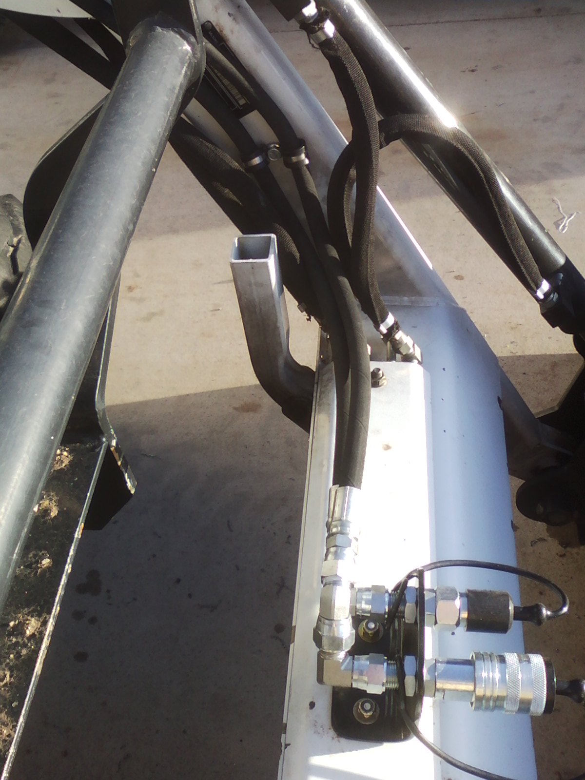

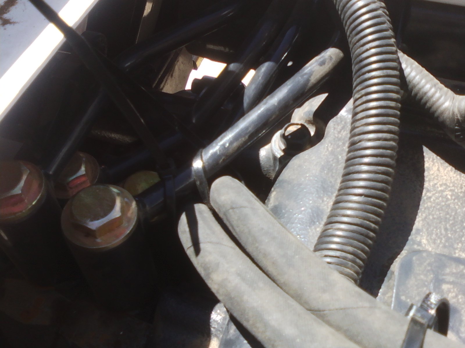

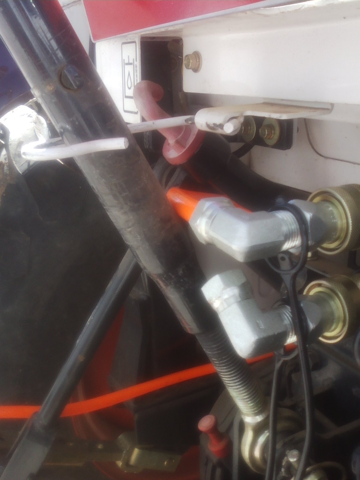

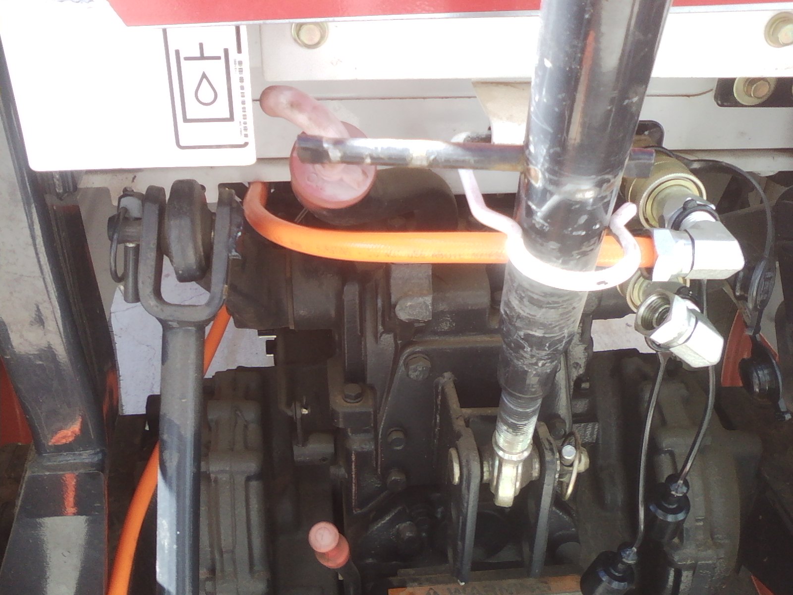

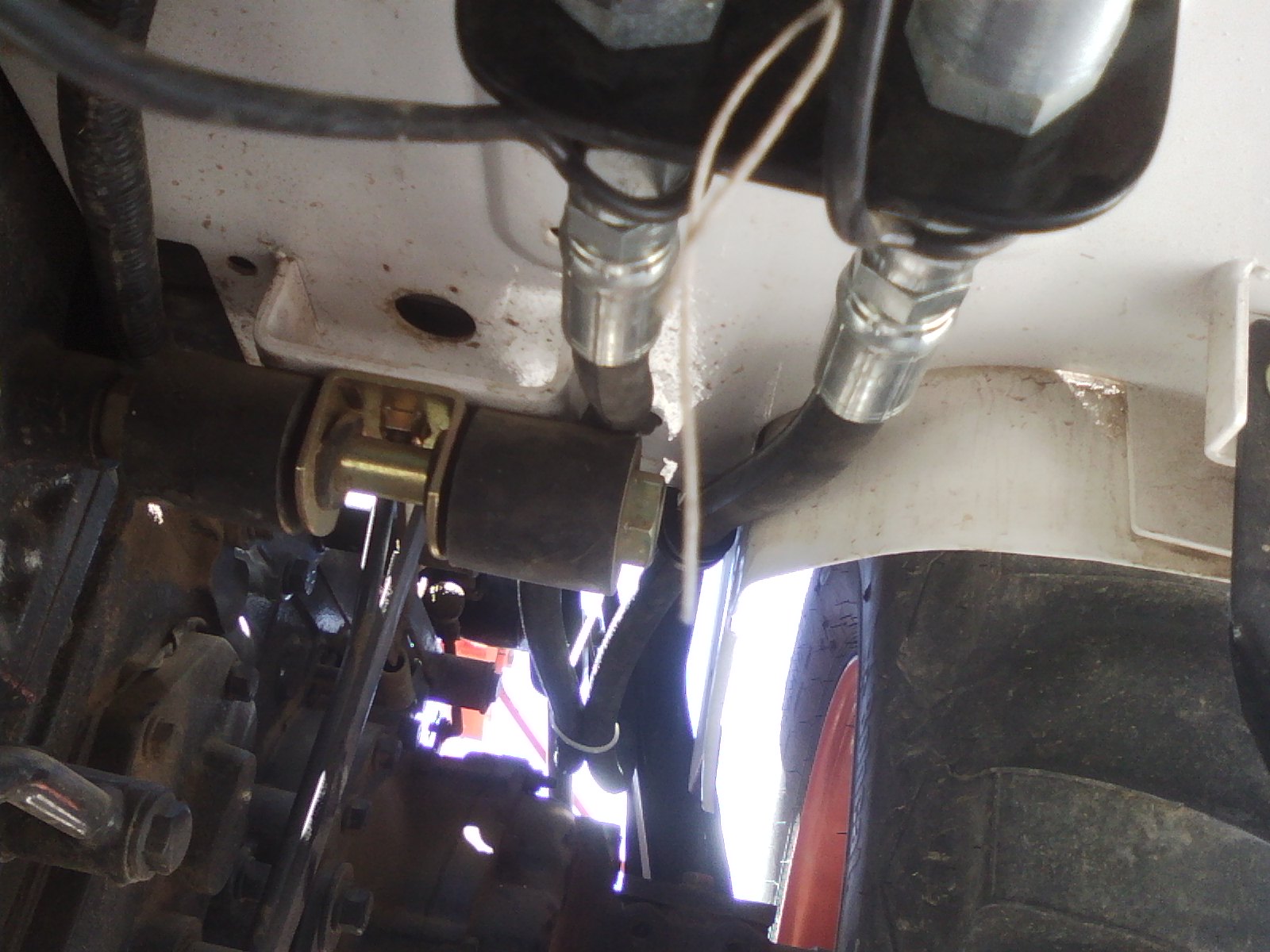

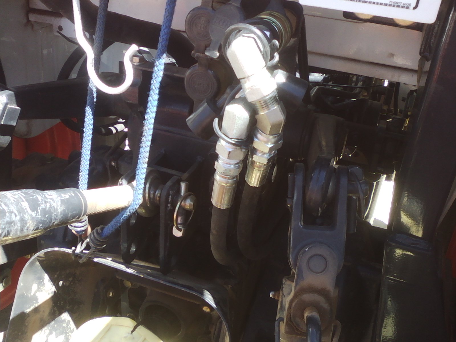

Well I finished up the install today. First the Kioti second rear remote kit # 322027with the float valve does fit and worked. Dealer had no problem with the install, other than having to cut a spacer to fit. Its is a good thing that I had the valve installed before finishing my line install, as the fit was tighter than I estimated. No worries as I found a better path.

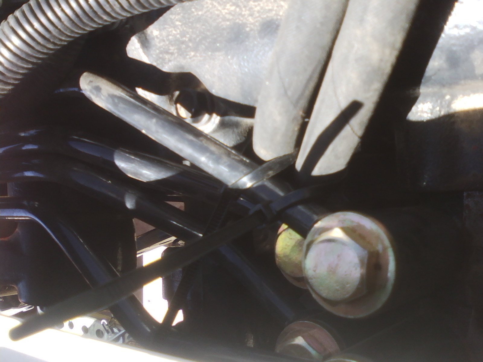

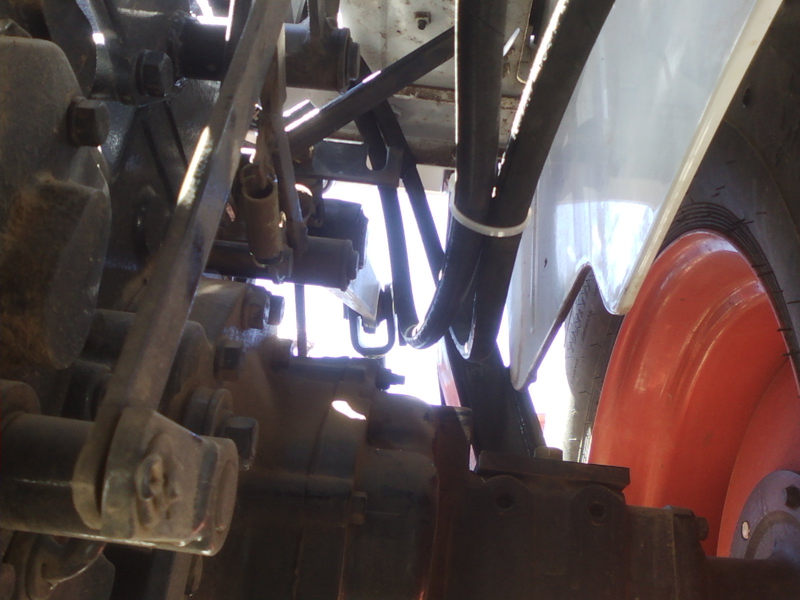

I uploaded the photos, but don't seem to ba able to move them around. I started at the back (4th from left) went under the 3pt link arm and came up inside the remote valves against the transmission case (photos #6 from left, 1st on left and lower left). I zip tied to the rear remote hard lines to hold in place.
From there I crossed over the trans to the left side of the tractor and zip tide to a cross member near the rear and came forward to the connection under the left side step (2nd and 3rd photos). I used two hose clamps about 1 foot back of the connection by extending and existing panned bolt.
Other than one leak everything worked as planed. I attached and got my hay grapple working (see post in Hay Forum)
I do need to lengthen the hoses previousy installed up front to be able to utilize max lift - I just miss measured.

Regarding the mid mount, did you just drill through the floor and let the rubber floor mat cover the bolt heads?
Thanks again.
   / Bobcat CT235 Front Hydraulics Install
I'm trying to think if the holes were already there, but yes I did pull the floor mat (lifted and taped back) to get the holes drilled. When I did my 3rd function install I did not change anything from the mid point bulkhead forward. I did drill and tap holes on the loader arm for the hose clamps.
PS: getting the mat back down can be a pain. I had to use soap and a soft blow hammer to get the tabs back in their holes.
