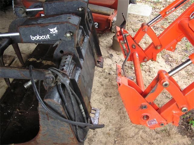

For those new buyers looking to buy a FEL an option that may come in handy in the future is the "bucket skid steer type quick hitch". In just a few minutes I can switch to a Bobcat implement.
picture#1

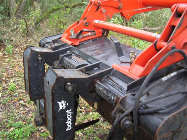

Picture #2.

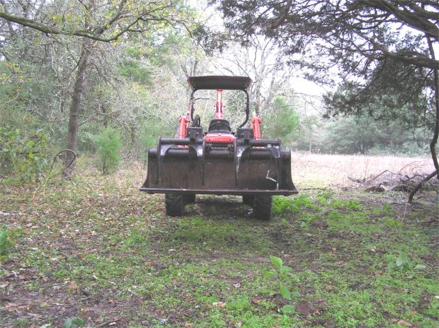

Picture #3.

txdon - Is that grapple a Bobcat brand?
   / Bobcat does fit Kubota "Quick Hitch"
Re: Bobcat does fit Kubota \"Quick Hitch\"
Scout, Yes that is a Bobcat 5 1/2' grapple bucket. I just bought it used and all it really needs is paint. I am going to attempt to run hydraulics to it. I'll post a thread on how I run the hydraulics, hopefully in a couple of weeks. It is really easy to connect just tilt the loader arm "pads" and raise the loader and tilt the pads back and then lower the locking handles plug in the hydraulics and you are ready to go - about 20 seconds.
