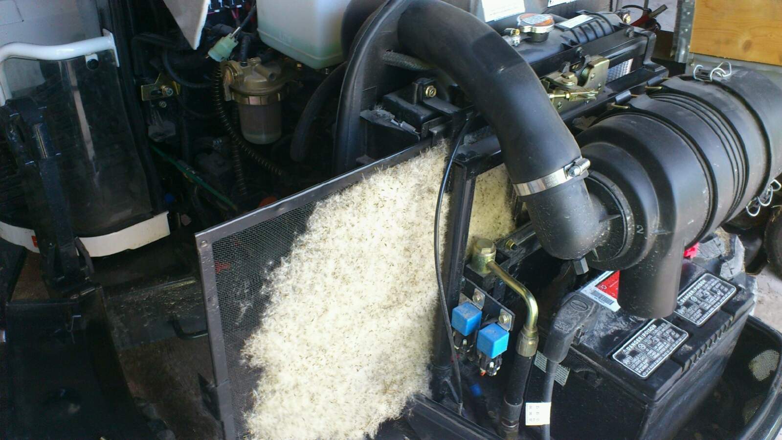

After 2 hours cutting my neighbors 3 acres of field with a 48" RC, it grew this horrible moustache! :D NOTE: The rad screen and hydrauLic oil cooler were just as bad.

I have had similiar issues here, just try to keep an eye on the temp guauge to make sure you still flowing enough air
/ Bobcat...moustache? #3
I over heated my tractor to the point of boil over, Now I go back to the barn to blow out the screens... every 30 minutes or when I get thirsty!!!.

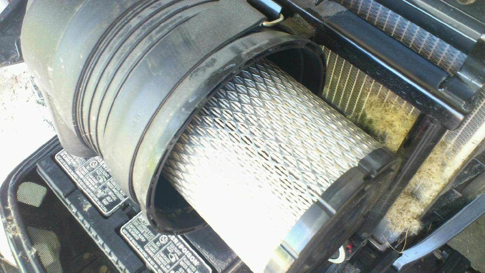

Here is a shot of the rad screen. The other day I did my own slightly larger field and the entire surface of the hydraulic cooler was covered as well.
attachment.php
On the plus side, the air filter showed no evidence of intake
attachment.php

/ Bobcat...moustache? #12
attachment.php
attachment.php
