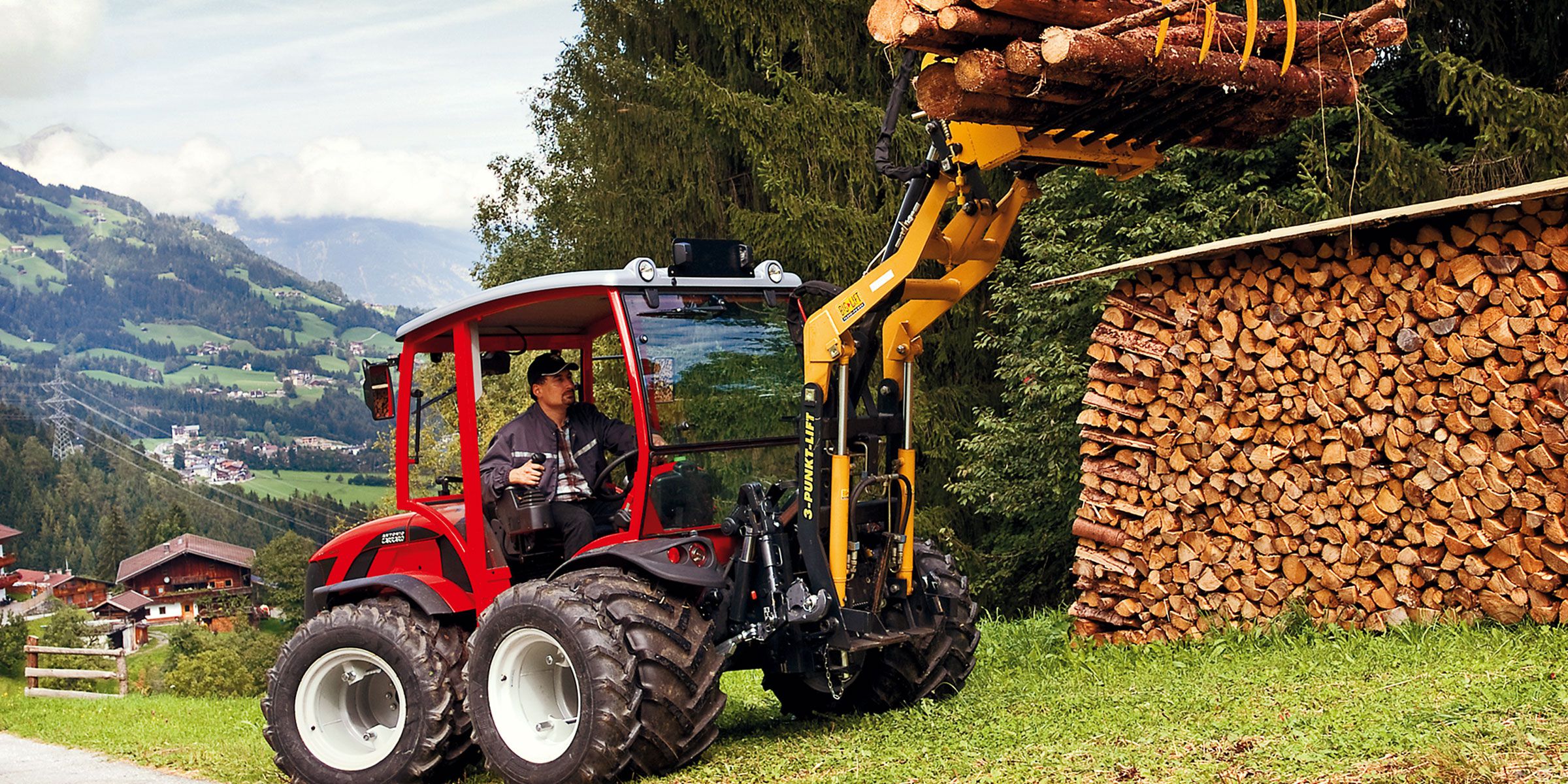

BCS is not bad but I would rather go with Antonio Carraro. It's far superior and have been in the market since at least the 60's making this style of tractors. I do live in a area where this style of tractor is used a lot and I've told that BCS is a much cheaper version, although it does use Kubota engines I believe. I also have checked both in person and the differences are noticeable. I almost ended up with a AC tractor instead of the Branson.
Antonio Carraro is indeed sold in the US. They make tractors from 30 to 100 HP, both articulated steering or regular front axle steering. The main advantage of these style of tractors is that they make some models where the operators platform is reversible, so you're facing the back of the tractor with all the controls handy and it's ideal for mowing. Specially with a reversible flail mower (where you can attach the mower from the back as well).
They come standard with front and rear axle lockers. They have options like 3 pt down pressure, 3 pt suspension. Loads of remotes available. The way it pivots (basically the front half of the tractor) makes it very nice and stable on use on hills and uneven ground with a max of pivoting 15コ angle each side.
Also comes with a common feature in the Europe, which is to PTO modes: one is the regular mode linked to the engine and the other is linked to the diff, so it matches the ground speed. Used a lot in powered trailers that have a diff.
Lower HP models use Yanmar engines while the higher HP ones use Kubota engines.
There are loaders for it but I wouldn't recommend. It's just not the style of tractor to put a loader on it. The mounting is weird, reducing the lift capacities and it has a long nose. Rear 3 pt loaders are used much more on this tractor than a front loader. Again, the reversible feature makes it very pleasant.
