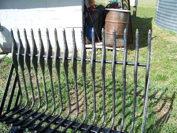

I think a rock bucket would do you good when used in combo with the landscape rake.
Windrow watcha' can with the rake then come along with the rock bocket after windrowing to pick up rocks. the rock bucket will leave the dirt and sift out the rocks.
Here is a pic of mine setting on end, Thought I had more pics but mine is spaced 3 inch between tines, wich means rocks less than 3 inch will fall threw with the dirt also.

I have a rockbucket for my 110tlb with 3" spacing and it works okay for the larger stuff. The problem is if the spacings are close enough to get em all then it is hard to sift the dirt out of them.
I have considered setting up a rock bucket with closer spacing and adding a hydraulic motor driven shaker to it. Haven't found the time to try it yet.
