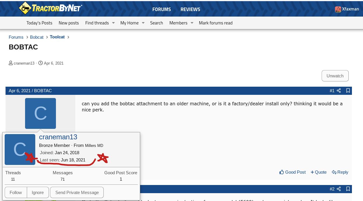

   / BOBTAC #4
Might not get an answer:
Putting the pointer over the Avatar shows when last on TBN.
