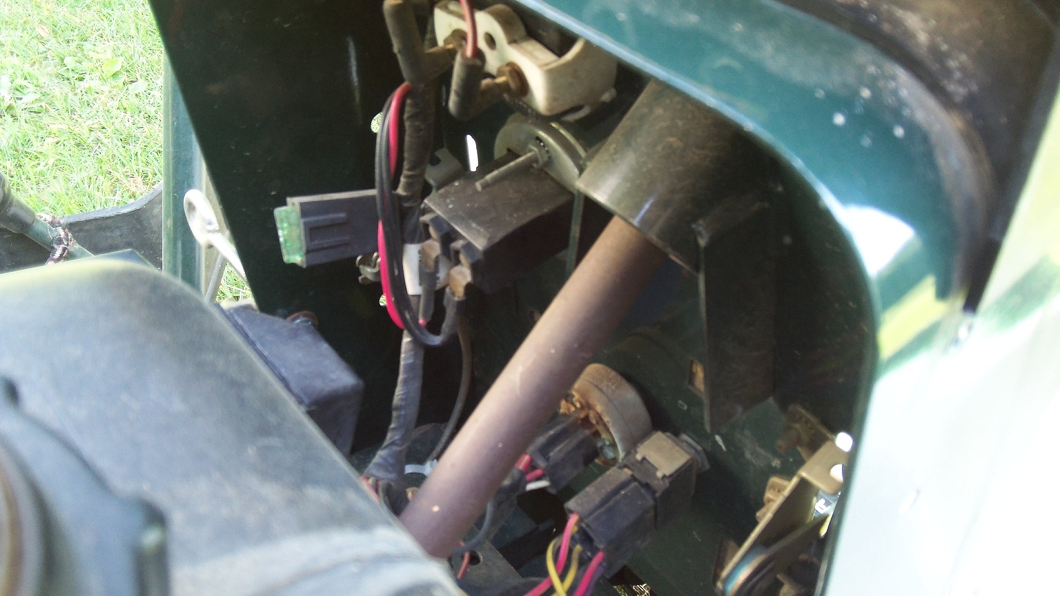

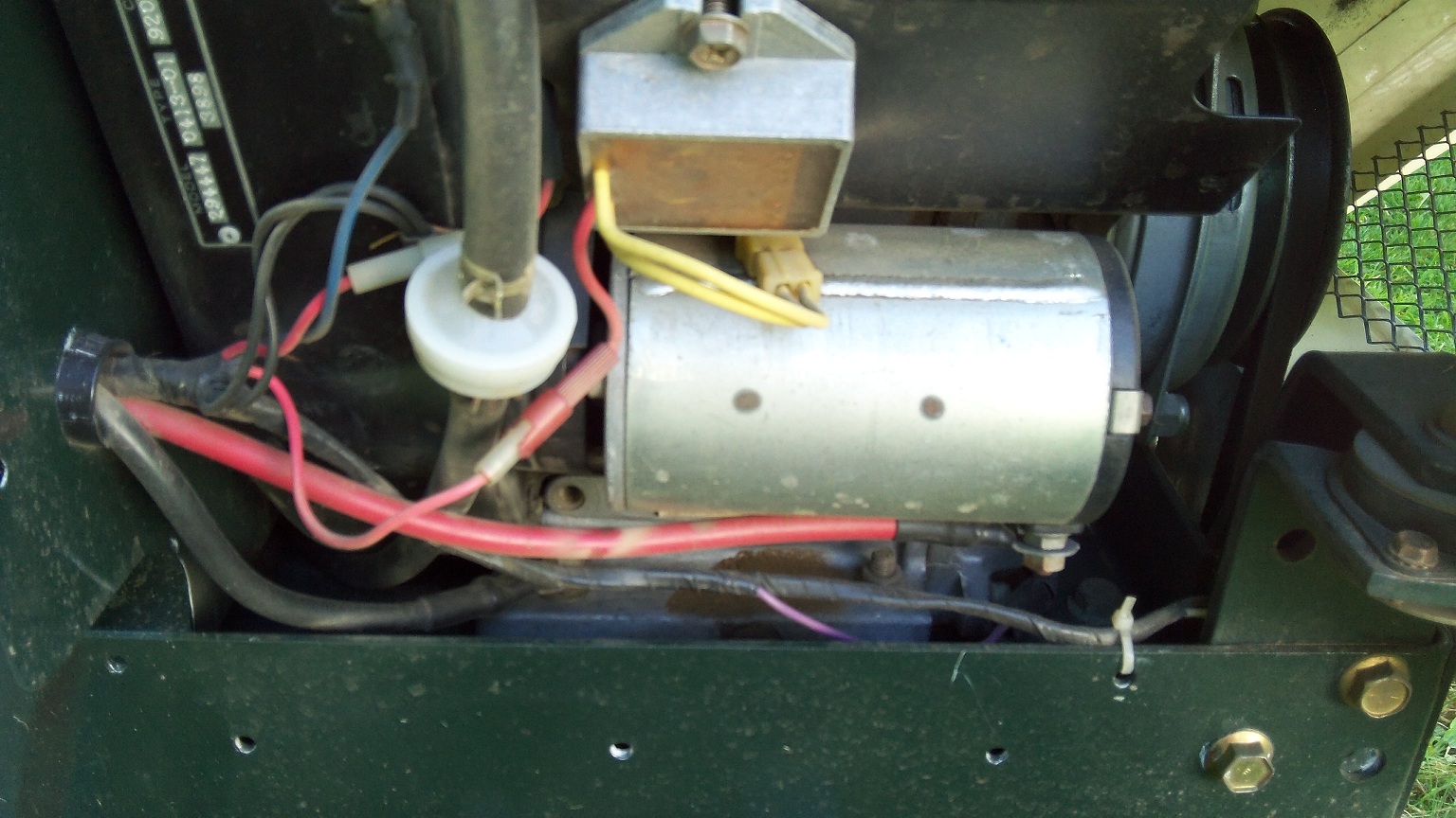

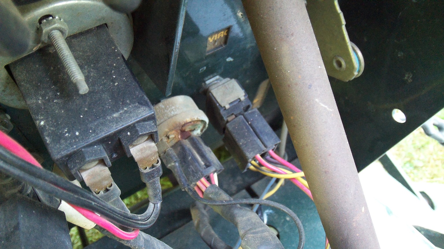

Not sure if this will help you in anyway,but I have attached these pics for you to look at.I also have a 1468 and thought maybe the photos would help in some way.If you need any more pics I will get them for you.
