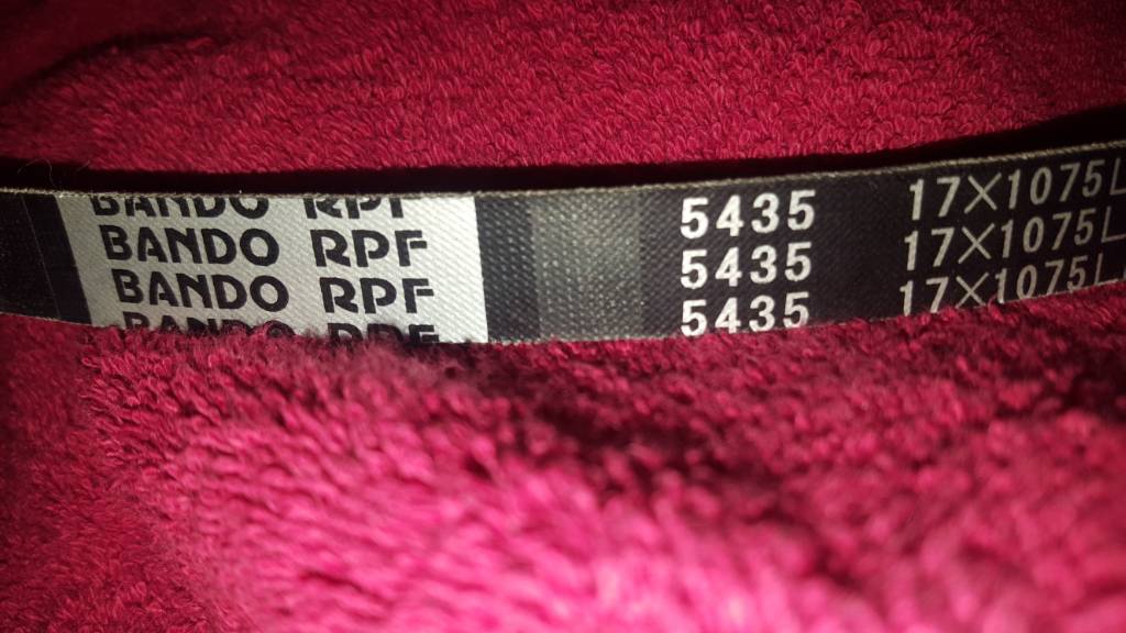

For the record factory belt is a Banco 5435.
   / Bolens Front PTO (1308) belt size #3
Did you mean Bando 5435? Looks like that's a 17mm x 1130mm belt. Thanks for following up :thumbsup:
Yes, Bando.
This is the belt.
