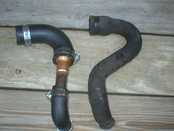

I recently got a price of 100.00$ plus shipping for a lower radiater hose. This tractor has an isuzu 2cylinder diesel engine rated at 19 hp. That sounded a little pricey to me so I started looking for alternatives. Attached you will see a hundred doller radiater hose next to a 14.00$ hose assembly.
I went the local auto zone and the counter man let me have at his hose rack. I left with three hoses and headed for the plumbing supply. It works great, I guess time will tell.

Thanks for the picture. Very nice adaptation and one that I am sure will last.

Nice thing about that intermediate copper tube piece is that it's a good place to install a threaded fitting for a temperature gage sensor.

Whatdaya think? will it hold up?

Heck yea it will work. I didn’t want other Iseki owners to panic when they saw a $100.00 bottom hose :). They way you fixed it is exactly what I would have done to get up and running. Good job!
   / BOLENS G192 #8
That is really creative! Good job! Nothing like thinking out of the box! This would be a great solution for people with orphaned tractors they cannot get a hose for as well...
