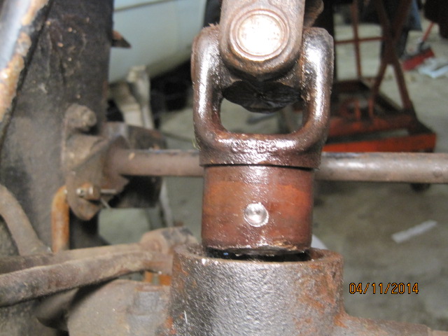

For the past 6 months I have tried to remove the main drive shaft (motor to hydrostat rear tranny). I had posted a tread before because the u joint closest to the engine snapped. I am now trying to remove the rear most part of the drive shaft as it articulates with the hydrostat tranny. I have tried every form of rust buster including KROIL and even tried heating very carefully so as not to fry the hydrostat seal or the aluminum casing. As best i could tell the locking screw had been removed but iI drilled down to what appears the AL of the hydrostat shaft. I have tried beating with every size wedge to loosen it to no avail. I am reluctant to apply more heat but I really don't know where to go from here. I have provided pictures of the connection. If only a gear remover was fashoned to do the job or would a small hydralic wedge jack be applied???
Anyone have any suggestions???

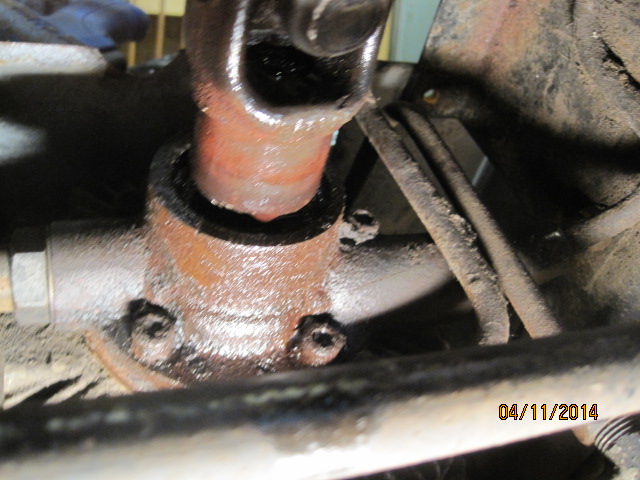

Hello: Me again. I have had no replies in the past week or so. In the second picture, I have over drilled the set screw hole to insure all of the ?set screw was removed. I then drilled this hole thru and thru.
again after a bath or rust buster and Kroil oil , it won't bulge. I guess I'll have to try and heat again but set up as much of a heat shield so as not to disturb the hydro stat tranny mechanism. Any other recommendations. How does one dis mantle what I call a "cold weld", if this is what occurred?

It looks as if heat will be the only way out. I'd make a thin piece of plate and cut a "U" out of it so it'll slip over the shaft providing you have enough room which may not be he case, it might keep the direct heat off the seal. Have a bottle of water ready to douse the shaft when it comes apart and be sure to have a good size acetylene torch for heat, that way it'll get up to temp fast and hopefully not have enough time to soak into the shaft/seal area, and keep turning it. ......Mike

I would not heat it, heating it will make it hot, it wont move it, I would use a wedge, like a small chisel or pry bar and a brass or rubber hammer, even better a hammer drill with a blunt edge to knock it loose. I've taken these off before, the challenge isn't teh same as a steering wheel, the challenge is you cant get to the place i which to work on it. I never use heat if I can help it.

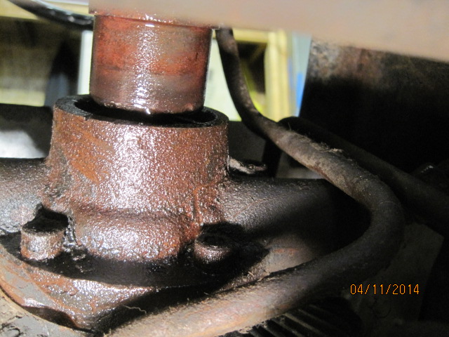

oologahan: thanks for the response. I was finally able to get the darn coupling loose from the tranny input shaft. I had to stand the tractor up vertically, after draining out all of the engine oil. Working from the plate in front of the seat as well as from underneath, I and a friend beat against the shaft and yolk with every type of chisels, crow bar and some of the worse language I have ever used (in silence of course) as well as every rust buster and even Kroil but no success. I even drilled out the set screw and over drilled the hole to insure nothing could still be holding it up. I also used cautious heat but no success.
What finally helped was the use of a pickle fork and a massive hammering. It did fracture a piece of the tranny housing lip which held the lock ring. We wer able to get it half off, then I had to heat it but I packed sand and a license plate cut out to act as a heat sink and I finally got it clean off.
Since the universal joint on this tractor is no repairable and not replaceable, I tried contacting Sonny's Bolens but something is not well there in Indiana. I finally ended up at our local Fleet Pride and they were able to use the remaining shaft and replaced with a Spicer universal joint. Now of course the reassembly will be a challenge and I'll let you all know the out come.
