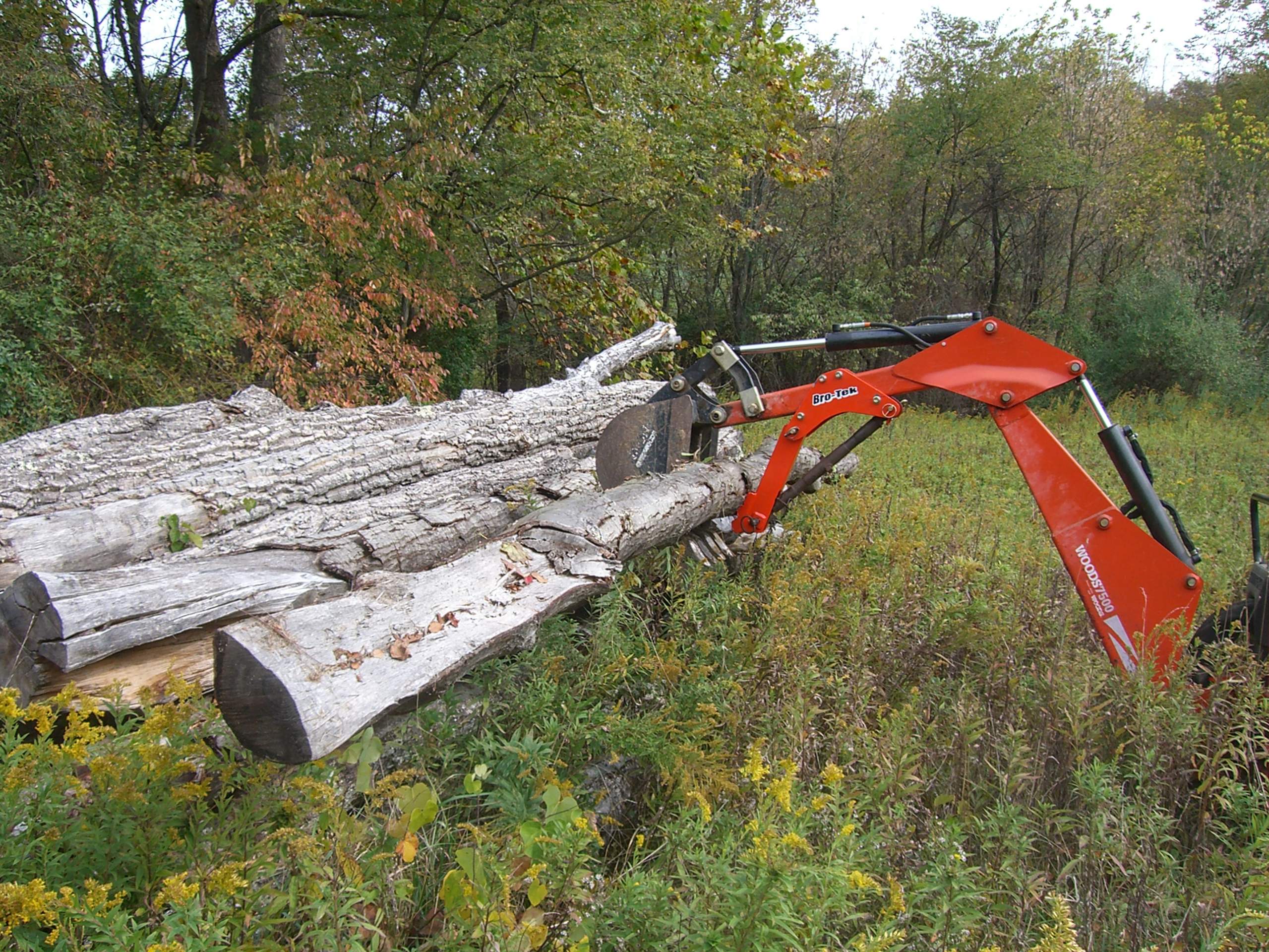

Just rec'd Bro-Tek thumb, took several weeks from Canada to Maryland. Unfortunately, because of a mixup in the model #, I have to drill two additional holes in the mounting plates. The unit looks like high quality and Richard @ Bro-Tek is very good to work with, offered to send new mounting plates. I only wish I had discovered the Thumb years ago, would have saved me a lot of effort in wood and rock handling. Anyone considering a Thumb should Google Bro-Tek thumb and watch the videos on how it works. This thing is going to make my firewood handling a lot easier. I have it mounted on a Kubota L2500.

Google, Bro-Tek: Tractor Add Ons, check out the complete website, watch the video and then buy the Bro-tek thumb. I just bought one a few months ago and have been using it on a L2250 Kubota, primarily to lift and hold logs while cutting firewood. This thing works like a charm, no mor bending over with the saw and no more cutting halfway through a log thn trying to turn it so you can cut the other half while keeping your chain out of the dirt. This thumb is a bolt on taking only minutes to install and there is no need for hydraulic hookup, the bucket provides the hydraulic clamping power. This thumb has reduced my cutting time by at least 50%. If I was smart enough to load pics on this site I would show my rig in action with 25' logs. The Rep at Bro-Tek, Richard, is great to work with. Check around on the Forum for older "Thumb" comments, there are many. Good luck.

I originally posted I had rec'd the Bro-Tek Thumb but had not really tested it, well, now I have. This thing is great. Check out the pics.
