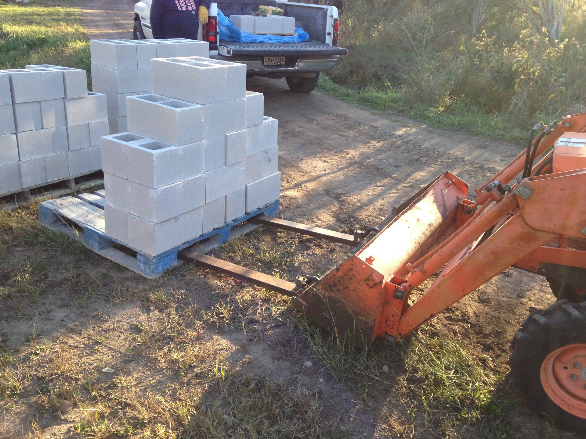

I built a small 'pallet fork' thing out of a conveniently u-shaped c-channel assembly I picked up for free. I added factory tow hooks from a Jeep SUV to make it hang off a 3pt hitch frame i already had. Then i found out i could kinda hang it off a bucket, but it seemed like a bad idea. Well, i did it anyway, and over time of lifting heavier and heavier things i found out that as long as the load is near the base it will pick up near 1000lbs. I used it last weekend to unload a 700lb backhoe attachment off my buddy's trailer. I actually think most of the cheap clamp-on forks out there are still WAY better than this. So i would say, yes they have their place.

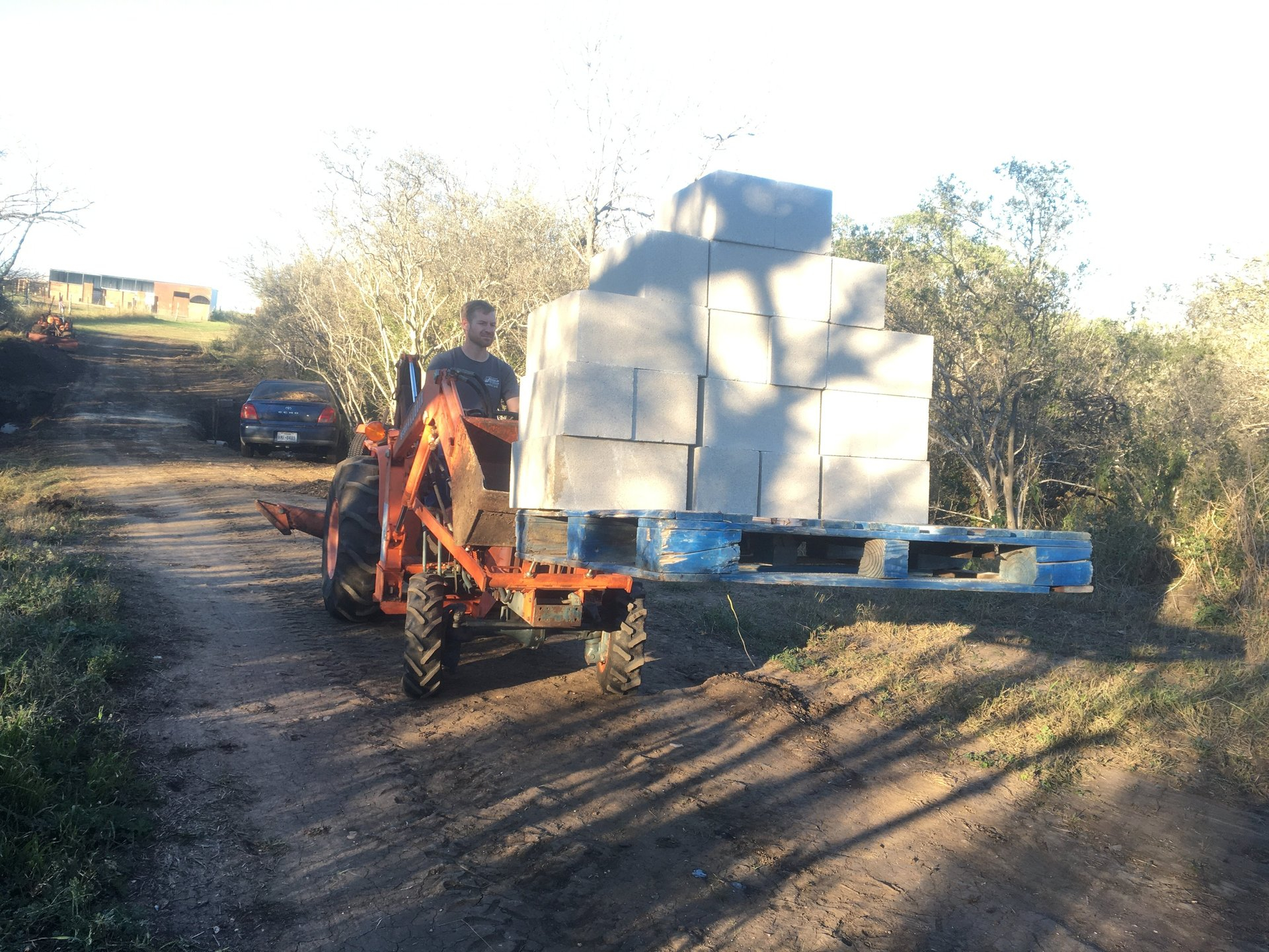

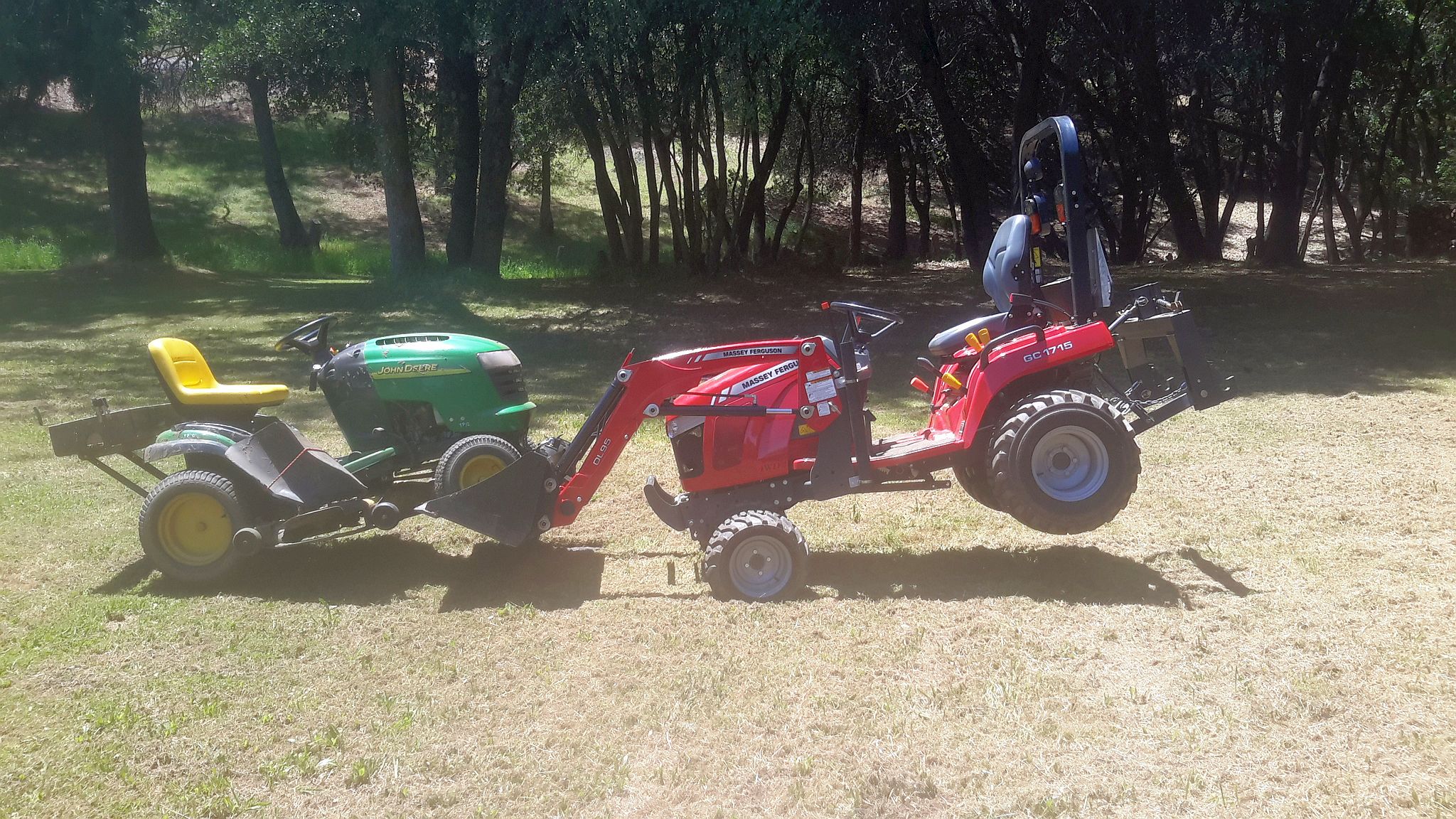

Definitely need counter weigh is and serious lifting with FEL
20190513_134020-jpg.678087
20190513_134501-jpg.678088
And no pics are not photoshoped... There is low bumper on JD (that you can not see) that wedges under lip of bucket... And JD weights in at 520 lbs. according to JD documentation
