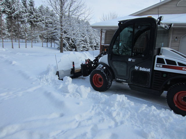

I have a 2019 5610 with a 96" Bobcat v-plow and a Bobcat SB240 72" snowblower. I planned to float the boom while using these implements on my mile long dirt/gravel road with a high crown and plenty of twisting, undulating terrain. But, I just read the manual - Bobcat does not recommend boom float for anything except leveling loose material while driving in reverse. I'm sure the concern is boom damage.
I do have the flotation kit on the v-plow, so it floats laterally (left and right) 10 degrees, but not up and down. The snowblower is fixed, no flotation any direction.
Anyone plow snow with the boom in floating position? If so, seen any issues, good or bad? As a newbie, is floating the boom even the best way to do this?:confused3:

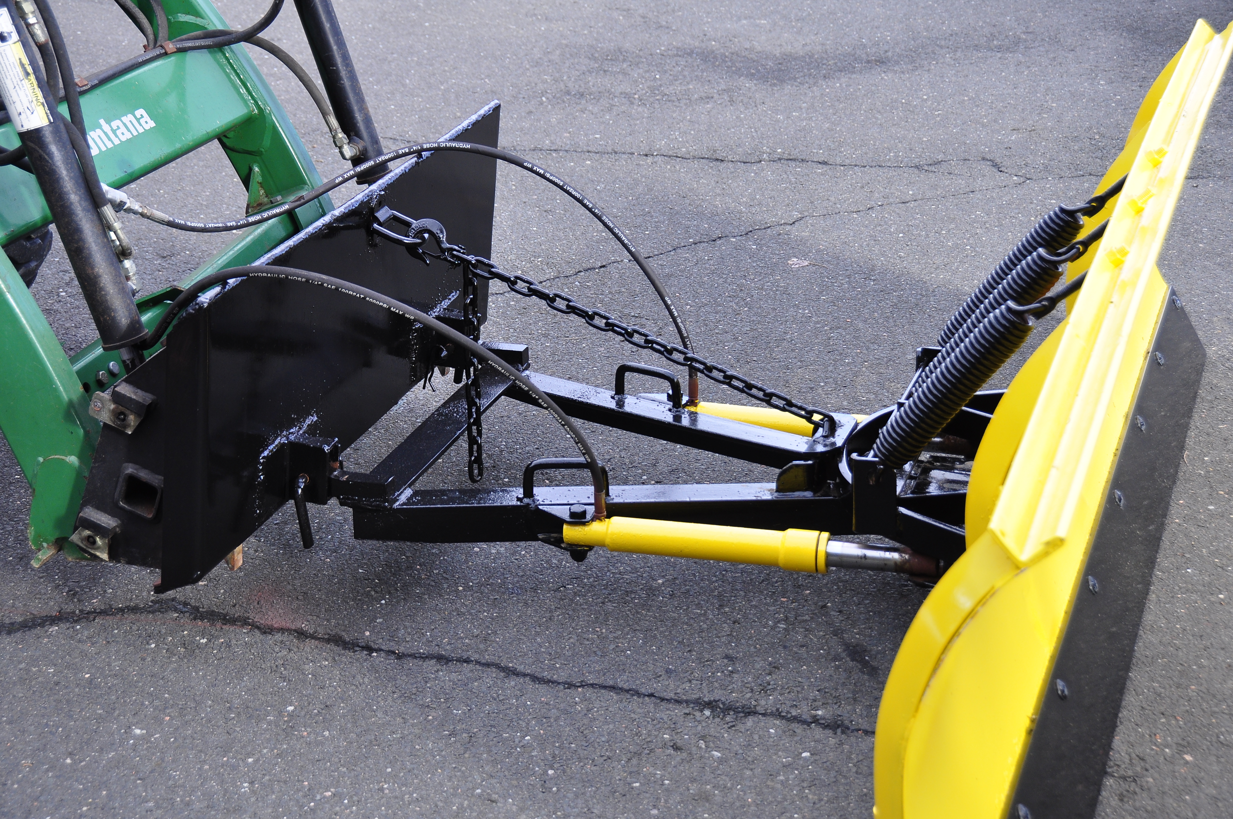

My plow has a chain going from the top of the quick attach plate to the plow frame. If I tilt the plate forward, the chain is slack, and the plow floats. I do all of my plowing in float like that. I keep the loader arms about 12" off the ground. If I need to pick up the plow blade, I tilt the plate back, and I can quickly pick up the plow, much faster than picking up with the loader arms.
