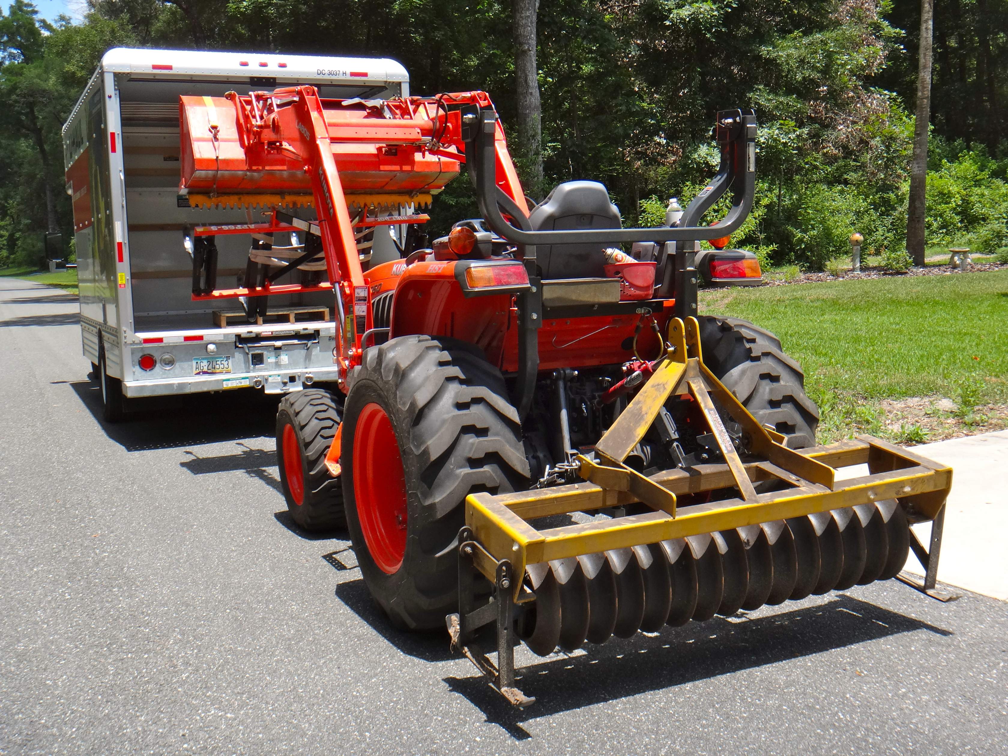

In lieu of a Boom Pole, consider installing 5/16" chain grab hooks on your FEL bucket to lift ~~~whatever~~~with chains or nylon straps.
Unloading 300 pound Field Cultivator with 600 pound Cultipacker mounted on Three Point Hitch as ballast.
BEST QUALITY VENDER: Ken's Bolt on Grab Hooks <<Home>>

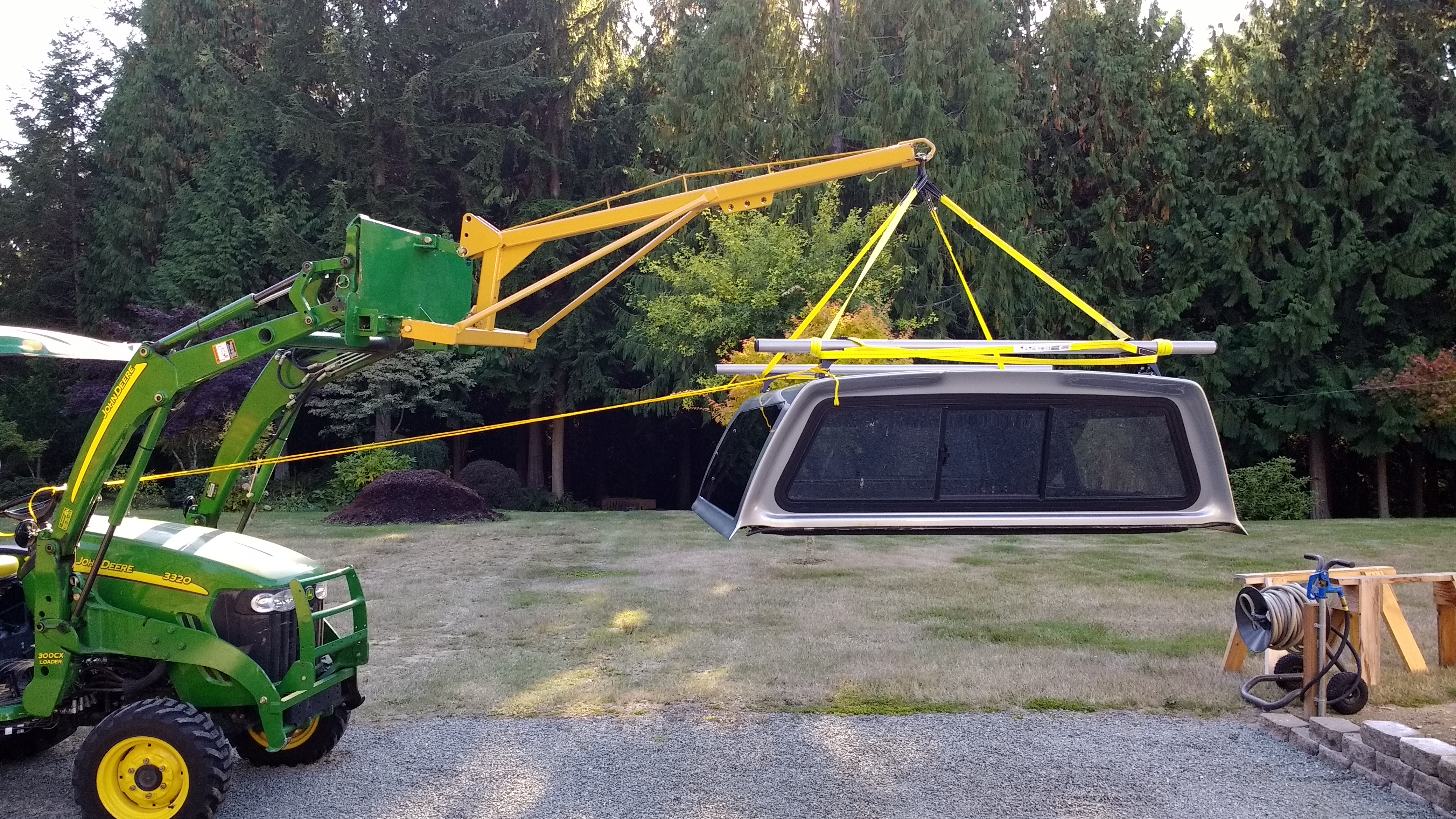

I wanted the longer reach so went with HD one, its well made and should be able to handle anything my compact tractor could lift. It is quick hitch compatible.
