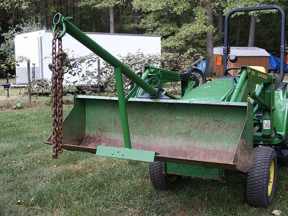

I made mine to go on the bucket. Kept it short so I could lift more weight.
M.D.

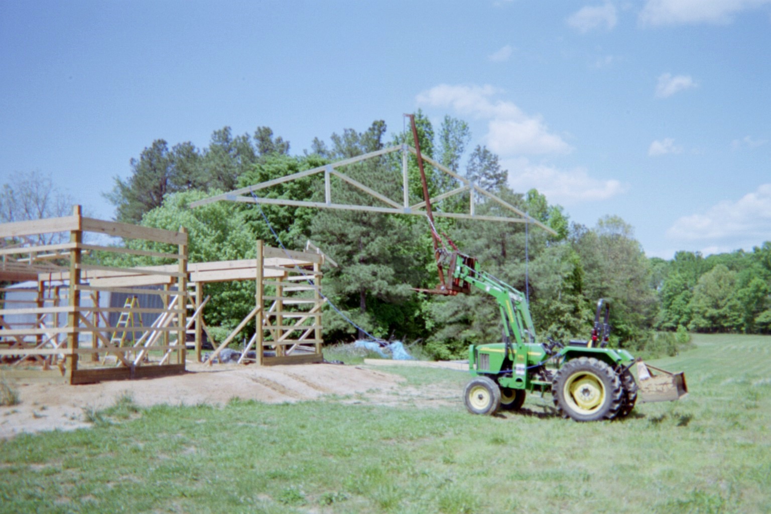

Size matters....
I needed help setting my trusses. My friend John wasn't busy...

Thanks to all that have replied.
With the picture of WR Long setup and porky's pic it makes we rethink my whole design. I really like the orientation of the pole in relation to the pallet fork frame. I would have never thought of that.
Also, judging from MrJimis past experience I better use the largest pipe I have. It doesn't appear that it will be overkill after all.
