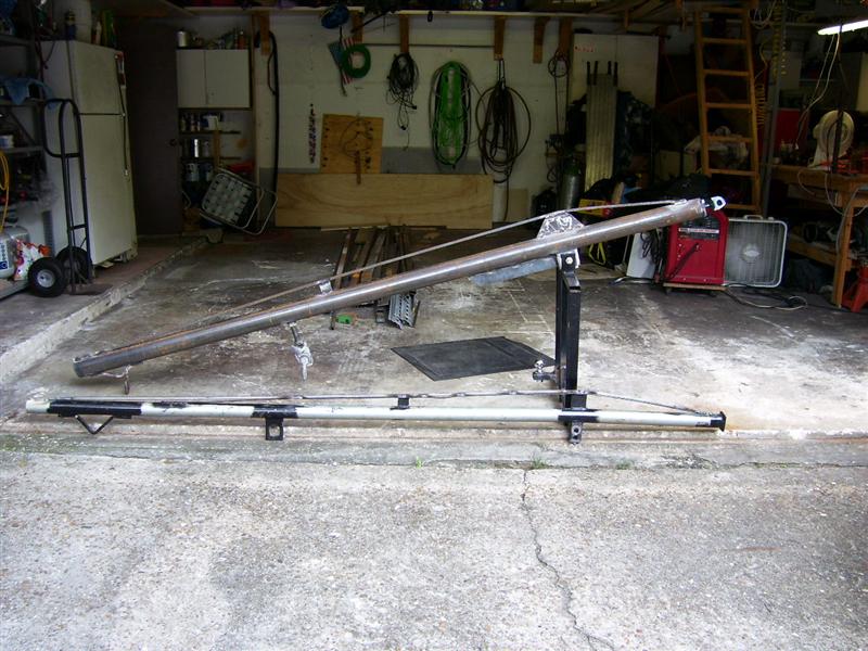

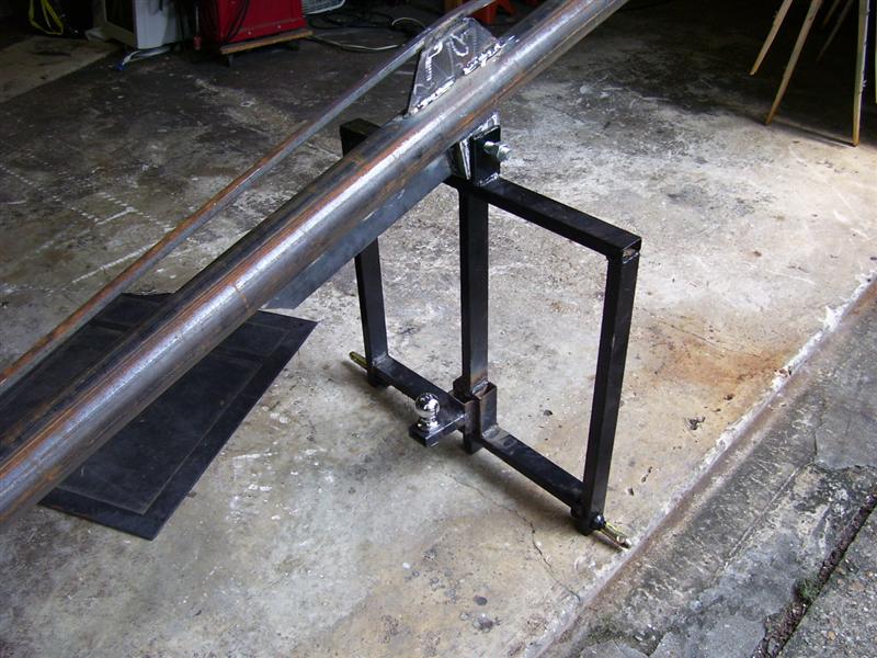

Ok so nothing else to do on a Saturday. Found some 3" pipe and went after it. Top strap is a little higher and thicker(1/2"x3/4"), more support, etc. What do yo uthink RonMar?
I don't want to upgrade to version 3.0. :) This one is getting heavier. You can also see where I modded the lift arm connection. So my arms should be able to go all the way to the ground. I just sort of hacked in the cut outs but had a little T left over and welded it on for a trailer hitch.

The boom looks great. You could save a bunch of weight and make a stronger lower frame. Triangles are stronger than rectangles. Your lower frame is basically two rectangles of rectangular box tube placed side by side. All the weight of the boom is being supported by the two horizontal tubes in shear(weakest mode) and they are on their sides which is their thinnest/weakest axis. With some weight on the boom, you can probably see the horizontal pieces bend. You could have a lighter and stronger structure by using 3 pieces of the same tube and make a triangle. One cross tube between the lift arms and two uprights connecting from the end of the cross tube to a point in the middle where the boom attaches. The weight from the boom would be sent down the two triangle uprights in compression(stronger mode than shear) and the spreading force applied at the end of these uprights would be contained by the crossbar in tension(strongest of the modes). Remember triangles are our friends:)

i thought the same exact thing.
something along these lines would have saved weight and been stronger overall.

Yep, great looking pole though!!! I think now the pole is probably three times as strong as the bracket. I think you'll get it the third time!!! Hahahahaha!!!

Yep, I certainly am. I really like the pole design with maybe the exception of the top link tractor end. I think I would maybe use a piece of healthy flatbar welded into the smashed end of the pole with a hole in the bar?? Any other ideas?? :)
   / Boom Pole V2.0 #7
ya take some flat plate (3/8 or better) cut a slot in the end of the pipe slip the 4x6" plate into the slot and weld it up.

Ron... Thought about using the triangle but this was just 2 darn easy. the 1x2 tubing is actually 12ga I think, It's not 16ga. In my other test lifts I didn't see any stress here. But I have more tubing and another free Saturday comming up so who knows. :)
schmism.. Same as Ron, actually I liked the KK (TSC) boom pole because it used a simple piece of angle for the cross piece with welded on links. If this one works out the double as a trailer hitch is a bonus..my current trailer mover is on sort of a utility 4x4x3/8" piece of tubing. I use the tubing to hold a middle buster, cultivators, subsoilers, etc. It much heavier. This is an upgrade.
