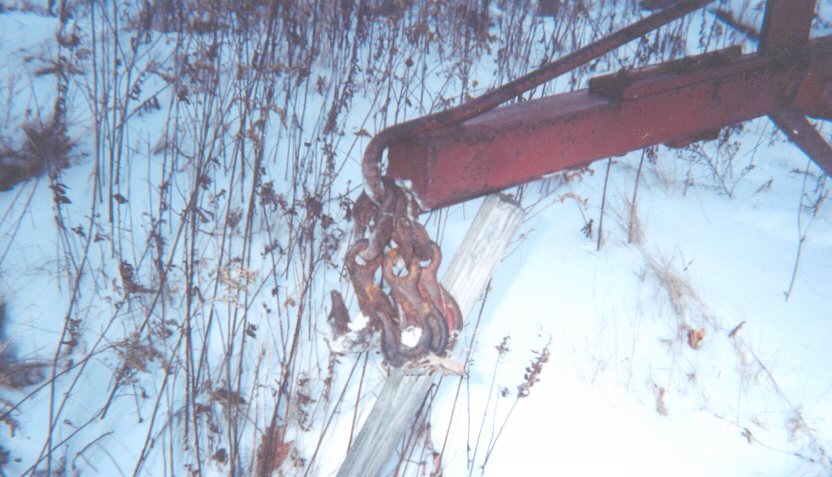

Mike, also think about adding an eye type grabhook onto the boompoles' endloop using a hammerlock connector. Makes for a quick and secure point to anchor the chain to.
DFB

DFB,
A hammerlock connector? Never heard or seen one. Is it two clevis' connected together with one pin?
Terry
   / Boom Pole #6
Comes apart like this.
In logging they use them to connect grab links to the log slides on the winchline.
DFB
