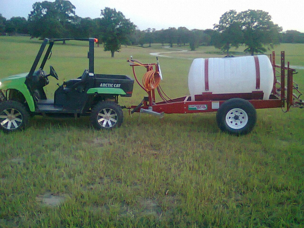

Dont think the pumps are that much if need re-placed anyways if you get it for a good price. I like my boom sprayer,I just feel like im getting a more even spray than using the boomless type one nozzle. Mine is a 350gal.-21ft boom prowler00.JPG Im sure you know this just make sure you clean it out good and run some antifreeze threw it before you store for winter.I also pull my nozzles and filters out when I store it in barn before winter,just some suggestions:D
