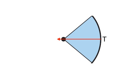

Remember that a cable or rope doesn't determine where the tree will fall, only where it won't fall.
I don't like trees tied to vehicles. Many trees far outweigh the vehicle and a wrong direction fall can throw the vehicle around.
"T" being the tree and the red line being the cable, the tree may fall anywhere in the blue sector.
Bruce
If you want to have a better chance at determining where it will hit in that blue area, put something of value there.
