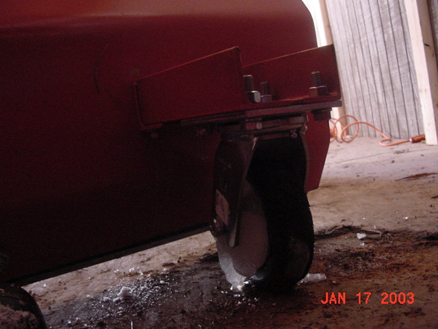

I've been using my 7500hst for almost a year now. To clear snow and light grading on my 400' drive I have used a 6' Kodiak blade. No, it's not the biggest, baddest blade on the block, but I've put it through a very tough winter with no problems. Price was right ($235), and I added wheels so not to washboard my drive.

Cchoate,
The idea of a rear blade on wheels for snow removal is marvelous. Can you post more pictures of the implement?. Is it something that can easily be removed?

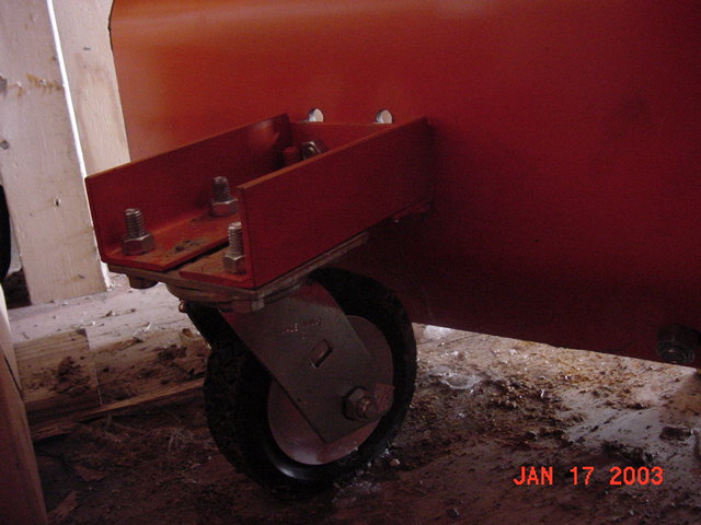

Here's another picture. I can remove/install them with 2 bolts each. For my useage, they work better than shoes and they swivel so you can go forward or backward.
